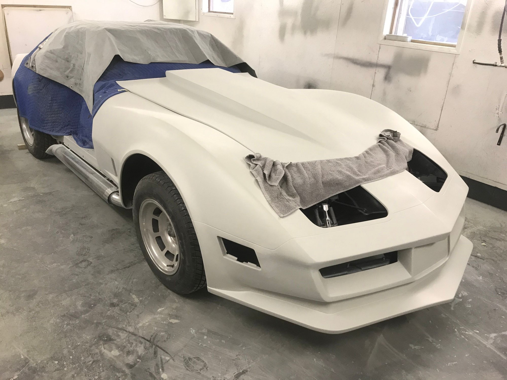

will these wheels fit
Old Apr 11, 2021 | 12:19 PM
trans am kev's Avatar
trans am kev
Joined: Mar 2020
Posts: 334
Likes: 113
Default will these wheels fit
my 82 c3 rear tires 275/60/15 fronr 255/60/15 . http://antiquetyresonline.com.au/ame...5x8-grey-chev/

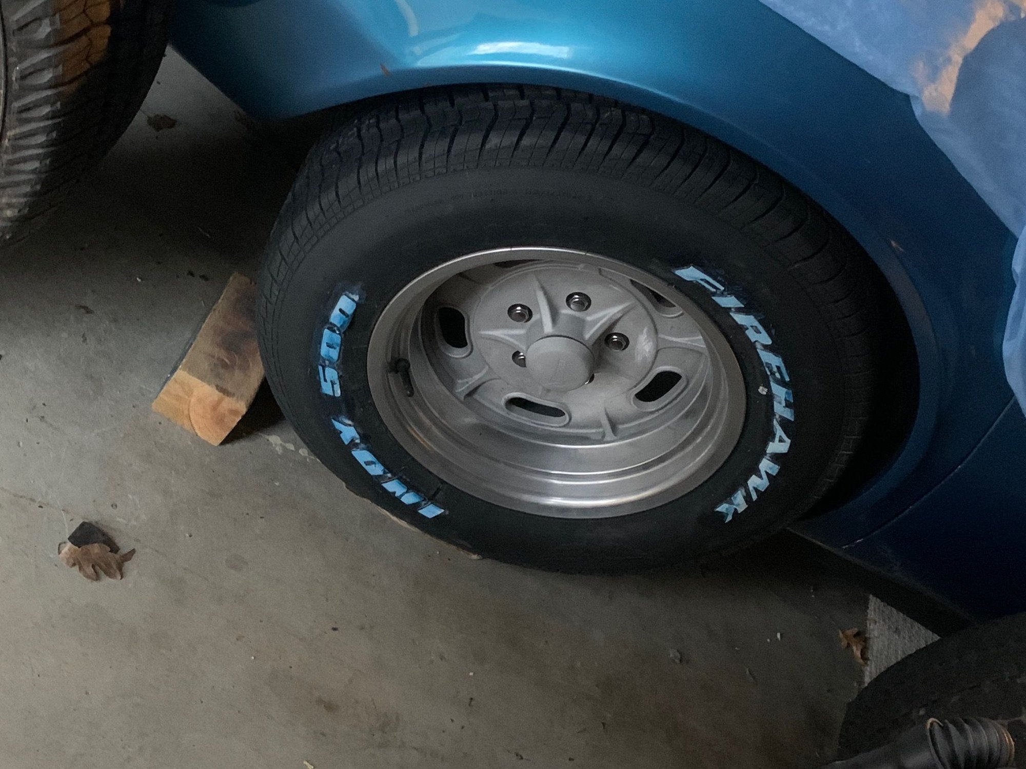

thanks i want the 15x8 would you know the specs i need .have these at the moment

[QUOTE=trans am kev;1603287935]thanks i want the 15x8 would you know the specs i need .have these at the moment
/QUOTE]
15x8 w/4" backspace,,
You will need to measure the center hub hole to see what you have, , I don't remember exactly what is needed for the 1980's
Old Apr 11, 2021 | 03:38 PM
Corey_68's Avatar
Corey_68
Joined: Feb 1999
Posts: 34,451
Likes: 665
From: Republic of Texas
They will fit although they will be tucked in 0.5in from stock. As you probably have found, few wheel manufactures now make a 8 inch wide wheel w/ 4in backspacing and 4.5 is the default. Many here are running 8inch wide w/ 4.5BS without issue. Now to get the correct BS you'll have to go custom.
255's up front will probably rub at full lock and 275's on the rear might be tight but just fit, they WILL fit at 4in BS
They will only rub at full lock which only happens when parking the car in a tight space. I wouldn't worry about that. You could also buy 1/2" wheel spacers and 1/2" longer wheel studs to correct the 4-1/2" bs to 4".
