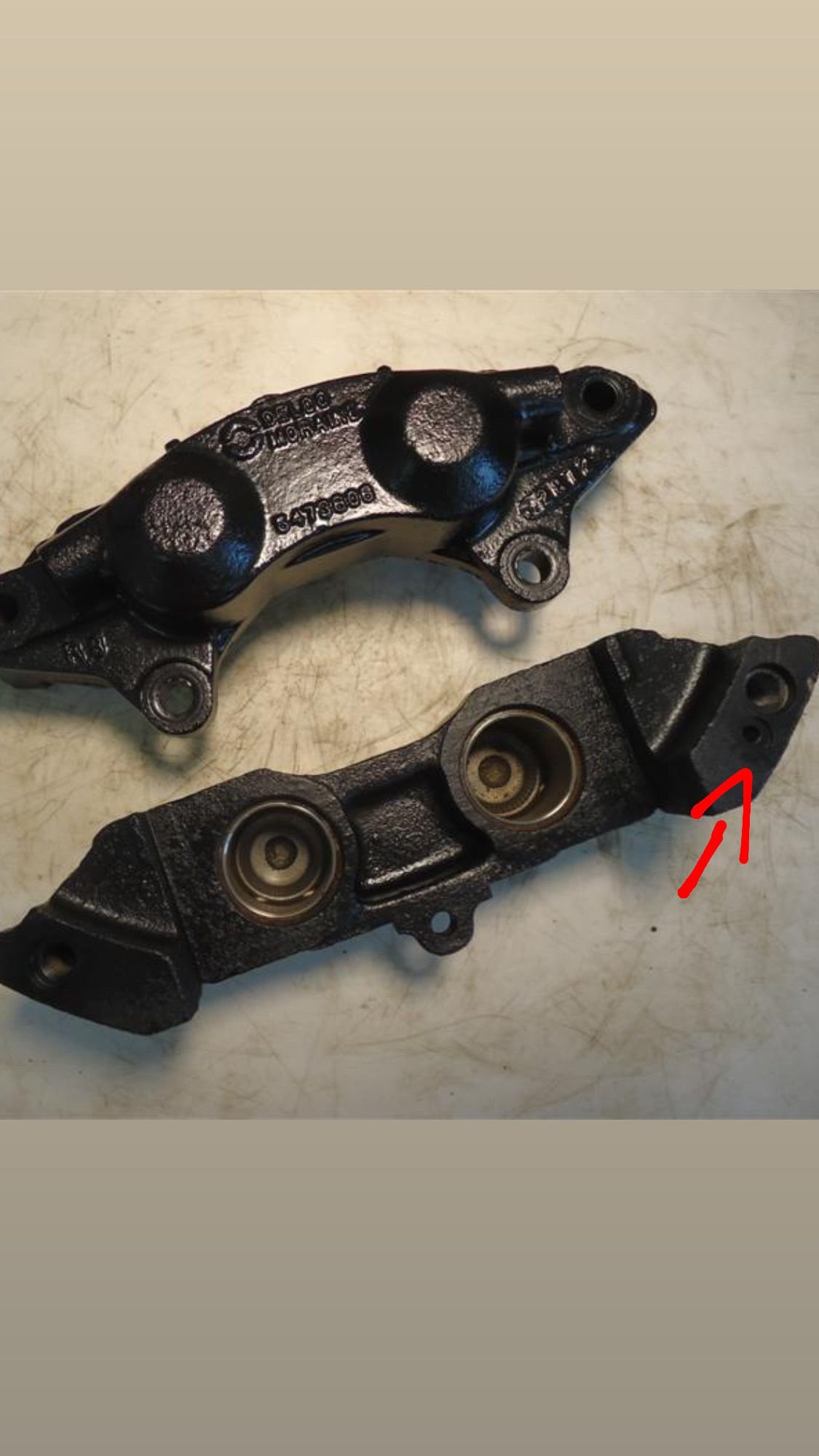

I’ve installed 4 new break calipers, a new break booster and a new master cylinder (master cylinder is bled) my break lines are good and my pads are good also.. Today I was confident that I would get the car to make good stops but unfortunately no. That was not the case. I’ve installed all calipers and break lines tight, but when I try and bleed them, they leak from the middle of the caliper.
No matter how tight the calipers are screwed together it always leaks from one of the calipers. My uncle told me there is little rubber gaskets that come with the calipers.
This is what appears apparently keeps them from leaking and gushing break fluid. These are not secured in any way when I get a new break caliper, they fall out easy and are very hard to find but regardless I didn’t know I needed them and orileys and autozone do not sell them or know anything about these. Please can someone help.
This is where the tiny stupid rubber gaskets go..

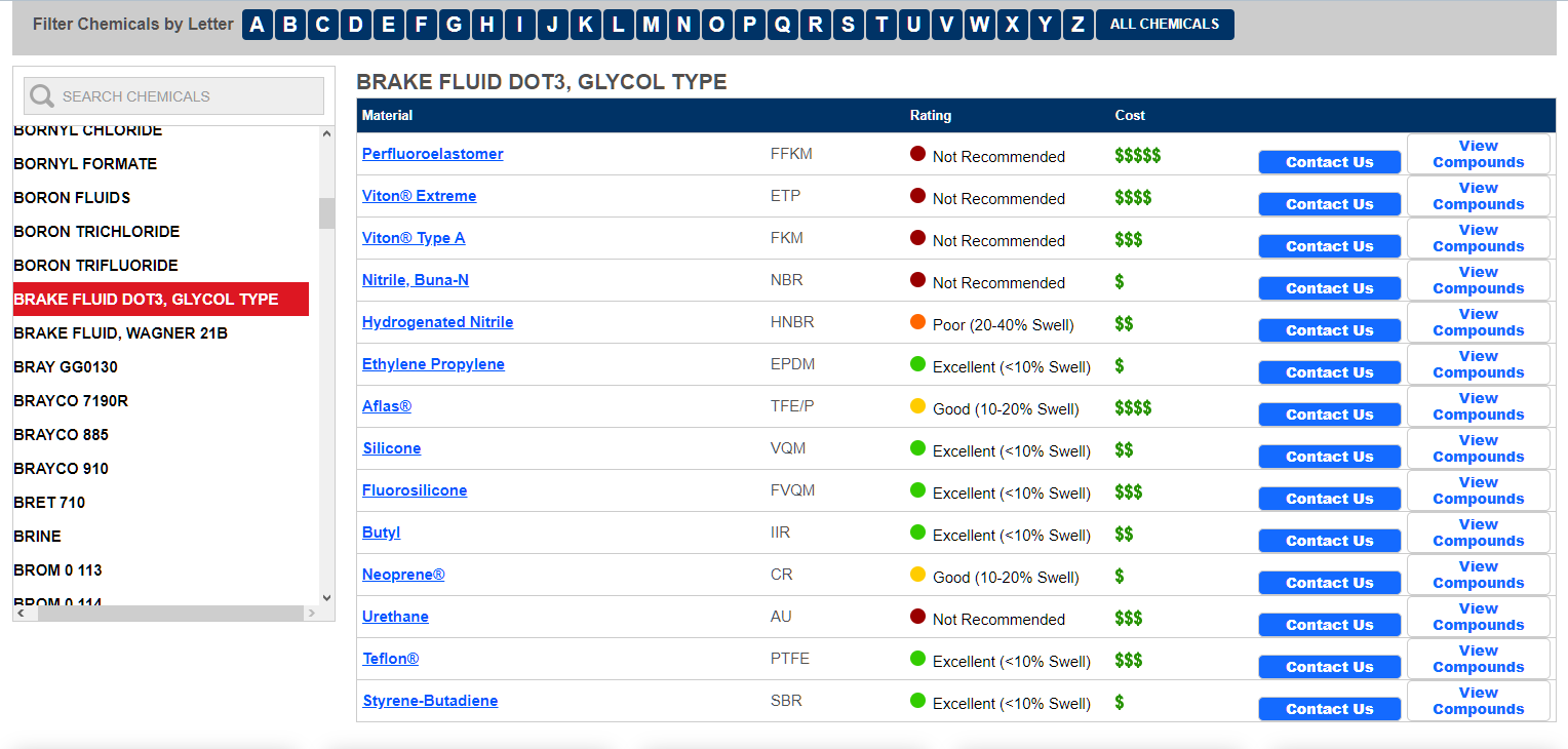

How many leak? If it's only one it's probably easier to buy a single caliper repair and use the fluid passage o-ring in the kit.
Here is some info.... https://www.mtbr.com/threads/dot-flu...-rings.813710/
And here is where you can select dot-3 as the fluid so you can pick your oring material: https://www.marcorubber.com/o-ring-c...ll=&chemId=304
And I thought I'd paste the image in case the links die.....but double check me....in case I copied and pasted an/in error.

There should be O rings there not flat washers

These are DELCO rebuild kits
Those rubber o-rings do not 'fall out easy' unless you disassembled the new calipers? The calipers do not need to be taken apart for installation, only if you are rebuilding them yourself.
You know what.. I just realized that... I didn’t need to take them apart all this time I could’ve just slid them on THAT EXPLAINS WHY THE BOLTS ARE SO DAMN TIGHT ON THEM!
