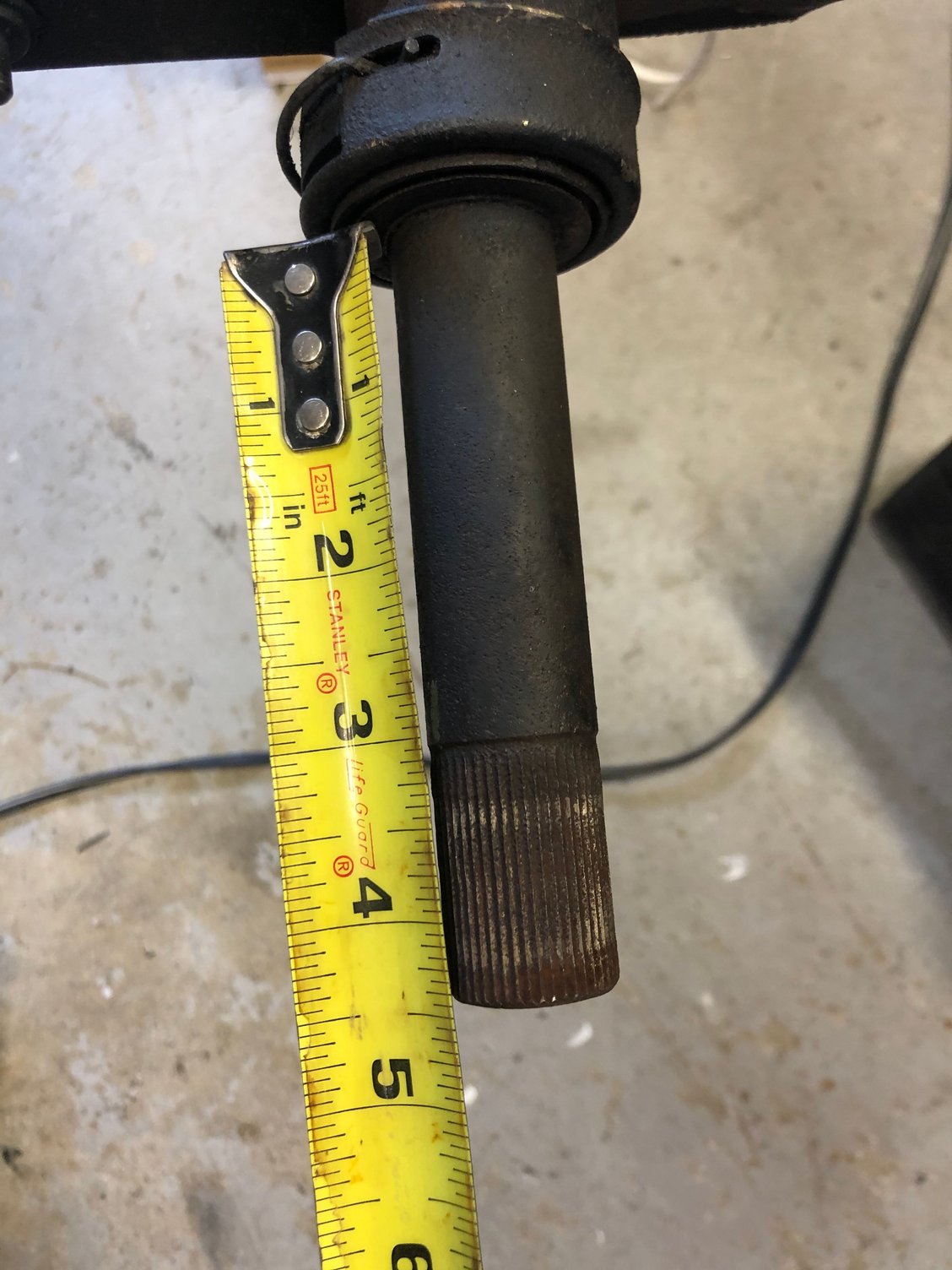

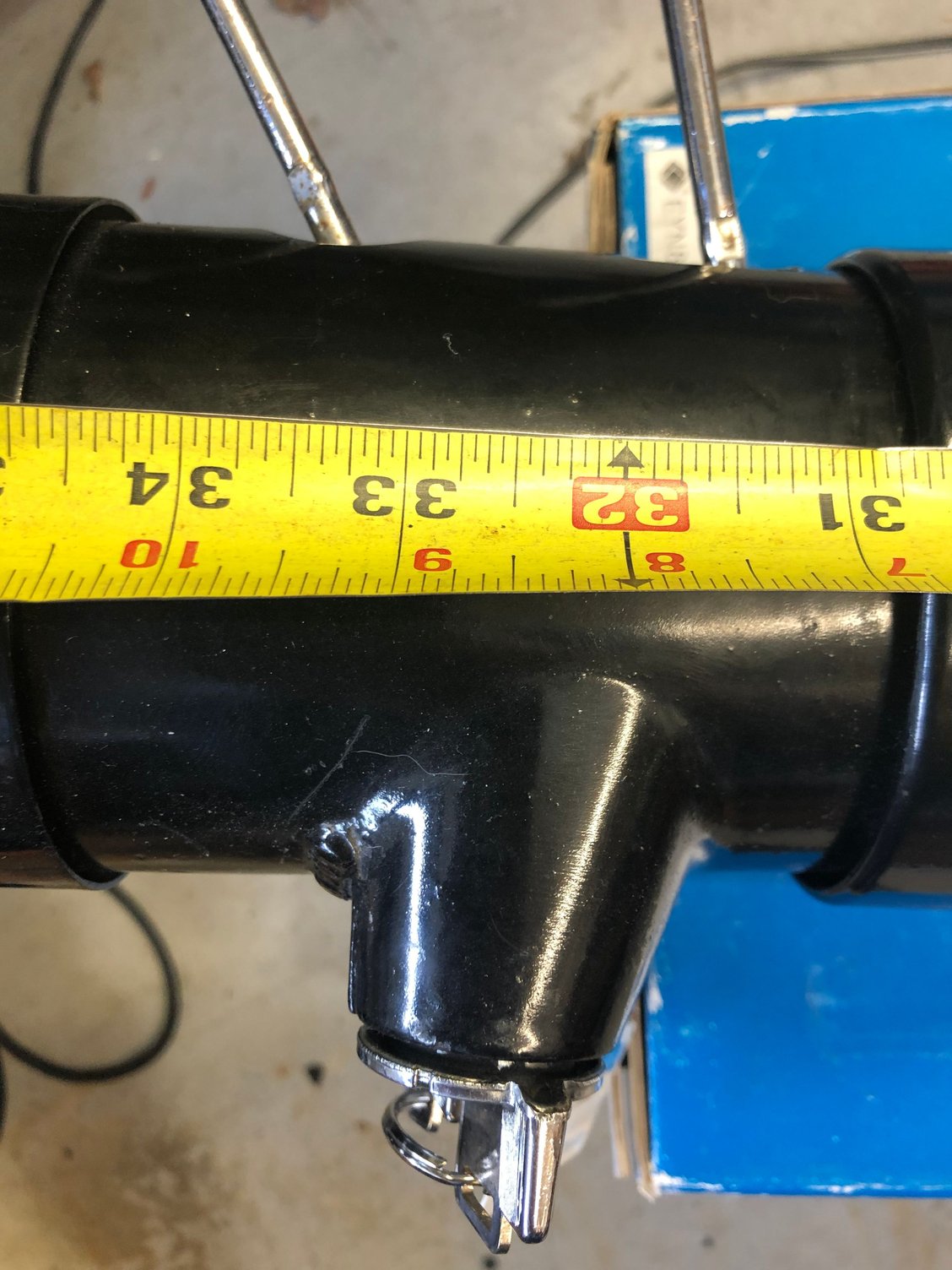

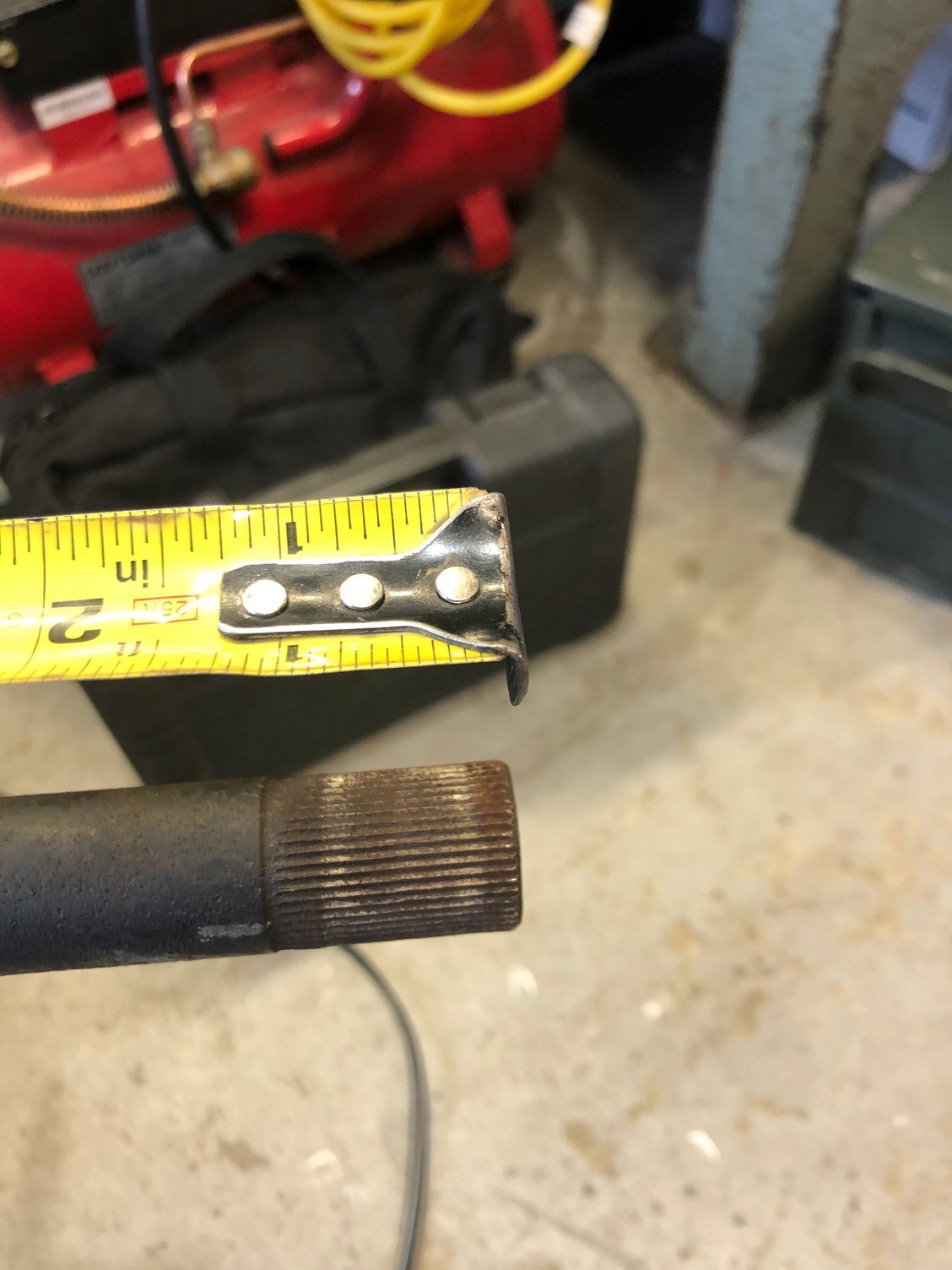

I could use a little advice. I replaced the left lower dash pad and fixed a number of wiring problems. No problem at all getting the column out. It's been sitting safely in a spot where it's fully supported and nobody's been near it. I marked the rag joint and shaft before I took it out. It showed 1/4" of spline showing past the rag joint, toward the firewall. Getting it back it has been a p.i.t.a. I got it back in the joint OK. I can get the two bolts for the flange under the dash in but the flange and the bracket it bolts to are separated by a good half inch.There has to be something obstructing it but I sure can't see it. I'll find it.
Haven't let the column hang or droop and have been gentle with it but I bet I compressed it some anyway. Read this thread: https://www.corvetteforum.com/forums...-jim-shea.html
I am hoping someone with experience can take a look at these pics and tell me if I need to pull it out about 1/4" and if so, what would be the best method with it out of the car?
Thanks
This is the overall length

You need to measure it as the J.S linked thread . Put the end of the tape on the lower edge of the lower bearing cap and then go to the top edge of the lock cylinder HOUSING , not the lock cylinder actual position.

Actually you can measure at the split where the upper and lower jacket pieces meet to the mounting plate. The jacket, main shaft, and backdrive shafts are all collapsible. The shaft projection is ok, usually 4 1/2 to 4 3/4 inches.

Thanks. It's a bit over 4.5". The JS docs say 4.7. It is collapsed about a quarter inch from what I can tell. Been trying to pull it out not hammer it and my reward is a gritty feel now when I spin the wheel. I'd need to go through the entire thing to feel comfortable and things like that take me forever. It doesn't look that bad or that expensive But ......

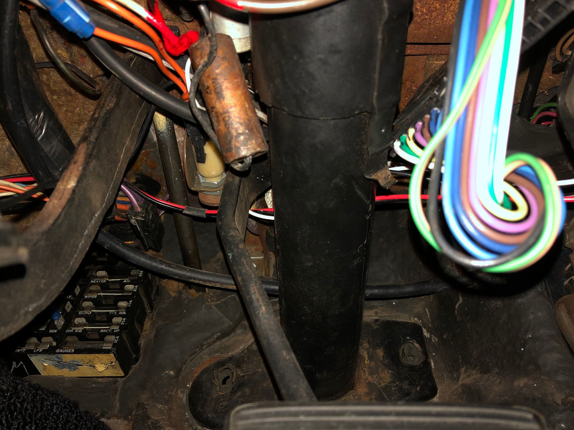

I would loosen the steering column lower support so you can wiggle it around a little. One time I had the same problem you are having and the lower support was bumping into the tach bezel just enough to not let me push the column all the in. I always loosen the 4 support bolts now when I remove the column.👍

I did drop the whole thing off at Columns Galore in Brewster, NY yesterday. If this were Fall I'd be researching and rebuilding myself. I had hoped to just put it back in and deal with it over another winter but nope. The replacement CA dash is likely the problem - not exactly a drop in fit. Close, but off enough to cause this problem. I'm going to pop it out from under the upper dash pad and put the column back in. Before I do that I'll carefully compare it to the one I removed. CG said a week, maybe two. They're close to me and seem well reviewed.
