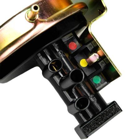

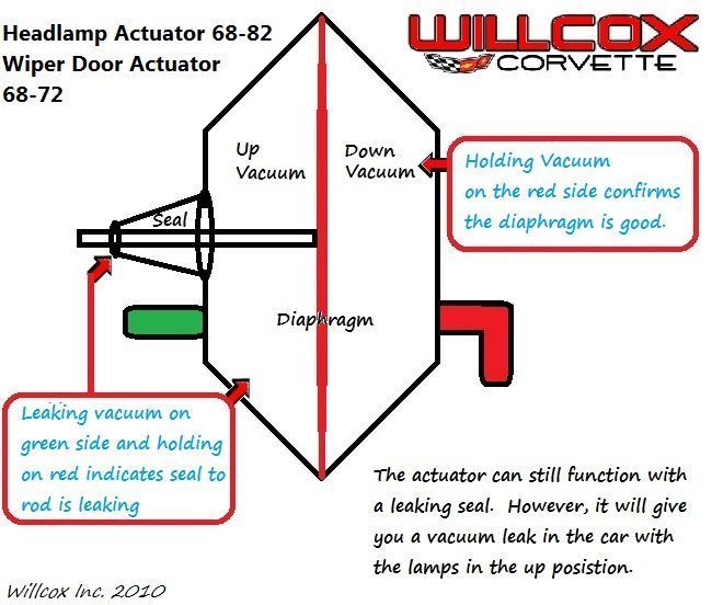

On a 68 they have only one headlight relay in the center of the nose between the horns. Most likely it had sprung a leak (very common) or the hose has come off the control vacuum on the top of the actuator relay(black hose) or up at the light switch or the over ride. The reason they open is the valve is spring loaded, and when you lose vacuum on the valve, it is forced down by spring pressure to the open fail safe position. You can make the headlights go down by switching the blue and red hoses that go to the headlight actuators them selves. But you will need a new actuator if its leaking or find the leak in the hoses. If you have a stethoscope or a length of hose stuck in your ear, you can listen to the valve and if you hear air moving at he bottom of the valve with the motor running, it is bad. Hopefully its not the headlight switch. Its a pain in the *** ( and back) to replace as you have to loosen the dash and climb underneath to replace it or pull the dash off, (not recommended as the wiring harness is a hassle to deal with.)
on the headlight Actuator relay
  • the black hose #1 pulls vacuum to make the headlights go up
  • the yellow line is the vacuum that does the work up or down
  • swap the red and blue lines on the relay to get your headlights to close for a temporary fix so you can go out in the daylight only
  • the black hose is where your leak is, at the actuator or all the way up at the over ride or the headlight switch. Or the actuator relay itself. (If its the relay buy 2 because the wiper door relay is the same. Buy them from Willcox so you can make surre you get a quality part. The reproductions are generally poorly made and leak easily or dont last long.)
  • If you have a vacuum gauge plug it in at the actuator relay end of the hose with the light switch in the off position and you should have vacuum, if not its the headlight switch, over ride or hose connections between
ACTUATOR
ACTUATOR RELAY
