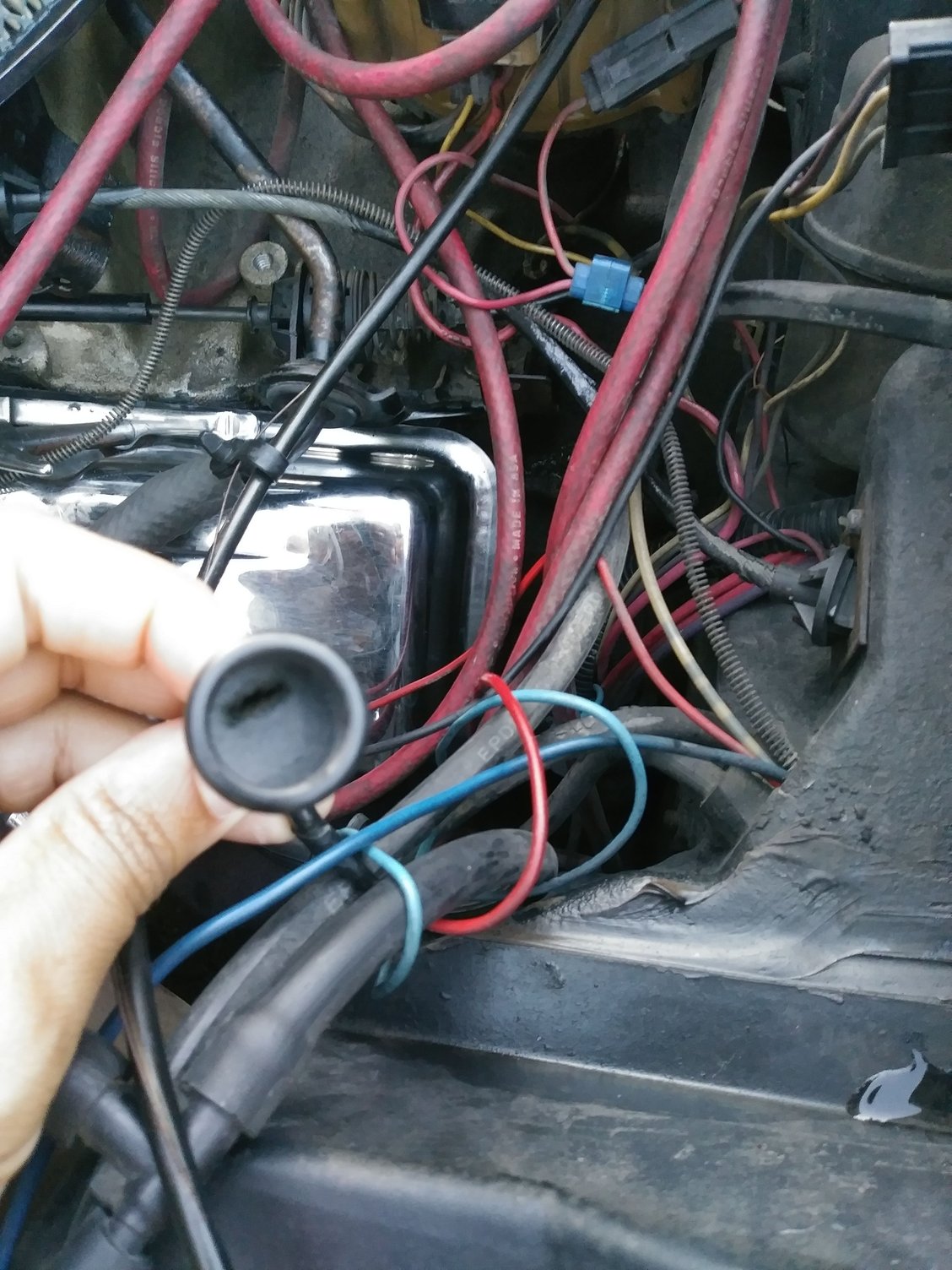

Hello, I need help identifying the 1978 proportioning valve location.

Should be under the master cylinder.

The brake pressure switch is located on the proportioning valve bolted to the frame under master cylinder.
You will see the hard lines from master to valve.

That isn't the Brake pressure switch connector your holding in your hand.

That connector looks more like the oil pressure sender connection, mounted just above the oil filter on the left side of the engine.

does your e brake illuminate? If so the wire going to the valve is attached. You are probably gonna have to look from under the car,
