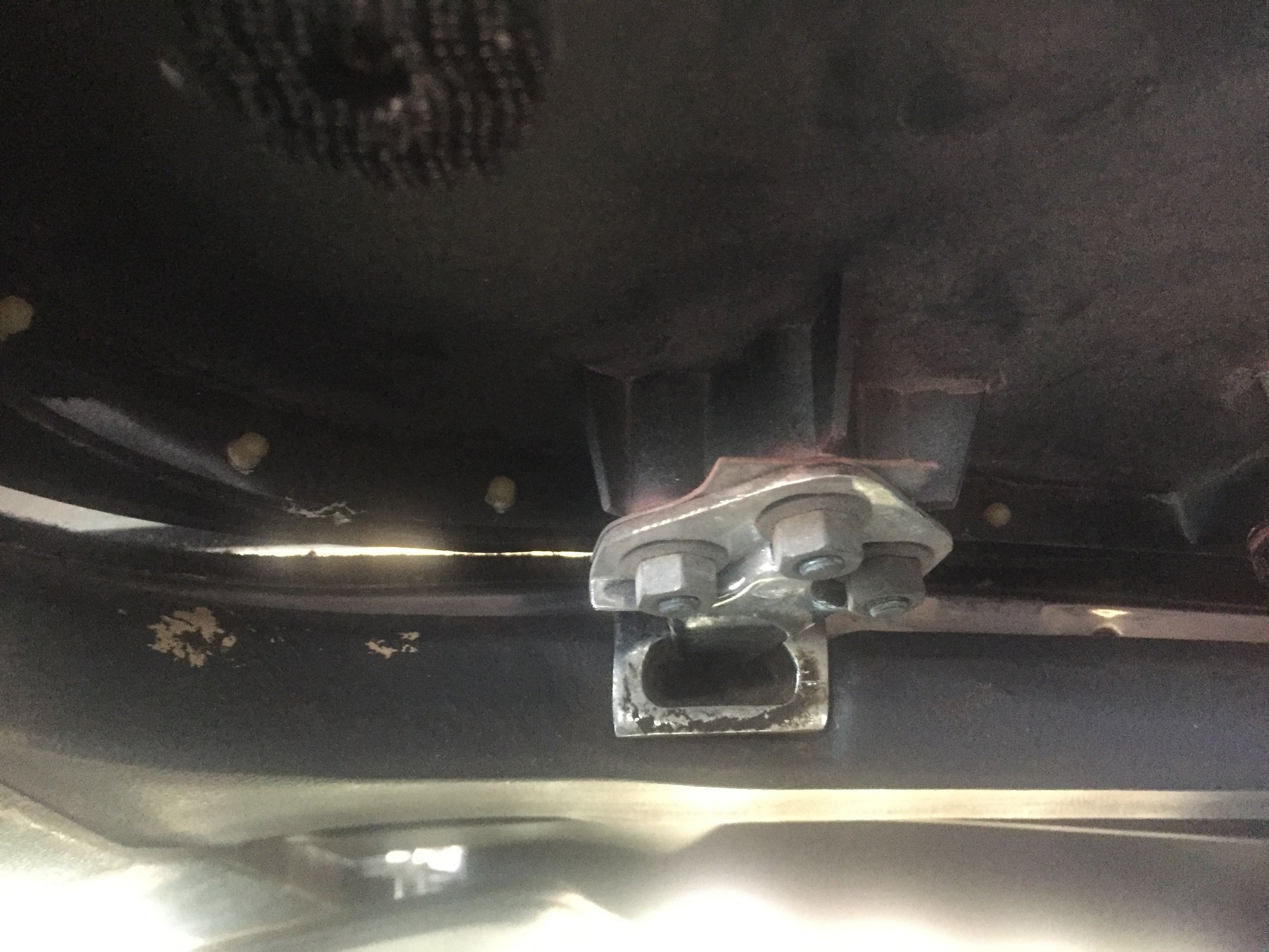

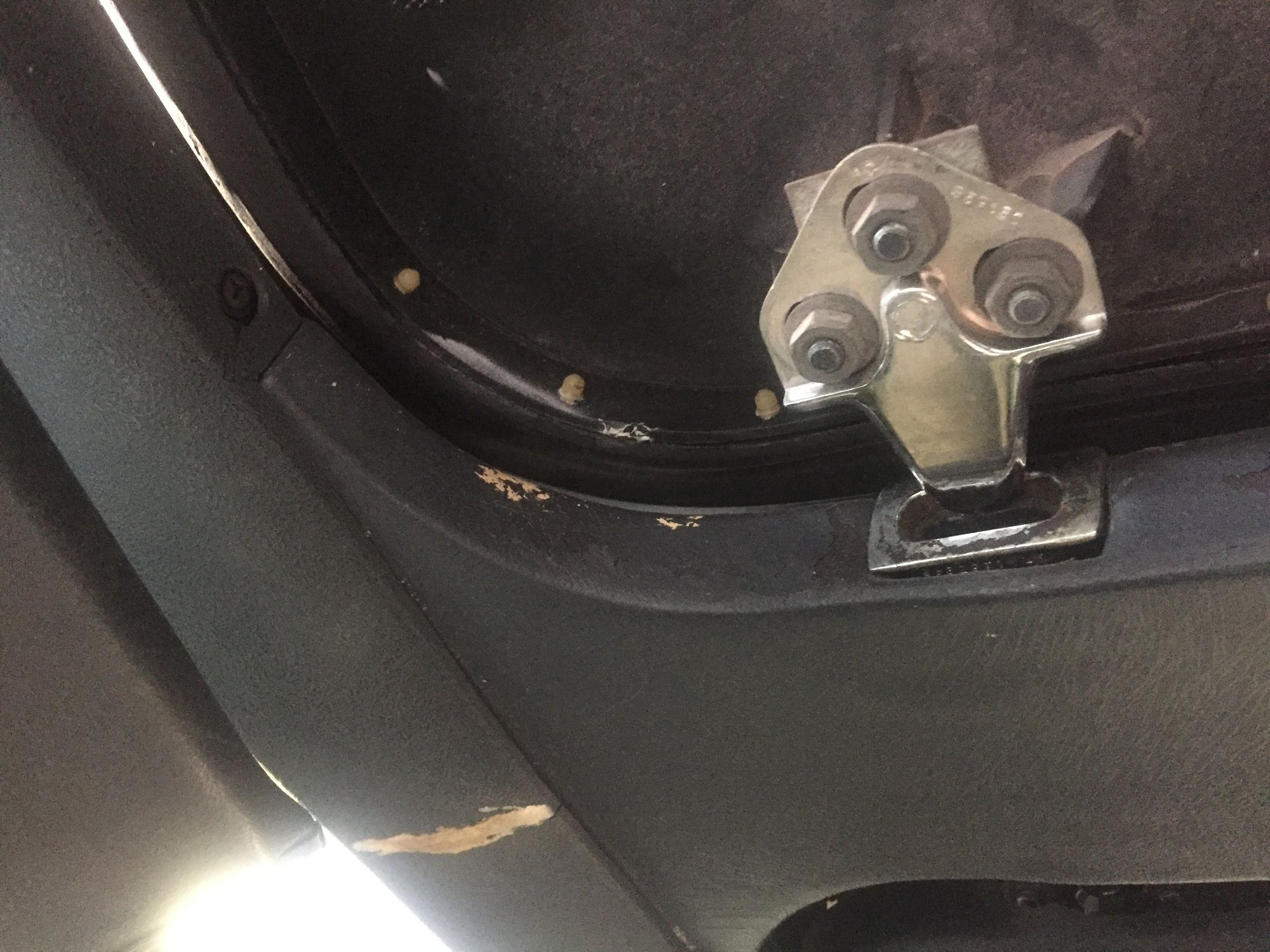

My '79 came with glass T-Tops which I don't like so traded for fiberglass tops from a '78 but they don't fit correctly. The tabs that slide into the center post are spaced too close to the top so they don't slide into the slots. Looks like there needs to be a spacer to move them down a 1/4 to 1/2 inch. I could fab up a spacer plate or maybe just use washers but the studs may not be long enough. Anyone know what's going on here? Are '78 tops not compatible with '79s? I can't compare them to my glass tops because the guy I traded with is about 500 miles away!

They do sell shims you could see haw many it takes and if you have sufficient threads left to secure the nuts.

You need the shim kit

PS: 78 and 79 tops should be interchangeable.

I removed the tabs and the tops fit perfectly. Don't want to try driving like that though as I'm afraid they might fly off.
Melrose was $5 a set cheaper so just ordered from them. Thanks!
