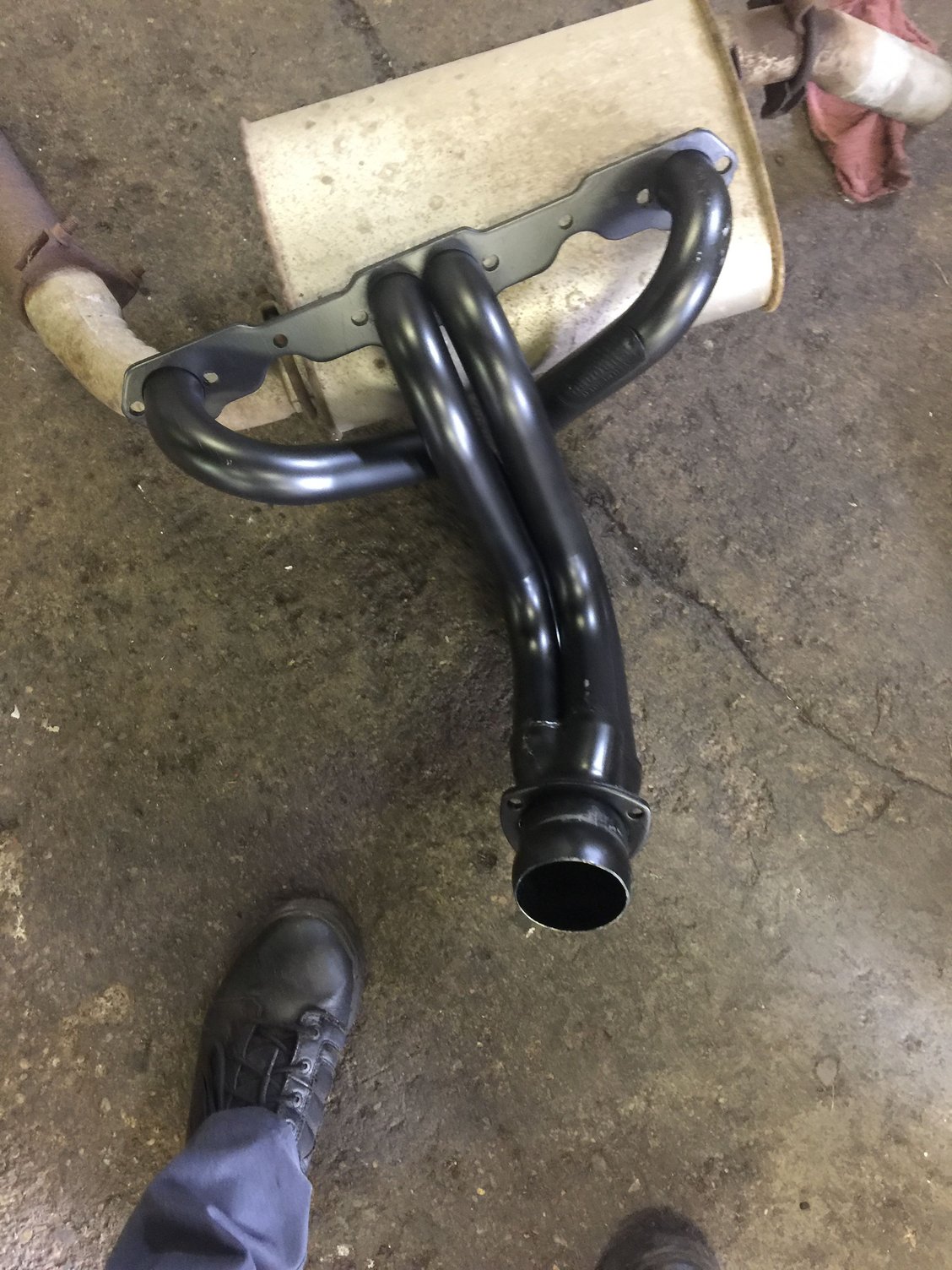

Hedman headers have the Ball collector, they have quite a few choices too , pictured are my side exhaust Hedman headers for side pipes 69 style and I have rear exit Hedman coming for full exhaust out the back
ing
