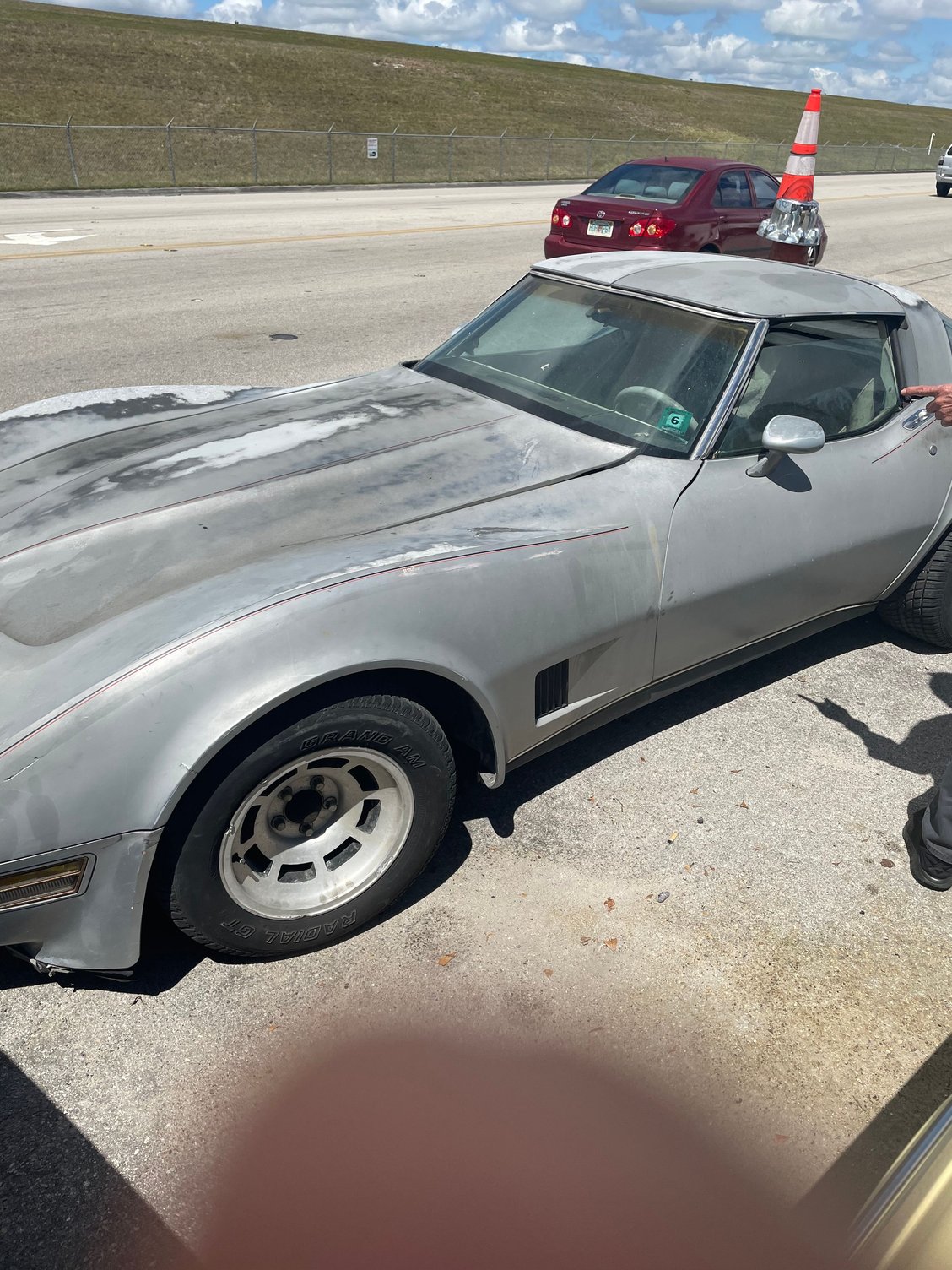

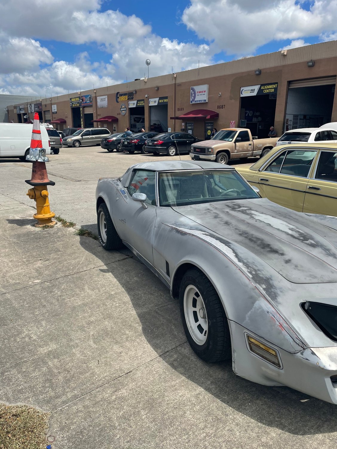

I want to keep it stock for now with the rear mufflers. Pics on the way ! Be aware the vehicle needs work interior and paint.
