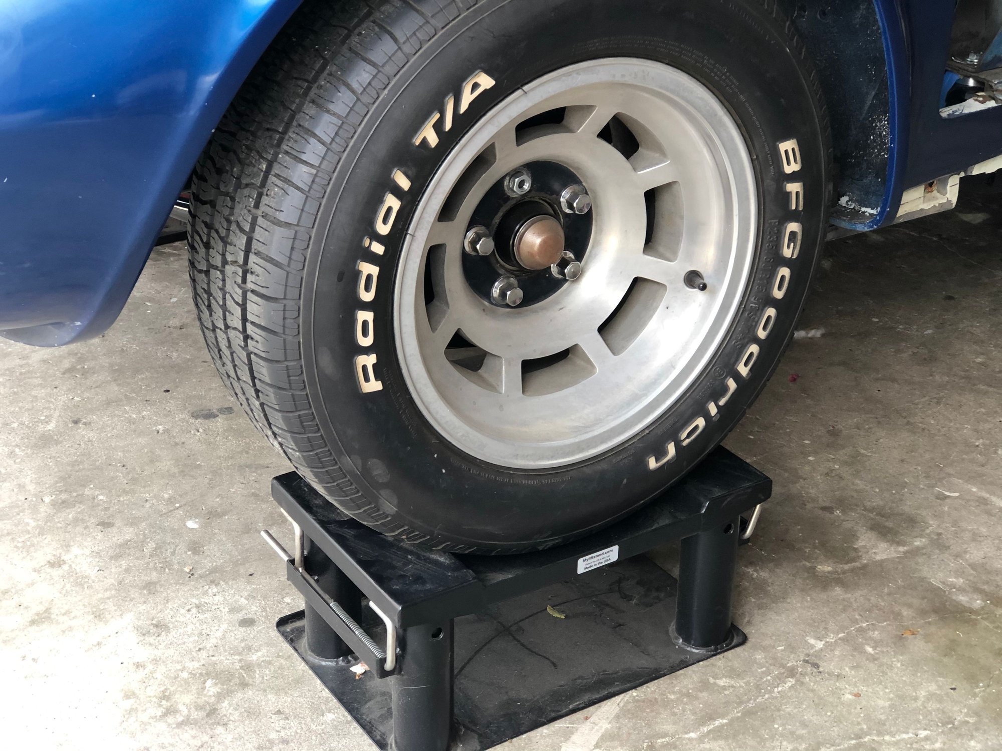

Originally Posted by caskiguy
This. Or you can purchase this kind of stand which allowed me to do a lot under the car.
I use something very similar to that, costs about $1 (with a scrap of 2x10 on top)

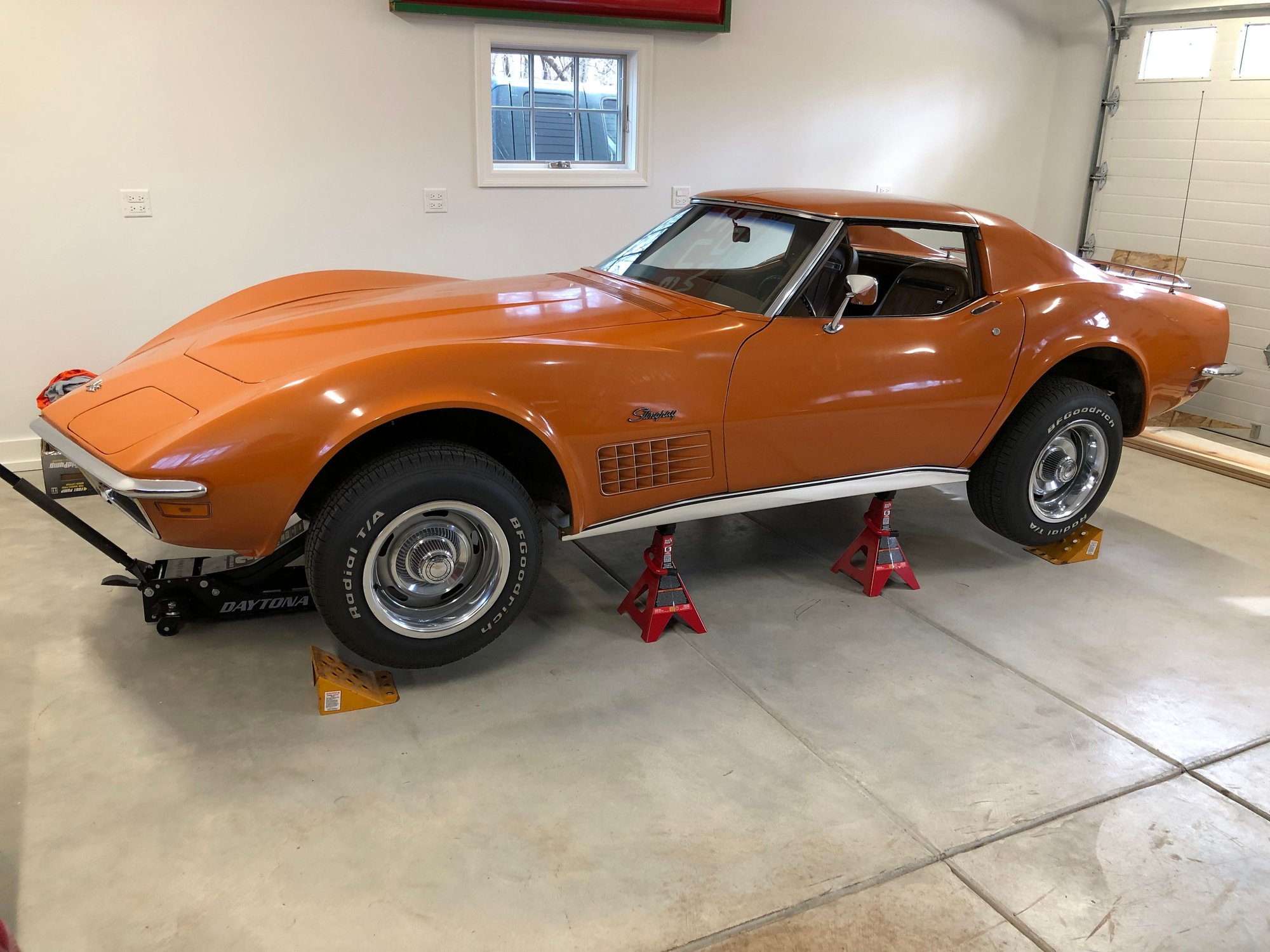

It was a little nerve-racking but I got it up on all four stands. Plus the floor jack and piece of wood under the front frame cross-member.
1972 Coupe up on jack stands.

I wouldn't use a concrete block.....One good whack with a hammer and that block could end up a pile of small piece and the car supported on your head.
Fyi, Harbor freight has 6 ton jacks (taller) you can put on the rear pick up rails (on either side of the fuel tank) as another safety measure, not to hold weight.
Do not under any circumstances use cement blocks.
Be smart and be safe.
