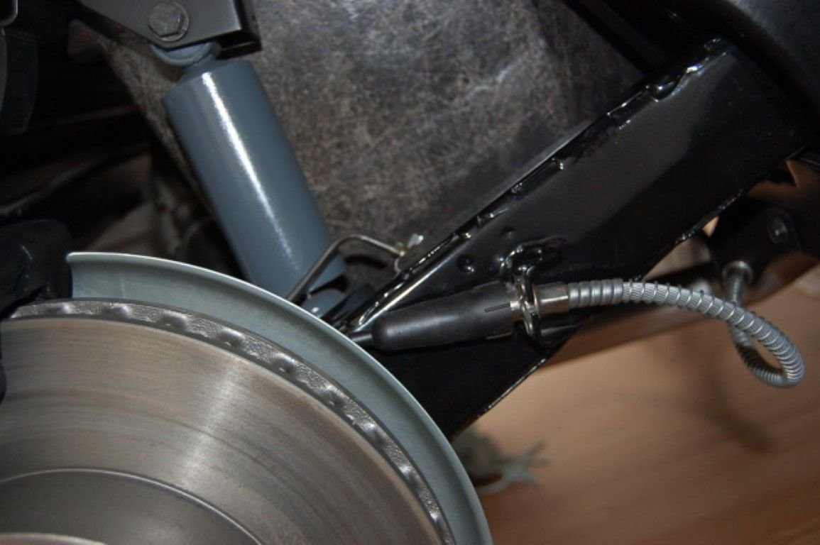

I think most members relocate them on top of each trailing arm. Be sure to completely assemble the trailing arm AND the Parking Brake cable assembly. The bracket has to be in the "sweet spot" when you weld it in place. If it is too close to the shoe assembly the cable HOUSING won't fit/clip into the bracket.
Is the pic below (Alan's Pic) showing the bracket you are concerned about?
Maybe I can take a pic of my '68 T A bracket I recently repositioned (apparently I deleted the original )

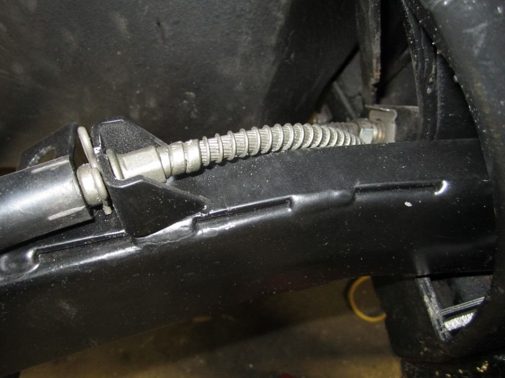

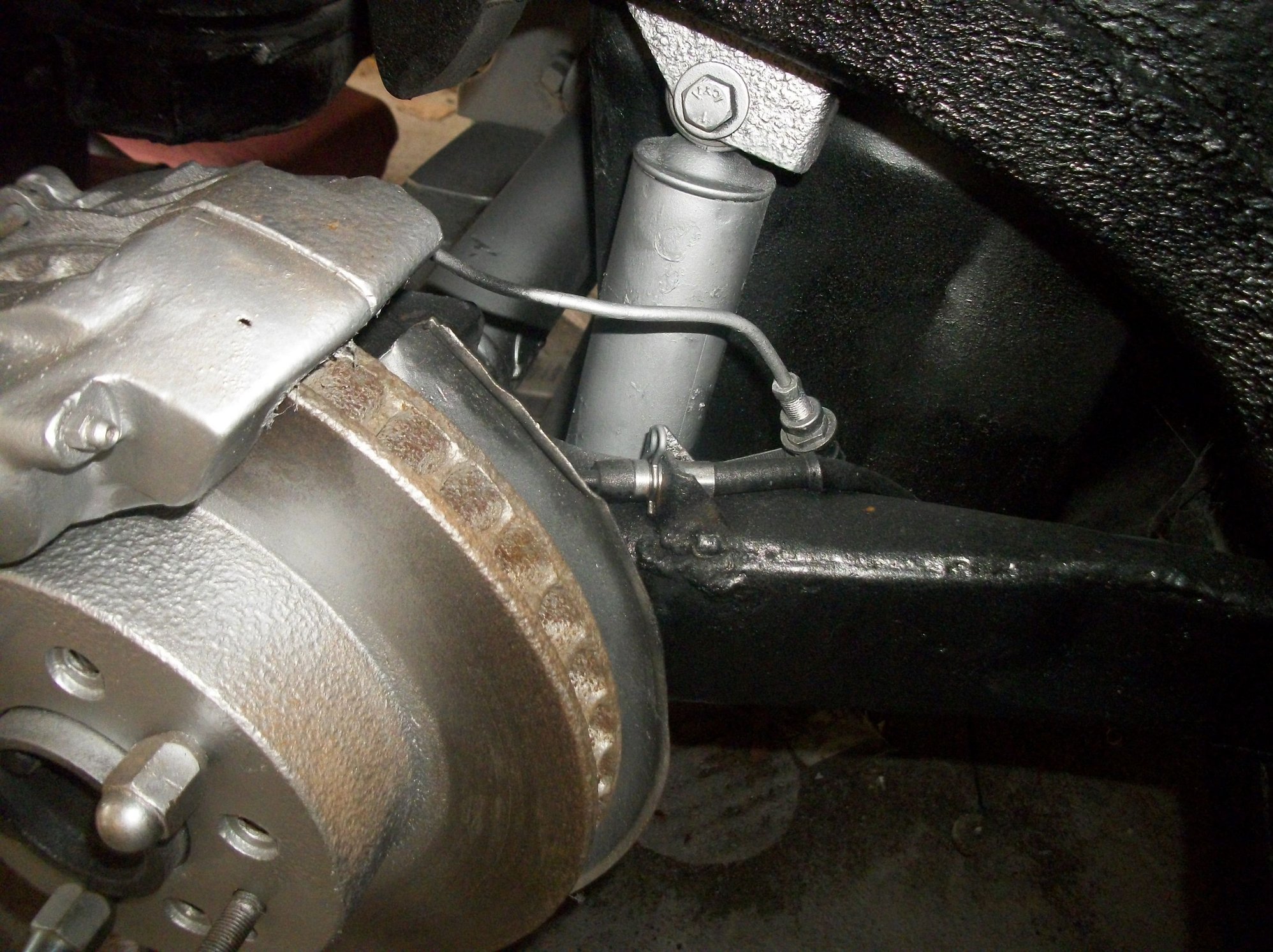

Passenger-side T A bracket relocated to top of T A.
looking toward rear of T A (Rats...I didn't install a lock washer or torque the caliper bolts down yet!)

Thanks Doorgunner. That’s exactly what I’m after

Disconnect the center cable from the crossover, leave the end of the cable attached to the brake and bring the mounting ear around onto the top and put it where it want's to be without it it pulling the brake at all and tack it in place
