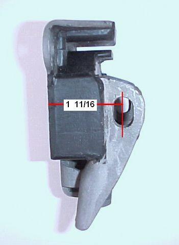

Remove the bolt and nut here (from this hole) and the engine can now be removed.
