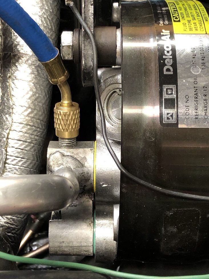

What is the torque value for the hose assembly that connects to the AC compressor in a 1982 C3. It is a single bolt that crushes the two black o rings.

assuming like a 79.. 25 foot pounds...you will strip it if too much..
i assume you have r4 compressor and not o rings but steel seals..
