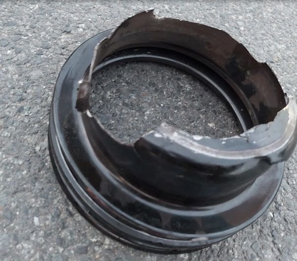

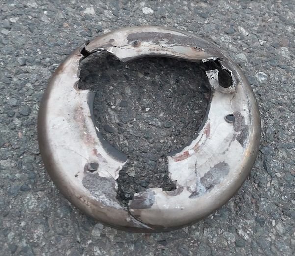

Avoid China repro pulleys.

HOLY ****!!!!
