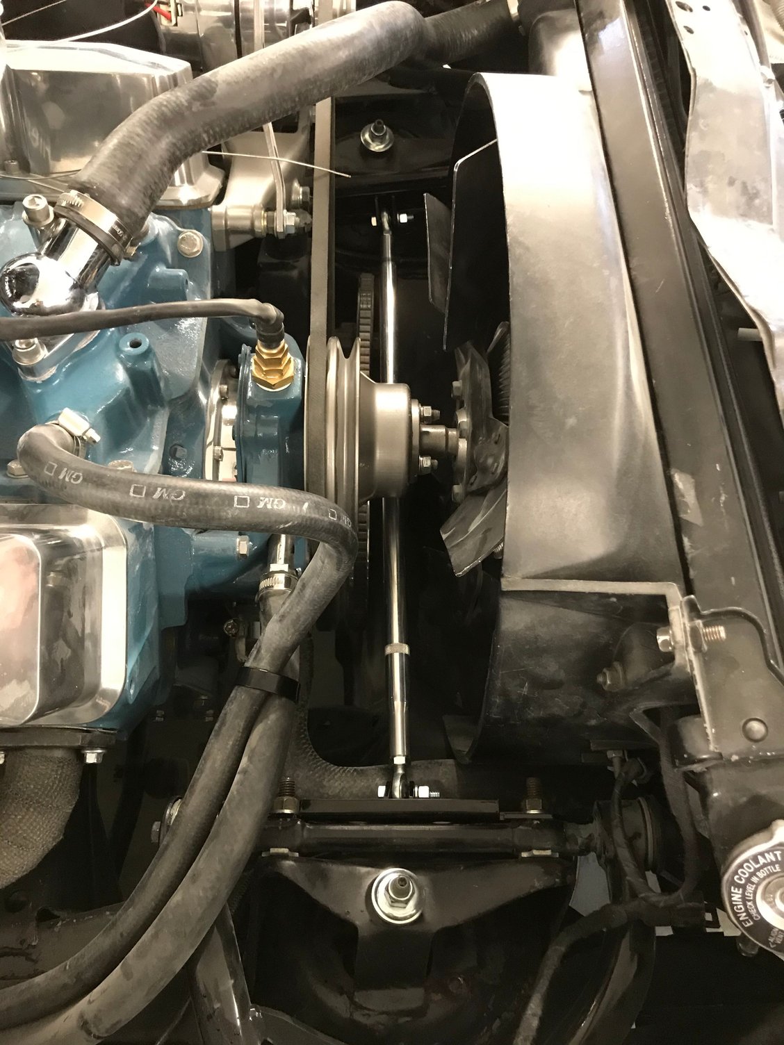

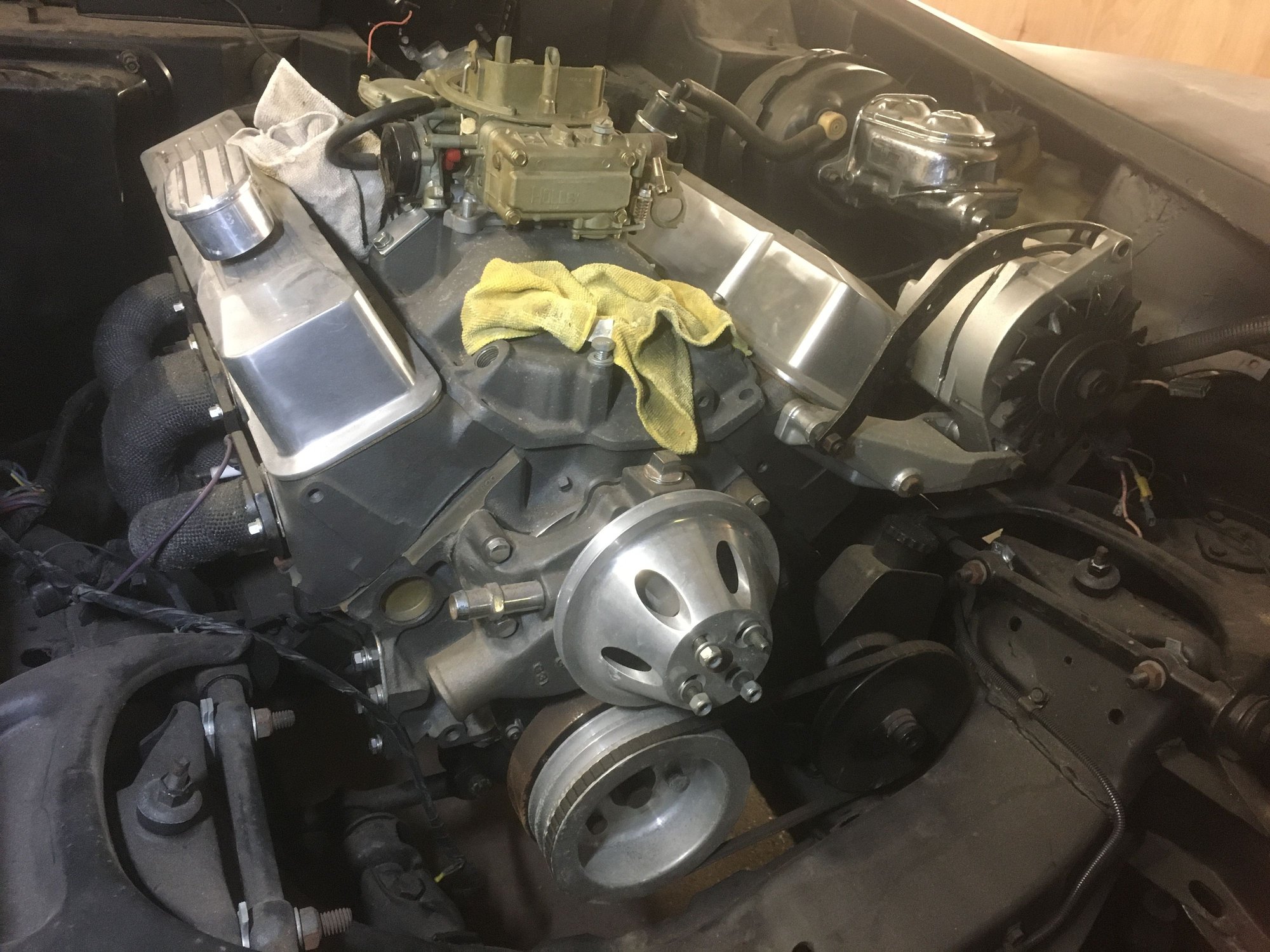

i am looking to fit a new pulley kit bit dont know what i need . i think its a short water pump as it is 5" 3/4" also the center hole is 3/4" . the water pump pulley in the pic does not line up with crank pulley i have posted a pic maby some one can let me know what pulley kit i can use .

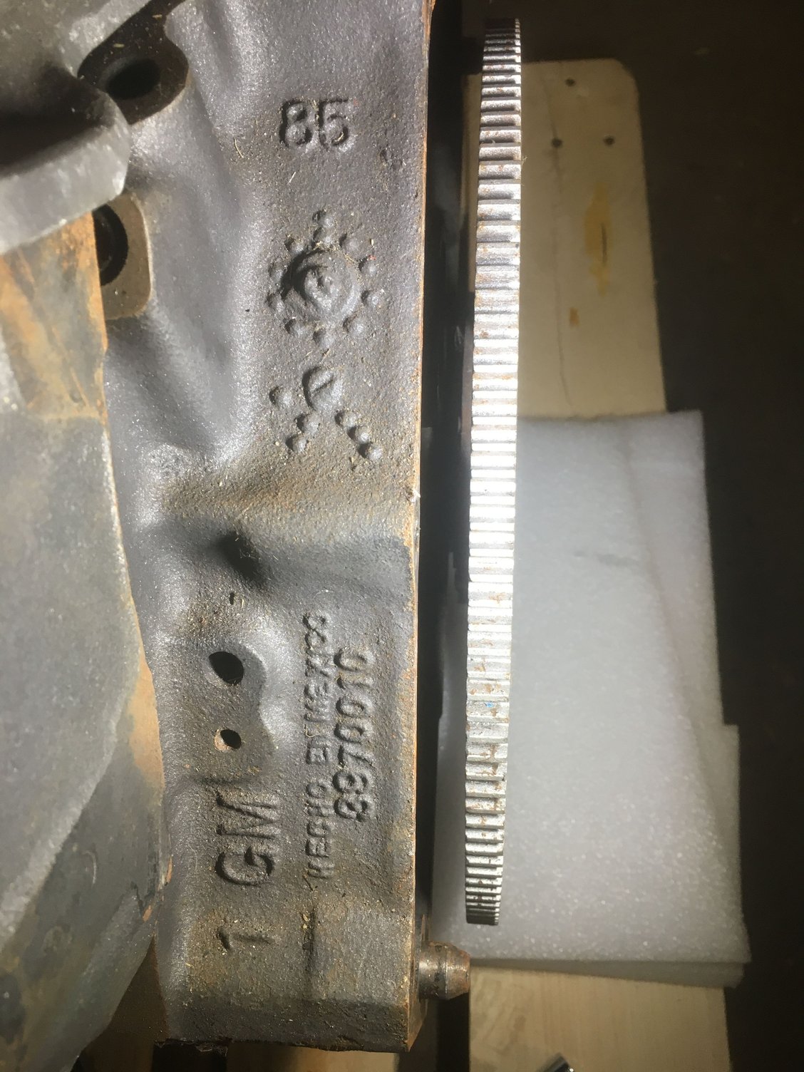

010 blocks were used in dozens of GM applications, including Corvette. Post the number from the pad at the front of the passenger's head.

thanks for the reply i have looked and there is no numbers stamped there its just blank

I would say not. all Corvette small blocks where cast and assembled in Flint Mi. that block says made in Mexico

if it is in a corvette, it is a corvette engine. the engine is not the issue. it is those stupid blingy pulleys. sell them on ebay and get the correct ones. AND pulley alignment. we need a pic looking right down the belt. can't tell nuthin from that angle. is it a corvette water pump? Chevy Water Pump Specifications

its a 1982 corvette i bought it all in pieces i dont want to by a pulley kit and it be the wrong one . i found this pulley but only have the alloy crank pulley will they be ok together they line up great

if they line up good AND the v-grooves are the same size, they will work. your sizes say it is the correct water pump. your carb and intake say the crossfire system is not there. you put in a battery and turn the key and 11 psi of fuel could start spraying out...somewhere. you are gonna have to figure out the fuel system. even if it is just figuring out somebody converted it correctly. my money is on not...

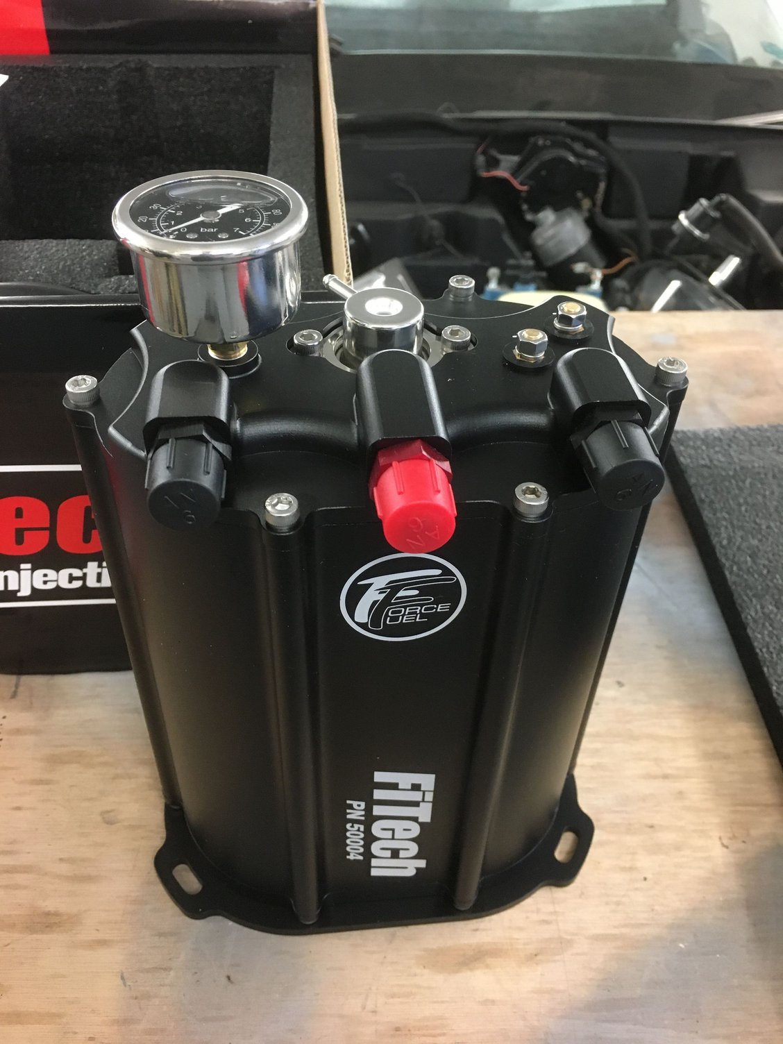

thanks for the help the v belt fits in the pulley but sit deeper in the groove were as the alloy crank and alternator the belt sits flush . i have put a efi kit on with the efi command center so hoping there will not be a problem .

Command center, yup, there will be trouble. much better to just put correct pump in place of the 82 pump. LS Style filter regulator or a Holley set up with intank regulator. Command center, well, good luck.
