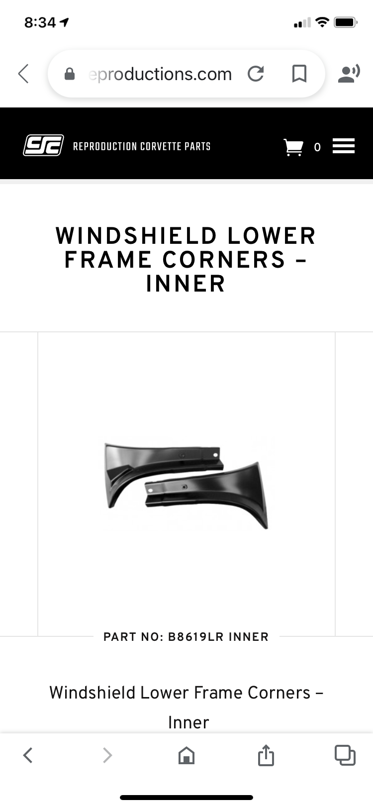

Like these. CSC reproductions May not be what you want.

[QUOTE=speedreed8;1603559460]Like these. CSC reproductions May not be what you want.
[/QUOT
those are inner corners, he needs outer corners. I talked directly to CSC and they do not make outlets.
