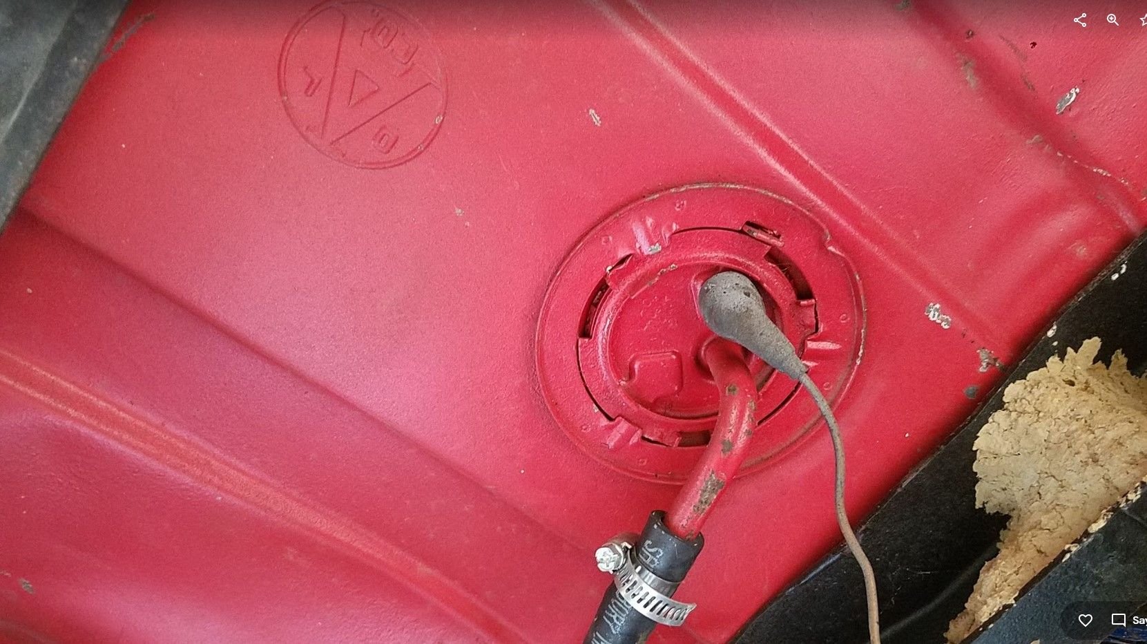

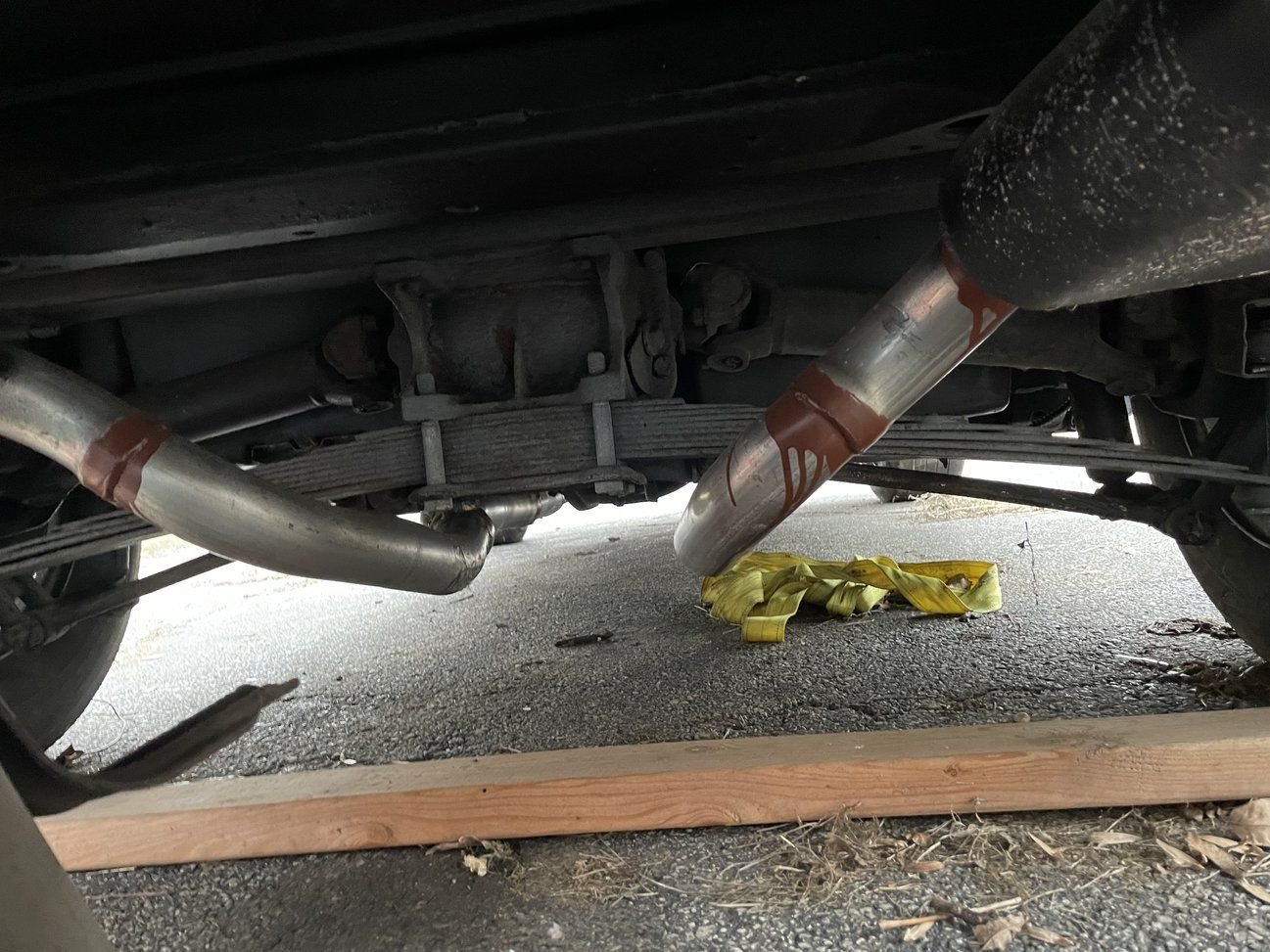

Thanks Paul! This is super helpful and yes, you're right, I am trying to figure out what engine originally came in it. I am still waiting on the transport to deliver it so I can't answer some of the question yet, but have some pictures that may address some of the questions.
  • Tank sticker - I will check that once it arrives
  • Tach - Yellow begins at 5,000, redline begins at 5,500
  • Rear stabilizer bar - I'm not sure?? See picture below to help out with this question as well as the half-shaft question
  • Brake lines - Will have to investigate when the car arrives
  • Return line - It appears that there is no return line. See picture below
  • Half shaft - It appears that it connects with U-bolts

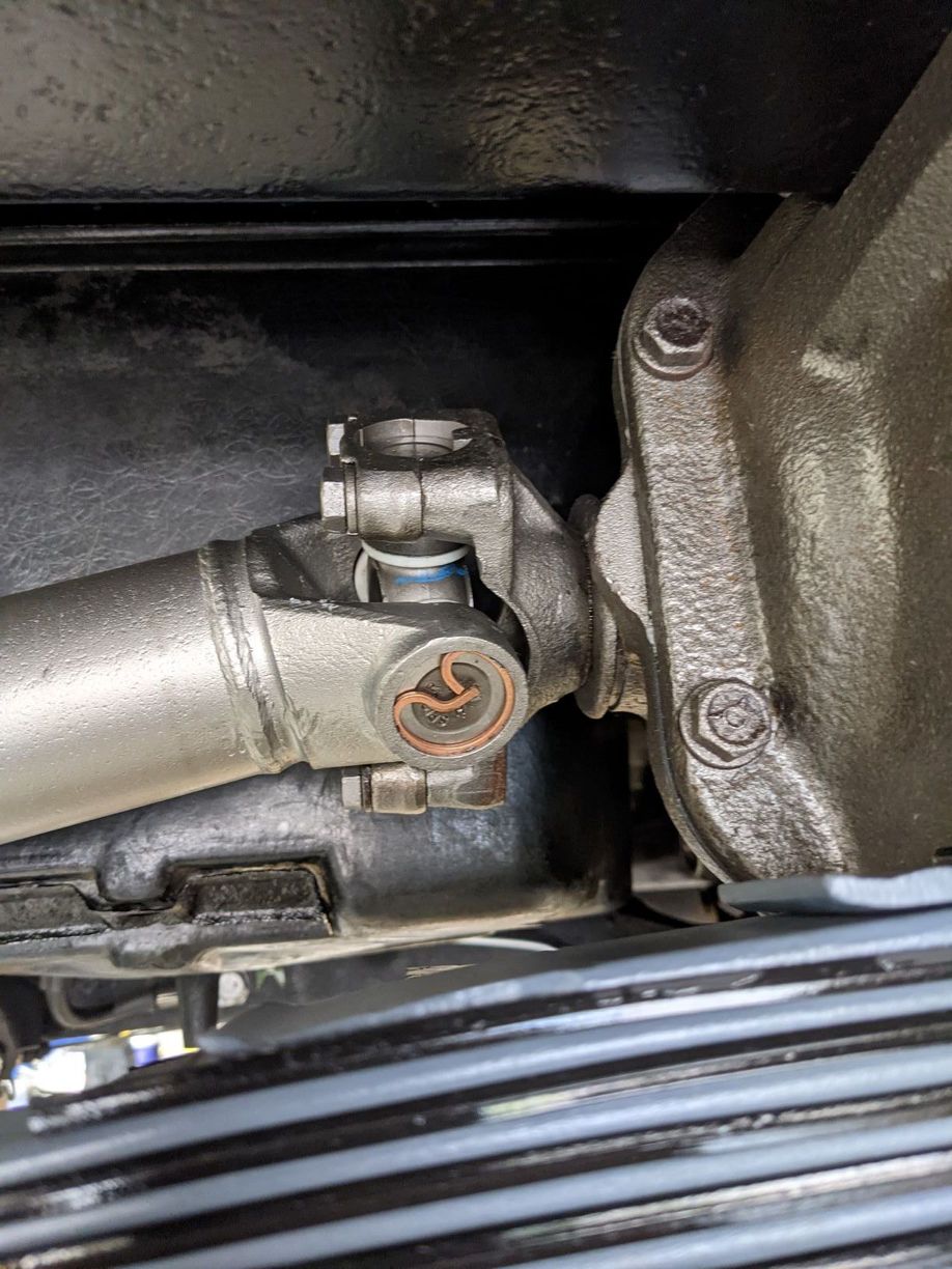

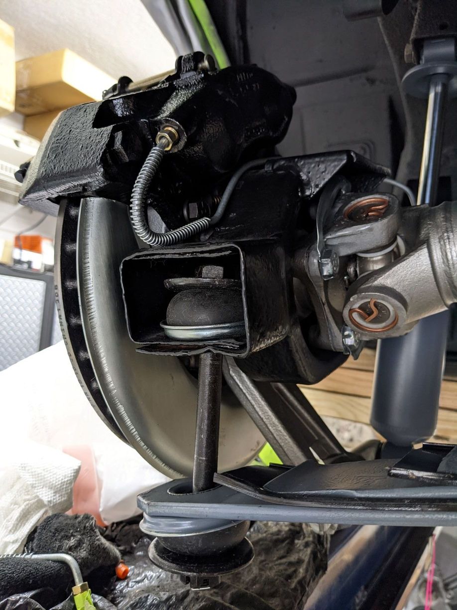

You are most welcome. What I'm about to share I believe to be correct. These are 'indications', but not 'verification'. If I'm wrong on some of the comments, a more knowledgeable forum member will correct it.
* Tank sticker is the best way, but after 50+ years it's a crap shoot. Bore-scope is your friend.
* All BB had rear stabilizer bars. I haven't reinstalled mine yet, but they attach at the top of each trailing arm above the spring bolt. You can see where it would be on the attached.
* All BB cars had armor on the rear caliper brake lines as you can see in the attached picture. If you still have the original lines and they have armor, this is a good indication.
* All '68s had front stabilizer bars. Base suspension and SB cars had 3/4 inch diameter bars. All BB and F41 (hd suspension) had 15/16 inch bars. I don't believe your car has F41 because you have a 9 leaf spring (F41 has 7 leafs) and it looks like the original spring. So if you have a 15/16 inch front stabilizer bar, that is a good indication.
* I believe all SB cars had return lines to the tank and BB cars did not - but it may be that only tri-power cars did not have return lines - I can't remember for sure.
* SB cars used u-bolts from the half shafts to the diff. All BB cars used caps as shown in the attached pic. It's possible that someone may have changed them one way or the other, but not highly likely IMO.

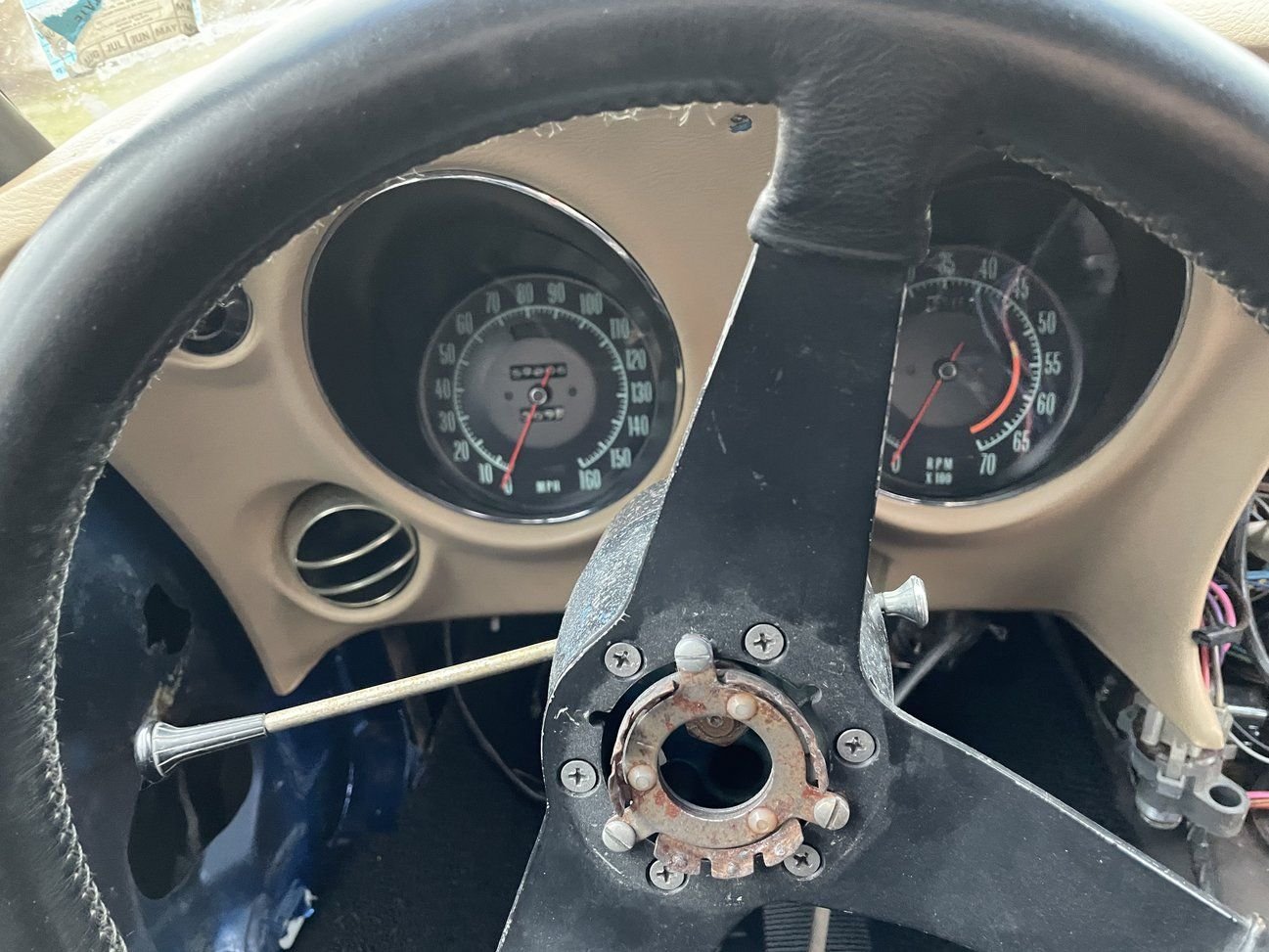

* Not sure about the tach redline - someone will have to step in here. This is what I think, not what I know, except for the L71, L89, and L88 which for sure have a 6500 redline: I believe the 390 hp 427 had a 5600 redline (and maybe the 400 hp too); I believe the 350 hp 327 has a 6000 redline. A pic of your tach when you can will help.
Keep us informed of what you have and what you find. Stay well, Paul
Half shaft caps
Brake line armor; rear sway bar mounts just to the side of the brake line on top of the trailing arm.

Thanks again Paul! I have included two more pics: 1) instrument cluster. Not the clearest picture, but it looks like a 5,500 redline, or possibly 5,400 if that even exists. 2) found a picture that had the rear brake caliper and it does not have the armor.
So, if I am following along correctly, the indications seem to be pointing toward a SB. The half shaft u-bolts, no rear sway bar, no brake line armor all seem like items that would not have either been replaced or removed. Gas tank (no return) and tach both seem like parts easy and reasonable to be replaced during a resto. Hopefully the tank sticker is still there! Any other thoughts are most welcome! Thanks--Lee
