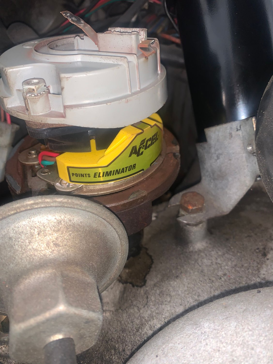

Ok, so now that we have established the ROE, let’s do this! Post a picture of the little door on the distributor if there is one. If not, let us know and we’ll move to the next step.

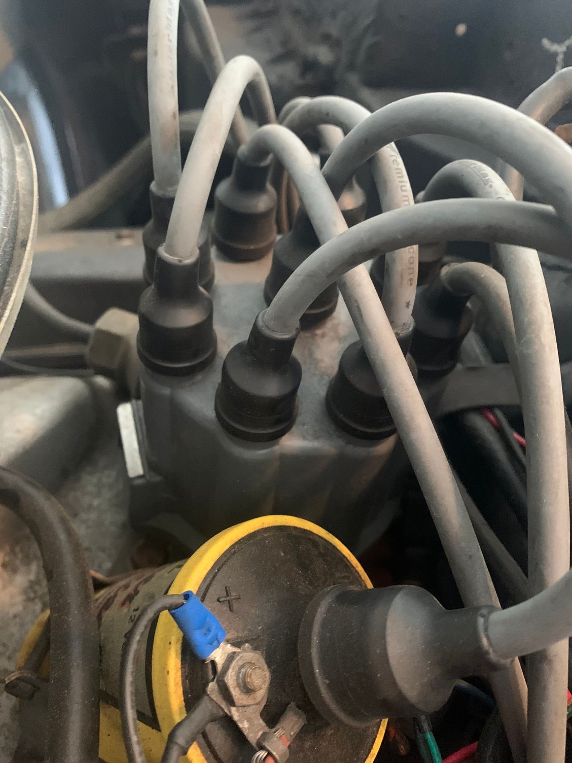

Awesome thanks for the help! Really appreciated from what I see looks like there is a little door on it so I believe it’s a points and yes This is my first corvette and I do not have any experience with them or engines in general also on other thing is it has a rough idle if it hasn’t been started in a day or so
Excellent! You do indeed have a points style distributor. The yellow cylinder next to it is your ignition coil. Those do go bad and can be easily replaced. The first thing I would do is have it checked to make sure it’s still good. If not, replace it. Inside the distributor (under the cap) there should be a small cylinder with wires coming out of each end. That’s your resistor and if you’re going to change the coil, change the resistor too. They can go bad and it’s a cheap part. Replace it if you replace the coil even if it’s still good. It’s cheap piece of mind.
Also, behind the little door is where your distributor points live. They can become fouled with carbon or even weld themselves together. Check them. If they’re fouled you can get a points file at the local auto parts store and use it to clean them up or you can just replace them. They too are cheap and again, new ones are cheap piece of mind.
If it’s not any of this, we’ll move on to the carburetor, but let’s make sure we have fire before we address fuel.

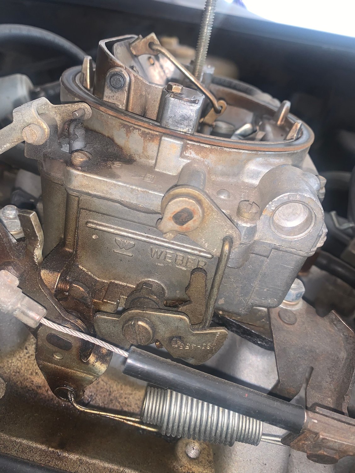

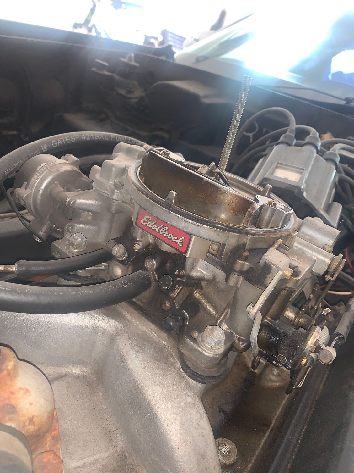

What carb is on this?
Jebby

Hey so I replaced the ignition coil on it because the old one was reading 6.8 ohms and now the new one I just installed is reading 9.44 ohms and went to look at the points and found it has a accel points eliminator kit on it... so not sure if it has points still or not but car still is idling rough and is dying if I don’t give it any gas... I have not taken it out to see if it’s still dying while driving or not because seems like the new coil was not the main issue on it but the carb that is on it is a edelbrock Webber. Thanks! Also when trying to start it smells like gas really bad still as well

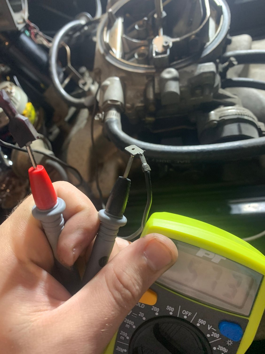

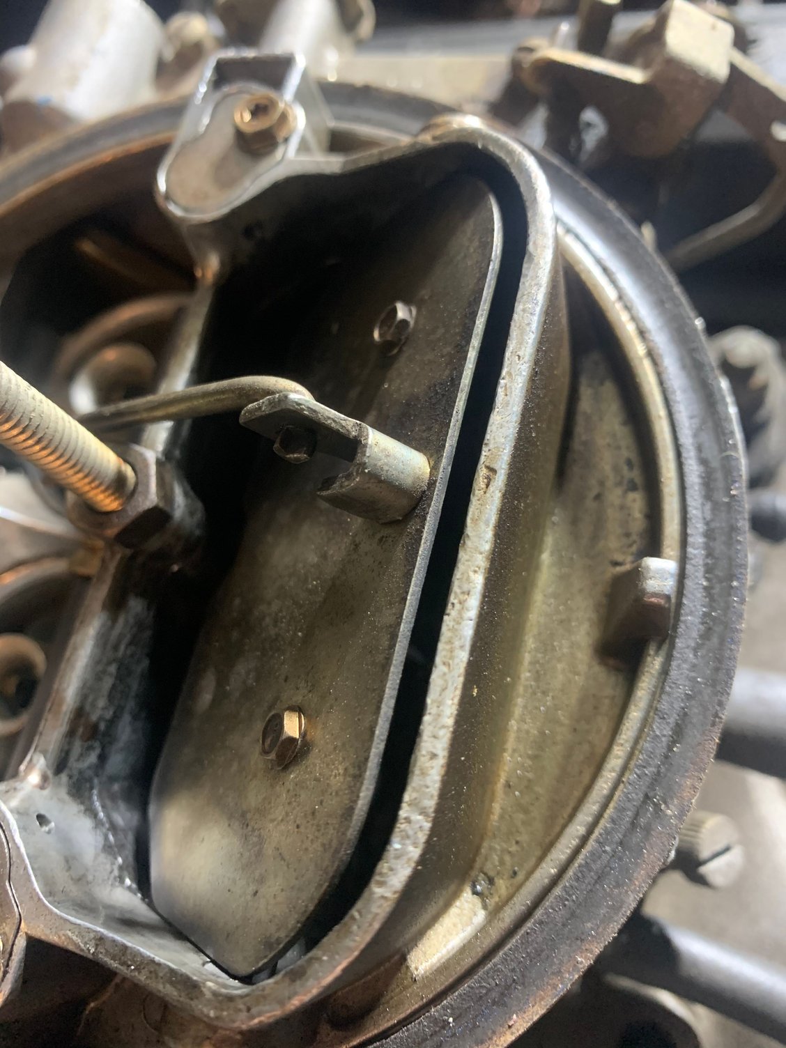

I would have started with the tuneup components like the distributor cap and rotor first but I realize your looking at what will be easiest to change...
So you have an electric choke on that carb but from what your saying it sounds like its not working right. The flap above you main throttle butterflies should close if you blip the throttle once with the car off and cold.(its almost closed in the photo you took but not quite.) there should be a power wire conncted to the choke where the large black plastic thing is. that should have 12v to it only when the car is in run position which heats up a coil and opens the choke plate. you can adjust the cold position of this plate by rotating the black circle after loosening the screws that hold it locked down.
Then it should open after a couple mins of the car running either slowly or when you blip the throttle again while running. This would be one reason you have to keep your foot on the gas when cold. It also will cause the car to run too rich and possibly stall if its disconnected and adjusted as it it in your picture.

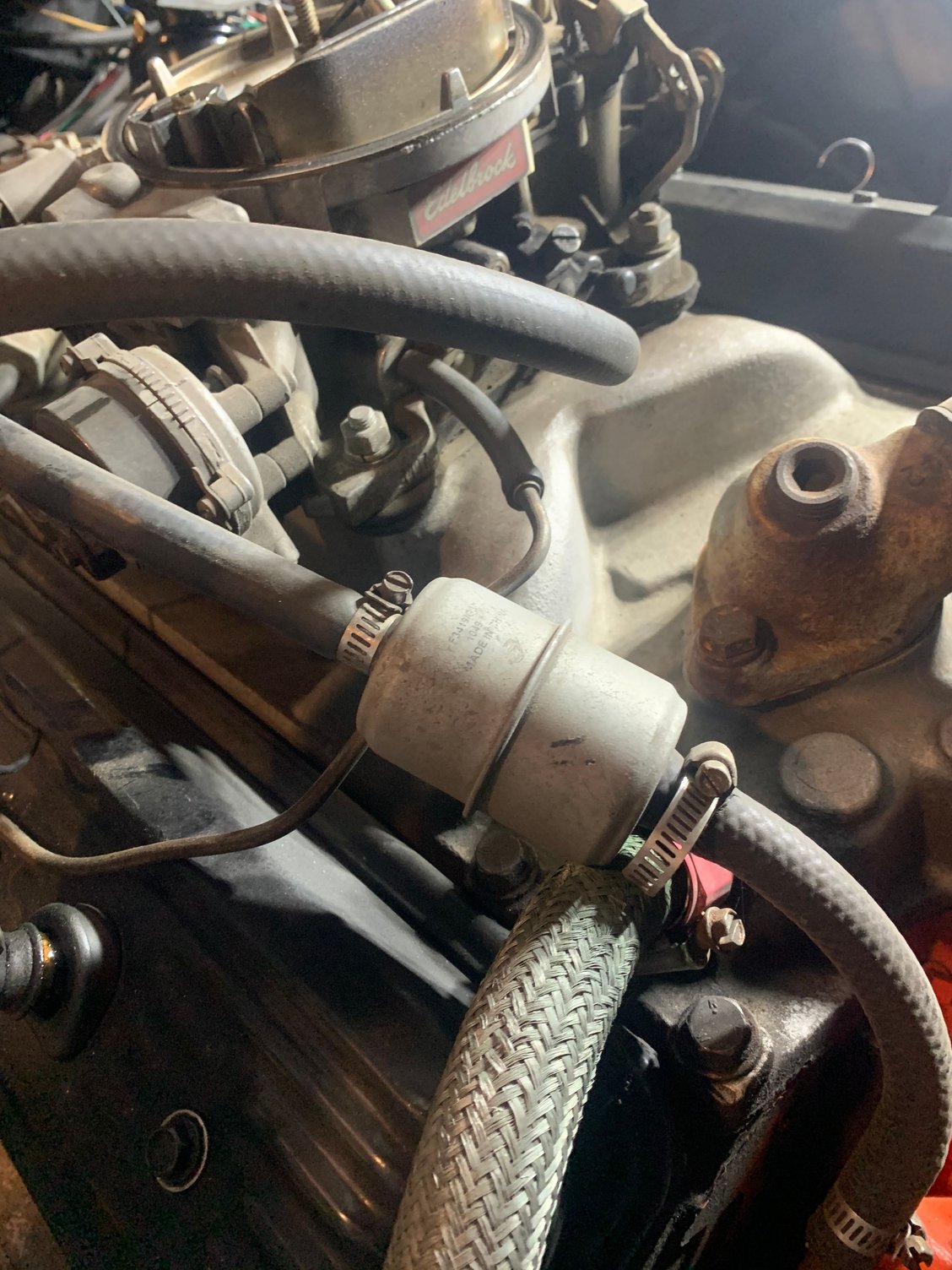

Stupid question but is there a fuel filter located between the pump and carb and have you checked it recently?

btw my 74 had the same carb and points eliminator on it as well as the broken tach cable when I bought it.... none of which are on the car now.. not that theres anything wrong with the setup, I just found it kind of a funny coincidence.

[QUOTE=augiedoggy;1603626532]I would have started with the tuneup components like the distributor cap and rotor first but I realize your looking at what will be easiest to change...
hey so I did a voltage check on wires going to the plastic thing and it’s reading 5.73 volts and that’s with car on the on position ... so seems to be far off from 12v and as far as the flap thing when I press the pedal it doesn’t move at all and I’m doing that with the car off, and that’s funny u had same set up before but yeah I don’t no any thing about these so definitely glad there is this forum like this to help! Also I am posting pic of what i think is the fuel filter but I have never changed it or checked it before if it is.
