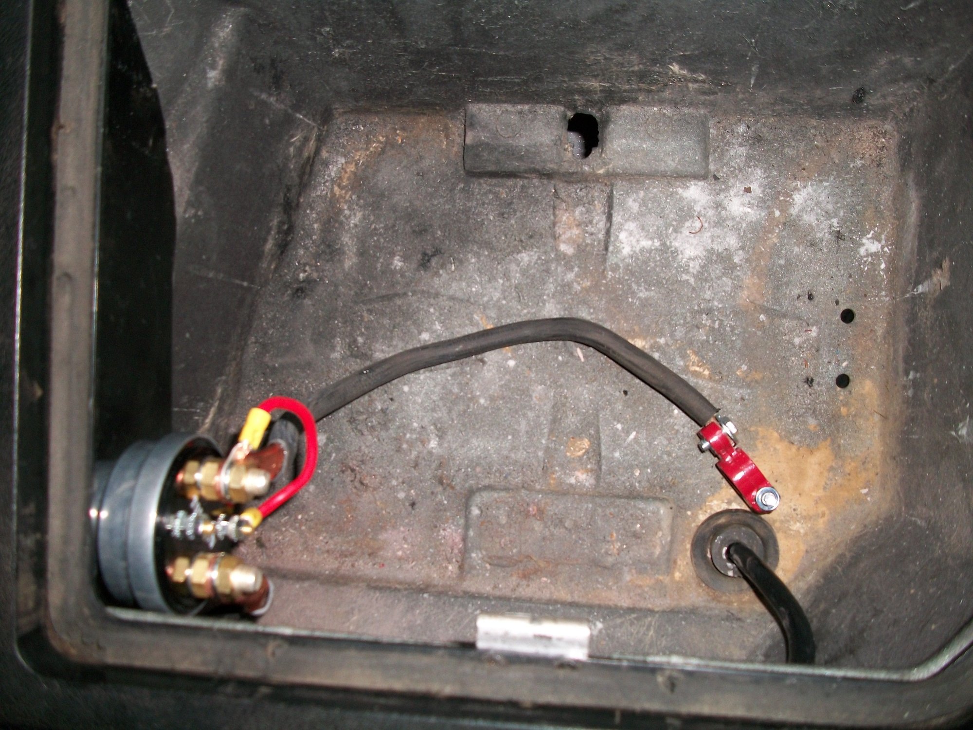

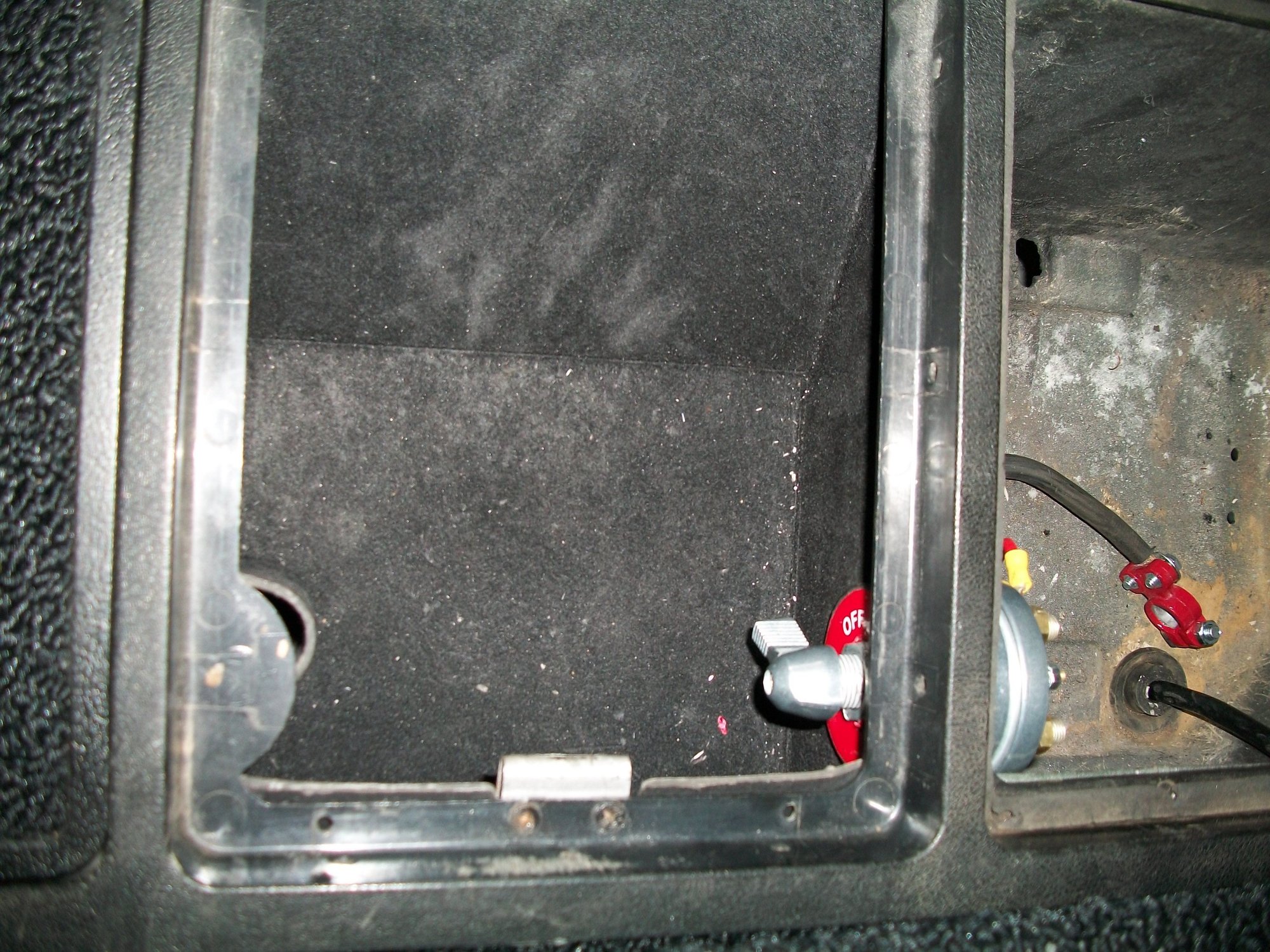

I put one in so that the switch is in the glovebox. I beefed up the side of the cardboard insert with fiberglass. Once the battery is in, I have a plastic cup I cut down to slip over the terminals of the switch.
