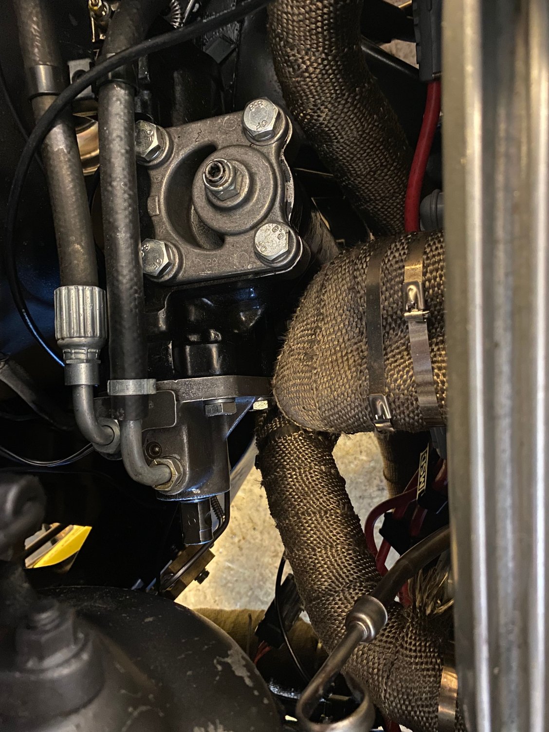

Just need verification that the steering shaft portion does in fact collapse inward before I go and damage anything that I can’t undo. Also, obviously I can’t press on it using the wheel as the base or it will bend the rim…. So any ideas on how I can before I install it back into the car.
issue is, it’s protruding to far out that I’m unable to even bolt it to the fire wall to pry it back in as the splined portion makes contact with the steering gear input before any bolts can be used to secure it.
any advice at this point would be greatly appreciated!
