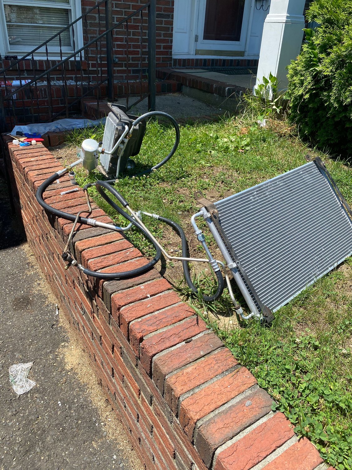

put together some parts. i have about 350 in this not counting the parts i shouldn't have bought or were dupes. this should fit either R4 or A6 compressor. or the sanden with extra 25 bucks for the stock GM hose mount. aka cylinder head. liquid line is not gonna fly. about 80 bucks for an 80-82 line that has the High pressure port. . 82 evap and accumulator. about 110 bucks for the 2. end of evap is the orifice holder. 82 hose set as the firewall end is different from the VIR type 75 i have. 56 bucks. parallel condensor is on ebay for 95 bucks. and your earlier liquid line has wierd fittings so it is best to just buy the 82 liquid line. i may try the cobbed up patched up line just to see if i can make 6 hose connections hold 330 psi. so around 350 before the compressor. 110 more for sanden knock off. 250 for real sanden. the A6 mount can be altered to fit the compressor. so in the 5 to 600 range all new parts,
