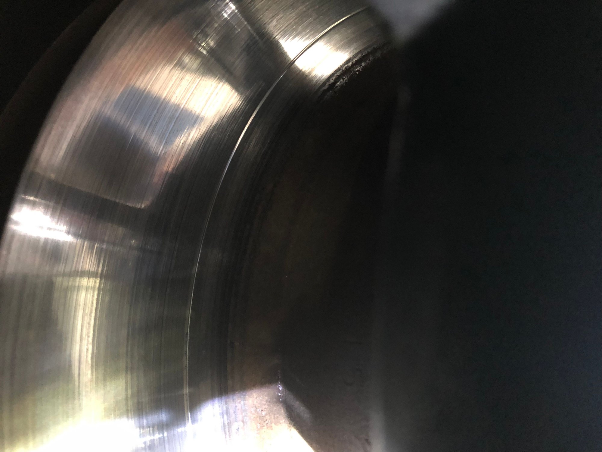

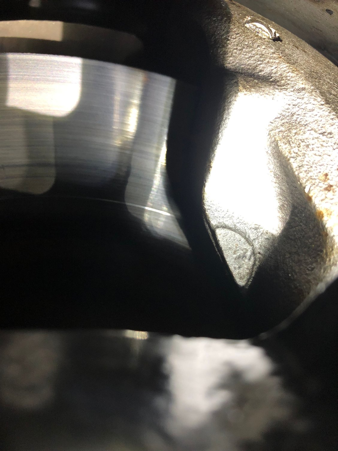

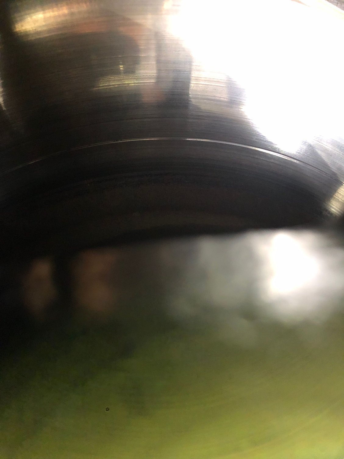

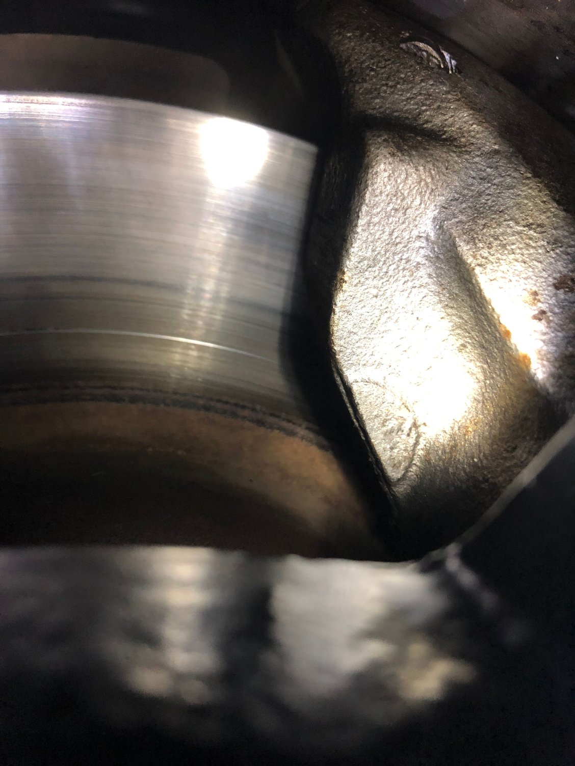

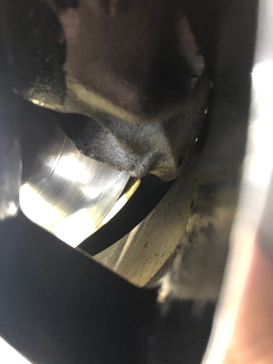

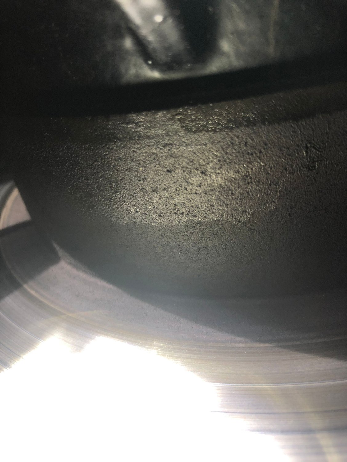

I can’t take the wheel off right now but here are some good shots through the wheel slots.

There are currently semi-metallic pads on with a decent amount of pad left. It is scoring right where the rivet is.
I was thing to put new pads on without rivets. The bonded type. Maybe ceramic or organic???

If there is pad left that rivet didn’t make that. Maybe previous pads wore or a chunk of debris was caught..
honestly, i would not be replacing if it were mine..it there a breaking issue in performance? And if there is it is not because of that groove.

UNLESS you really want to buy new rotors, those should be good for another 40 years (think about how deep the slots are that are factory-milled into aftermarket rotors)

When you get time...or when you remove the wheels to replace the pads...post a pic of the rotor with the worst groove AND the mating pad also just for verification of pad thickness/type of pad/rivet depth in the pad/etc. for future reference for other members.
