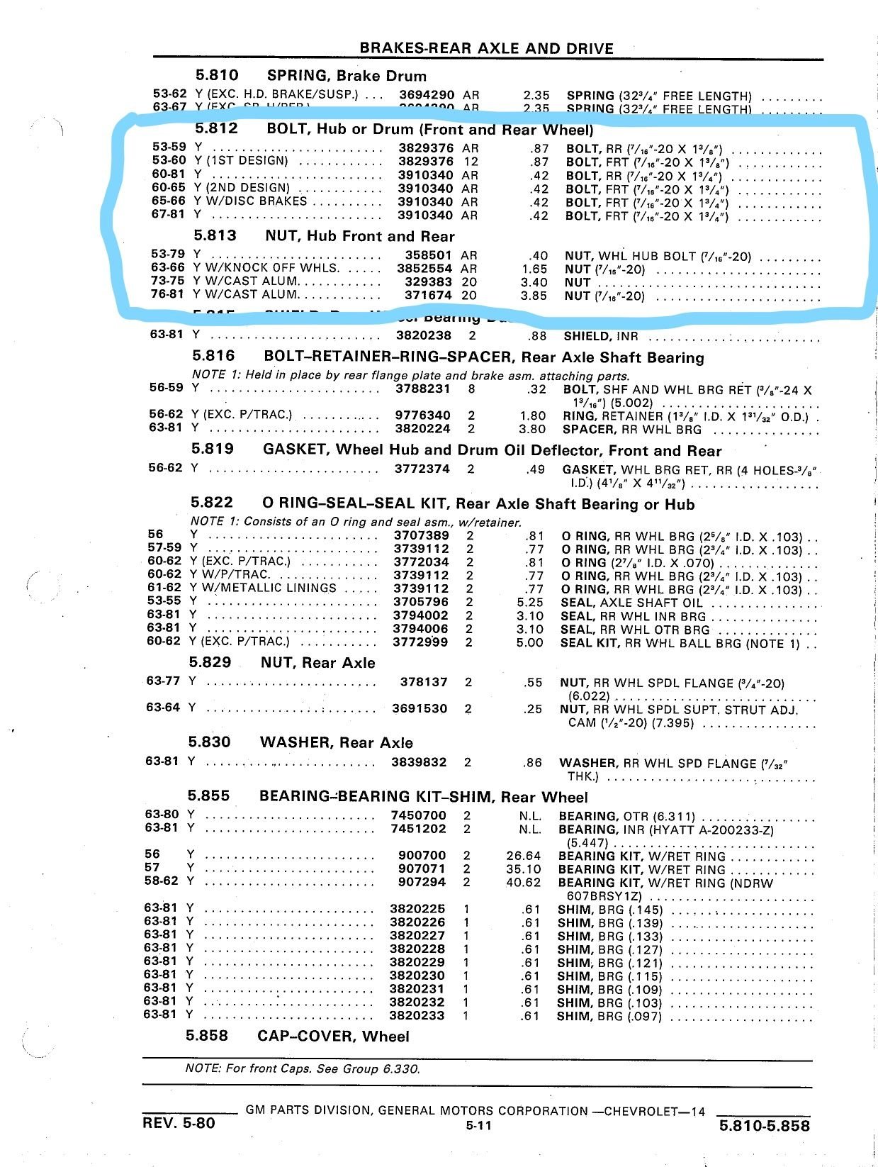

trying to get some info what size to fit wheels for C3? i cant seem find it can u give me info that would be greatly. thank !! HAPPY 4TH TO U ALL MEMBERS!!!!

7/16's fine.

no clue what year, or aluminum etc.. but the washer part matters.. i went zip corvette and got USA made seem damn decent..for my 79 aluminum...
