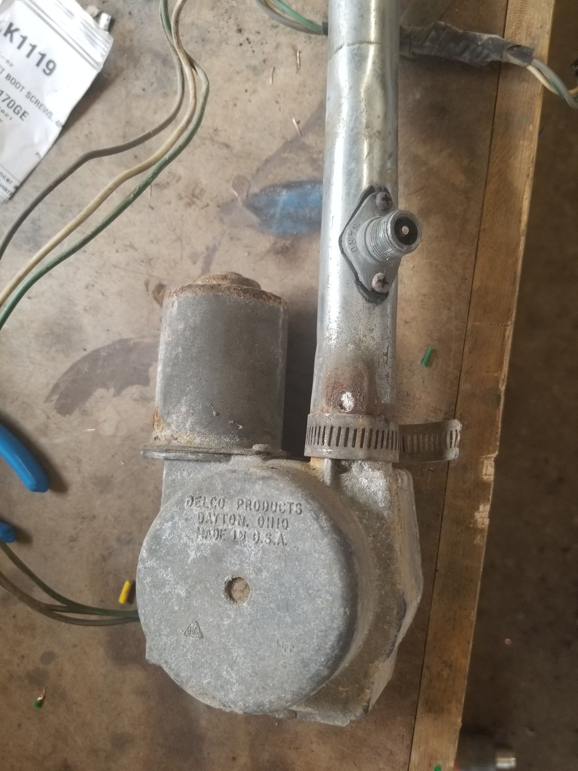

Looking for which wires are power and or ground AT the power antenna on my 78. The relay inside the car clicks when I put power to the yellow wire coming from radio. I want to test the antenna itself to see if it actually works or not.

this might help... its a 79 but it was a 78 cast carryover
Advice removing c3 79 power antenna wiring - CorvetteForum - Chevrolet Corvette Forum Discussion

Try this link…
@KapsSA saved mine
https://www.corvetteforum.com/forums...r-antenna.html

Thanks! That definitely helps. Bench testing the antenna, the motor works and the mast moves. Checking the relay tonight.

Hanks everyone. It ended up being the orange wire about 6 inches before the relay. The ONY wire the mice chewed on in the entire car. All fixed and it now works.
