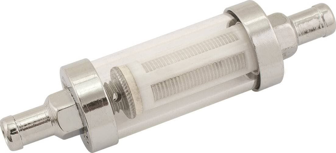

Pull fuel line at carb..check flow rate ounces and pressure ..post some pics of your filter…glass?
I think it’s a glass one it feels like it is at least here’s a pic of the one I use since I’m not home at the moment

those glass filters are a fire hazard waiting to happen, they crack n leak and spray fuel onto the hot exhaust.
it should not be needed if the filter is in the carb
alright I’ll remove it as soon as I can then thanks
