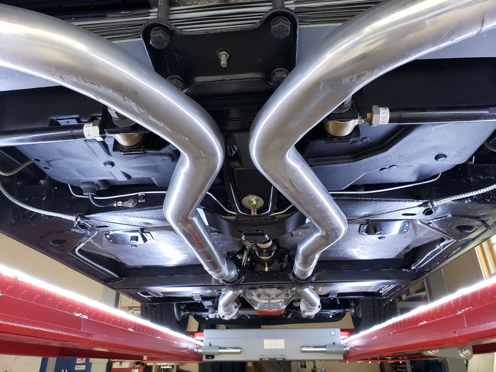

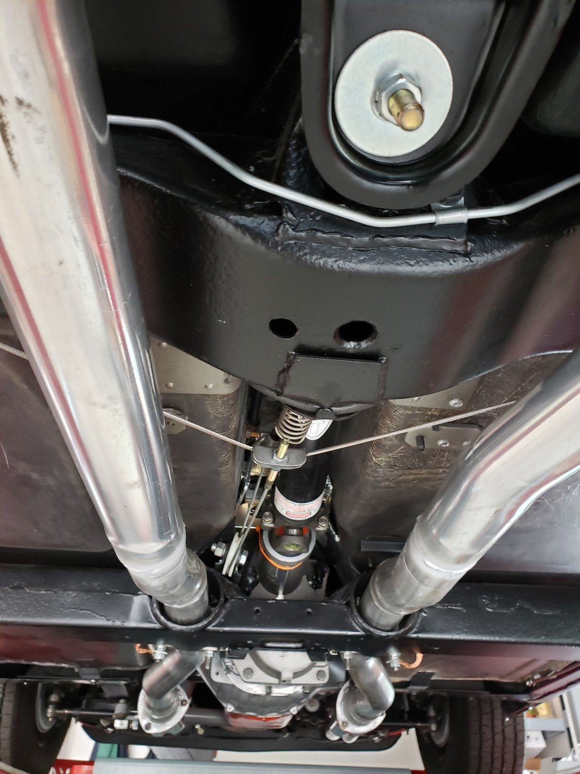

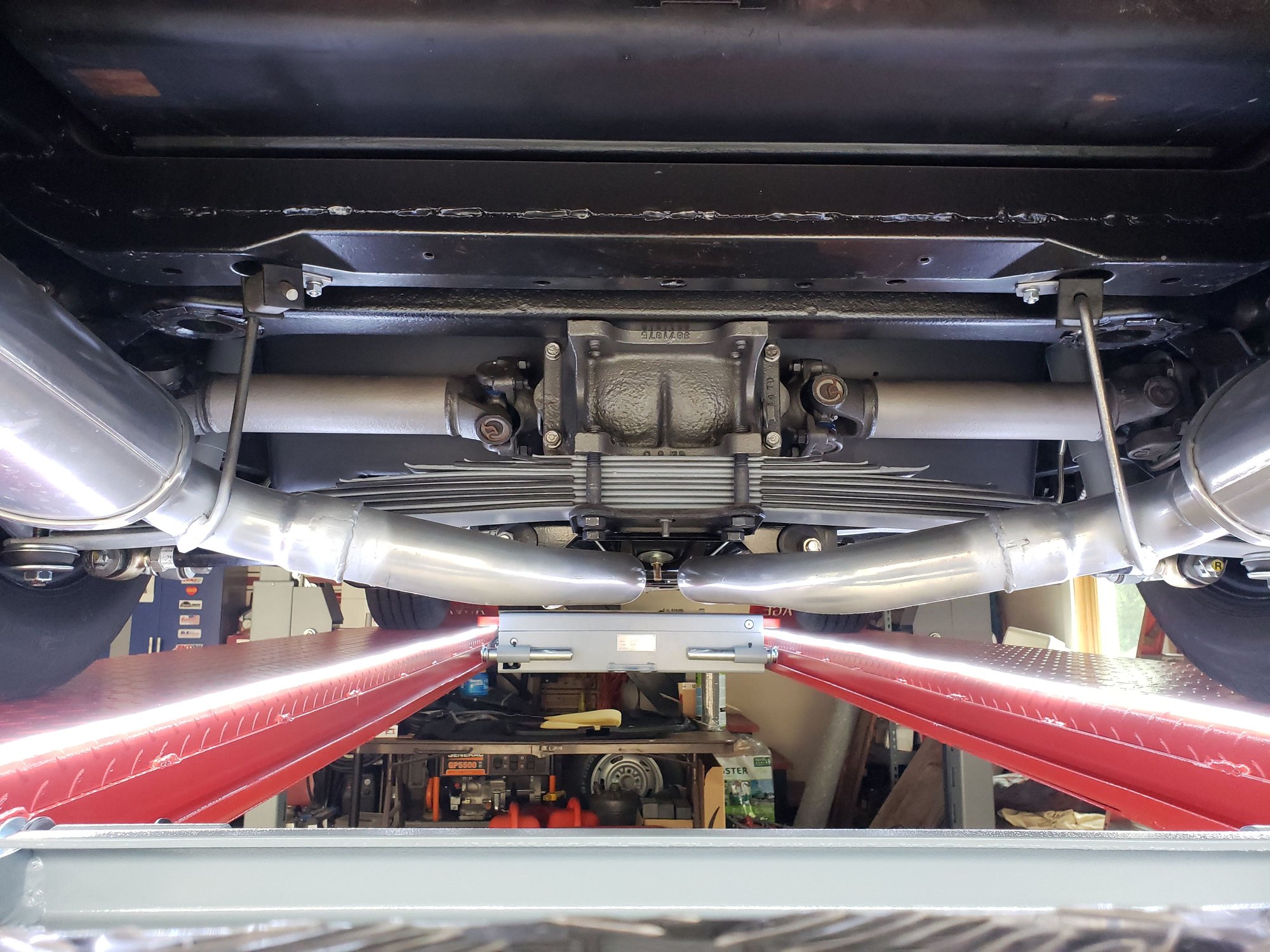

Finally put the car on the lift for the first time. Everything cleared including the air jack. Love the LED lights. Now I can adjust the headlights while standing.

Nice car. Very nice. Thanks for posting.
Questions:
Can you share some detail on the LED lights?
It seems to me that these lights would create a conflict with the jack when sliding it fore/aft on the ramps. No?
I would like to have fixed lighting on my lift but I use the jack and haven’t figured out how lights would get along with the jack abs drip trays.

l bought the light kit from Advantage lift. It cost $180.00. The kit consist of 2 - 14' long heavy duty LED strips, a switched intermediate wire harness and a transformer. The actual strip is about 3/8" thick with pretty strong magnetics to position them where you want. I put them on a 45* right in the corners of the tracks. My rolling air jack clears with no problem. A bit pricey at first but after installing them, I feel they are worth cost. They are much better quality than some I bought off Amazon for $40.00 each side. They are very flimsy and no attachment method. These just work. I think this is a classic example of, you get what you pay for

I wanna know about that exhaust system ? lol , nice rack though

I bought 2 1/2" system from Zip Covette. It stock configuration intermediate pipes only. It came with 2 bends at the back to connect the N11 off road mufflers. The N11 muffler has 1 less baffle than stock. Sound great to me. But when you get on it,, it barks. Anyways, once fitted and connect the the long tube header, I disassembled it and had it ceramic coated. This really helps keep the heat down and increases the scavenging effect of the exhaust. Hope helps.
