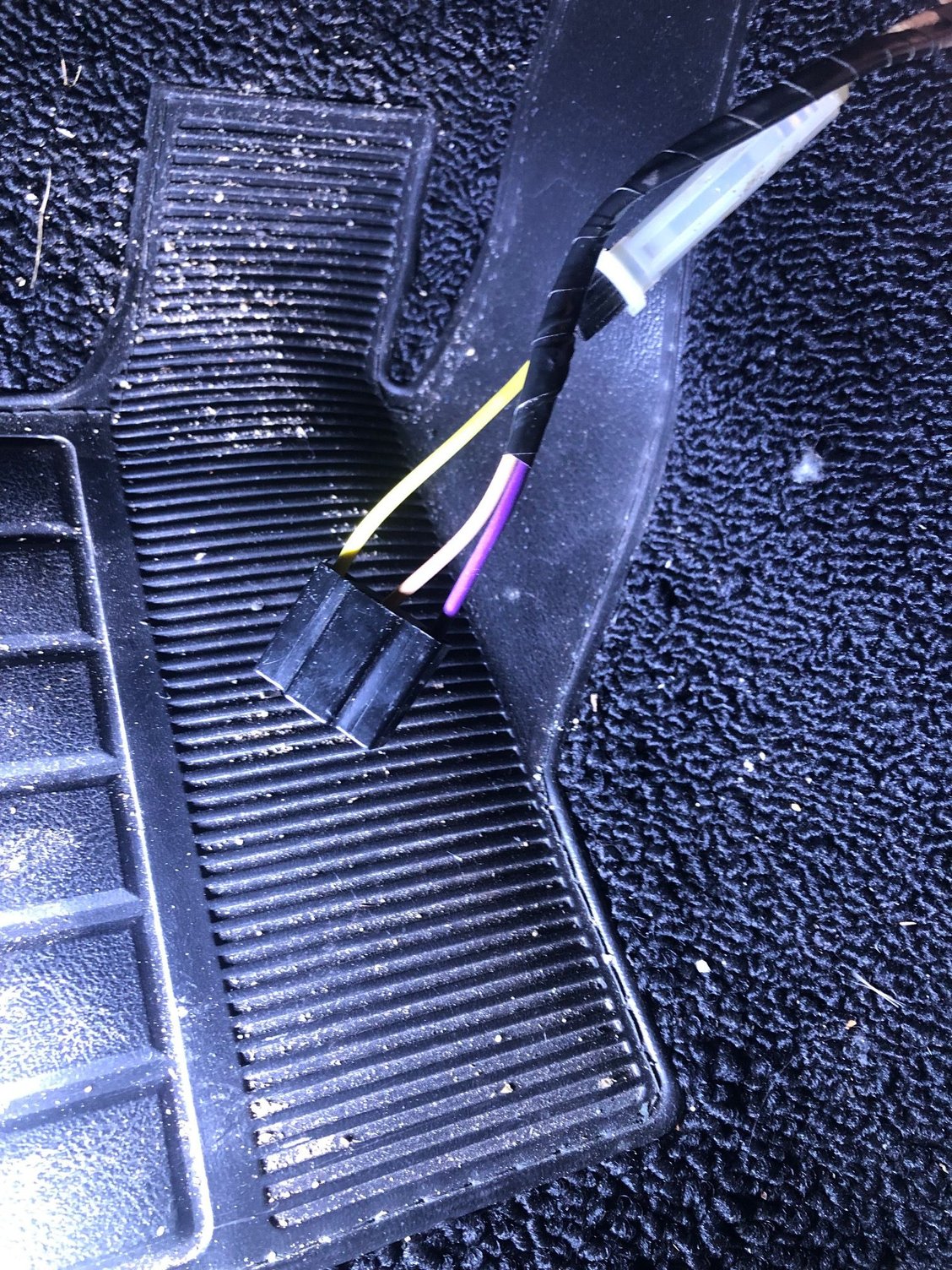

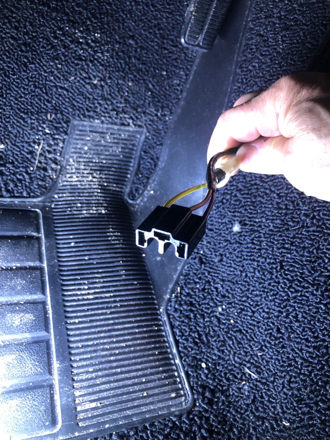

Hi all, after a two year hiatus restoring my 1968 Corvette coupe, I'm back it. I left of putting the dash back together, and so I got going with that today. The car has a new Lectric Limited harness, and I have a connector that I can't identify where it connects. Can you please take a look and tell me if you know what it is? I couldn't find it on the assembly manual wiring charts, and it is not called out on the vendor's wiring diagram either. The colors appear to be yellow, tan, and either purple or blue. Thank you!

That's for your rear defogger switch on the forward part of the console.
