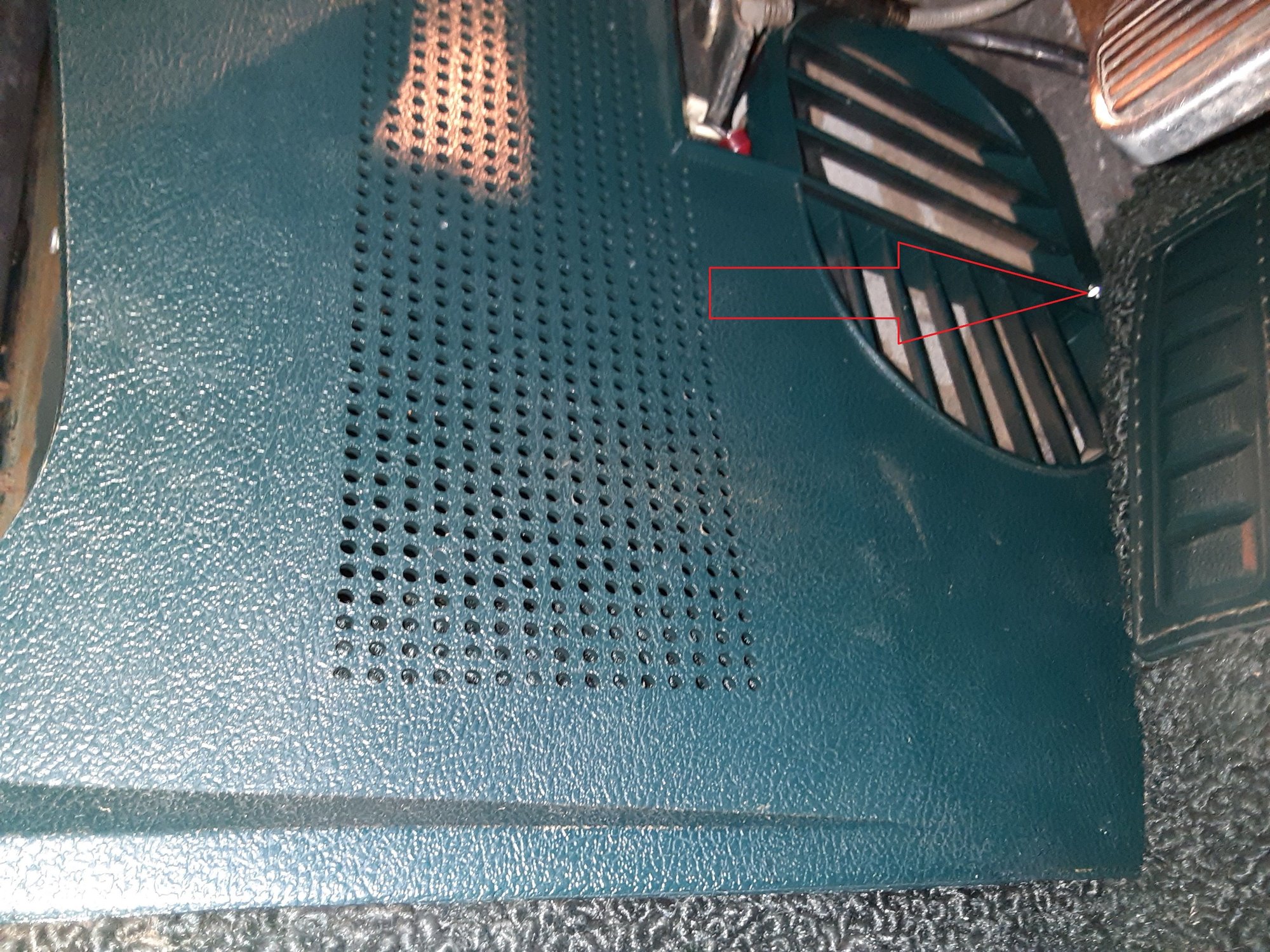

Hi everyone. I have a 68 coupe, and am in the process of installing the kick panels (the hard panels down by your feet, covering the speaker and air vent door, see pic below). The panel has two screw holes on the firewall side, but what do the screws attach to? I see no holes in the metal between the vent door and the firewall. Are there supposed to be stand-offs or something installed?

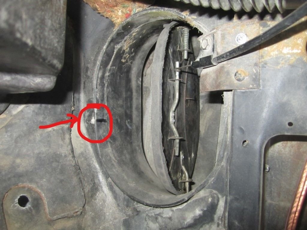

On my 72 (which look like those but 68 could be different) there is a single hole that is really hard to see in the middle (up/down) of the vent oval, it's behind the lip on the car side so really hard to see, use an awl to locate / line it up

Hole in the fibreglass about here (not a nut or insert or anything)

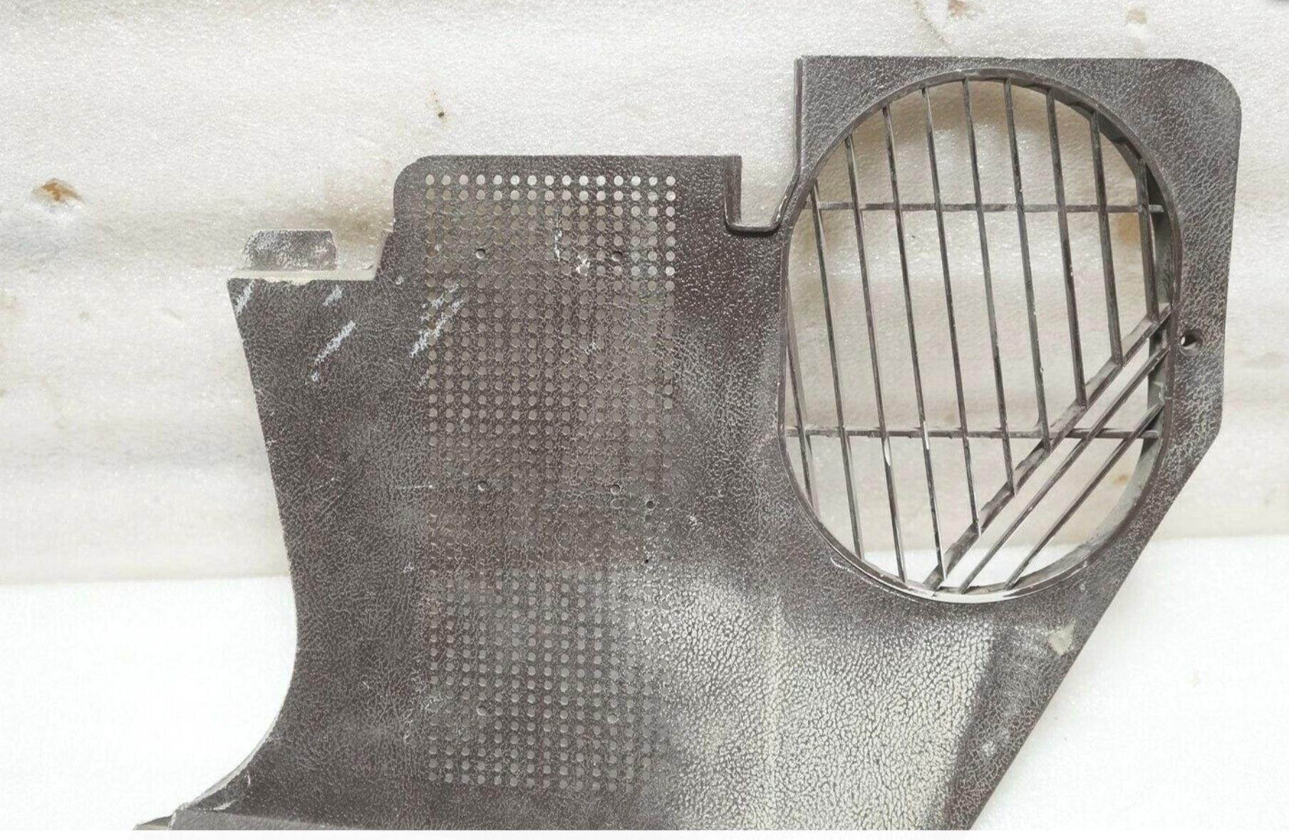

You may know this already, but the 68 is a one year only kick panel. The picture you are showing is that of a 69 and up. The 68 has angled vent ribs. Here is a picture below of a 68 panel.

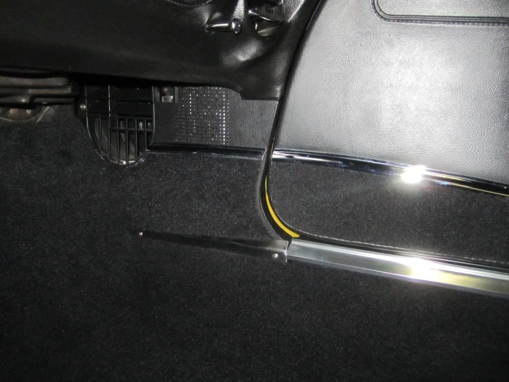

Fancy carpet and trim on the kick panel Mooser....nice job.
I always put the screw back in my kick panel too, although it would stay in place without it.
