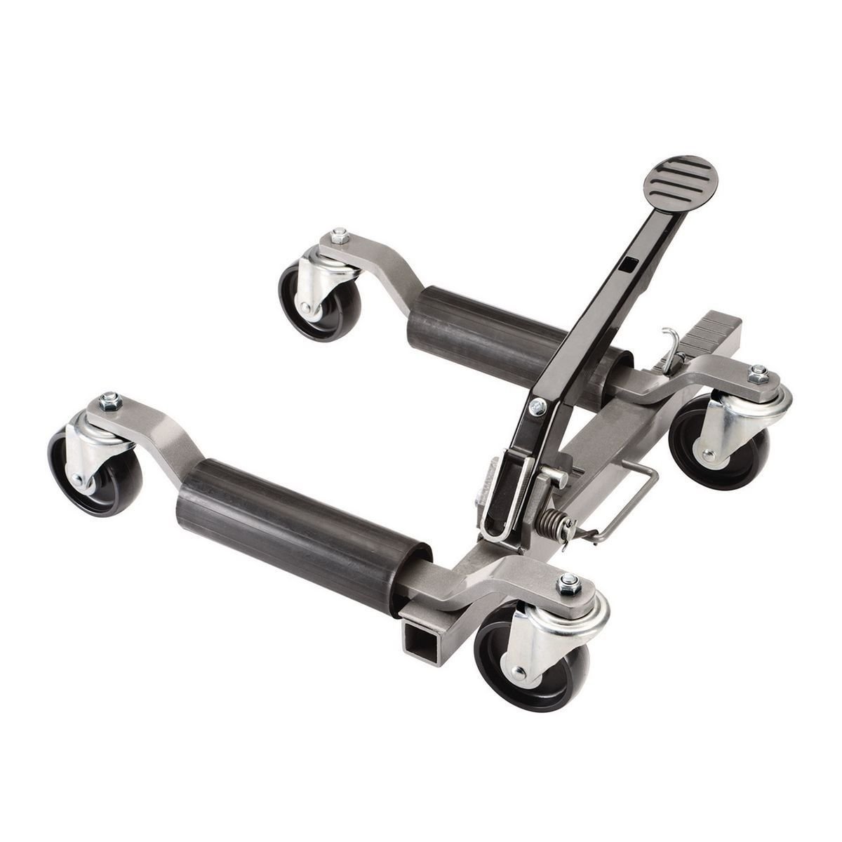

Originally Posted by Corey_68
I have these that I use in the shop, very handy in tight spaces. With one under each wheel, you lean against the car and it will move.
https://www.harborfreight.com/1250-l...MaAiyIEALw_wcB
Thanks! I find leaning on the car (without dollies) no longer produces the desired results. Getting older and weaker!
I know the feeling
I deleted the post when I realized you were looking for a one time use. Those would work, the less expensive one should as well.

I have a cheap set of Car Dollys from Harbor freight. They will not roll on anything other than flat concrete. As stated above, a lip in the transition into the garage will stop my set from rolling.
However, once in the garage they roll great on a clean floor. By myself I can spin my car completely 180 degrees. Not super easy but not hard at all. I rarely use them but when I do they are worth their weight . . . .

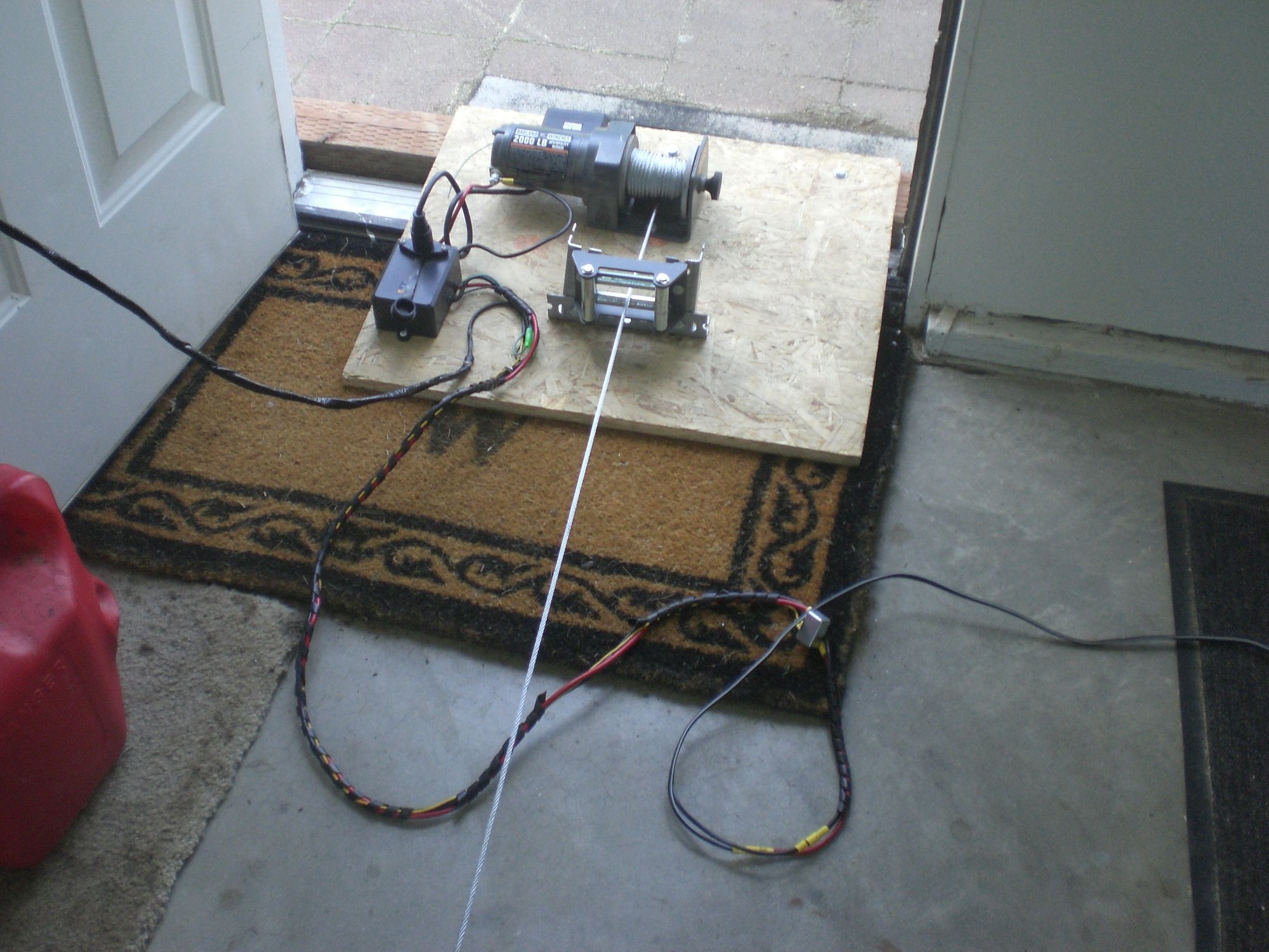

I have a man door at the back of my garage. I simply mounted one of the HF 12V winches to a 4x4 that spans the door opening and use that to pull the rolling frame or car on dollies up the driveway and into the garage. I imagine it'd work with a hand cranked winch or come-along too.
This is powered by a small 12V garden tractor type battery and has a remote control for easy one-man operation while guiding the car.

I have the Harbor Freight dollies as well. I ground the inner part of the foot tab off for better tire clearance, but you can't beat them for the price. I bought them on sale for $65/each.
