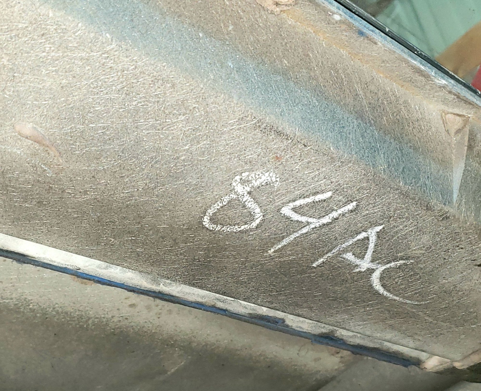

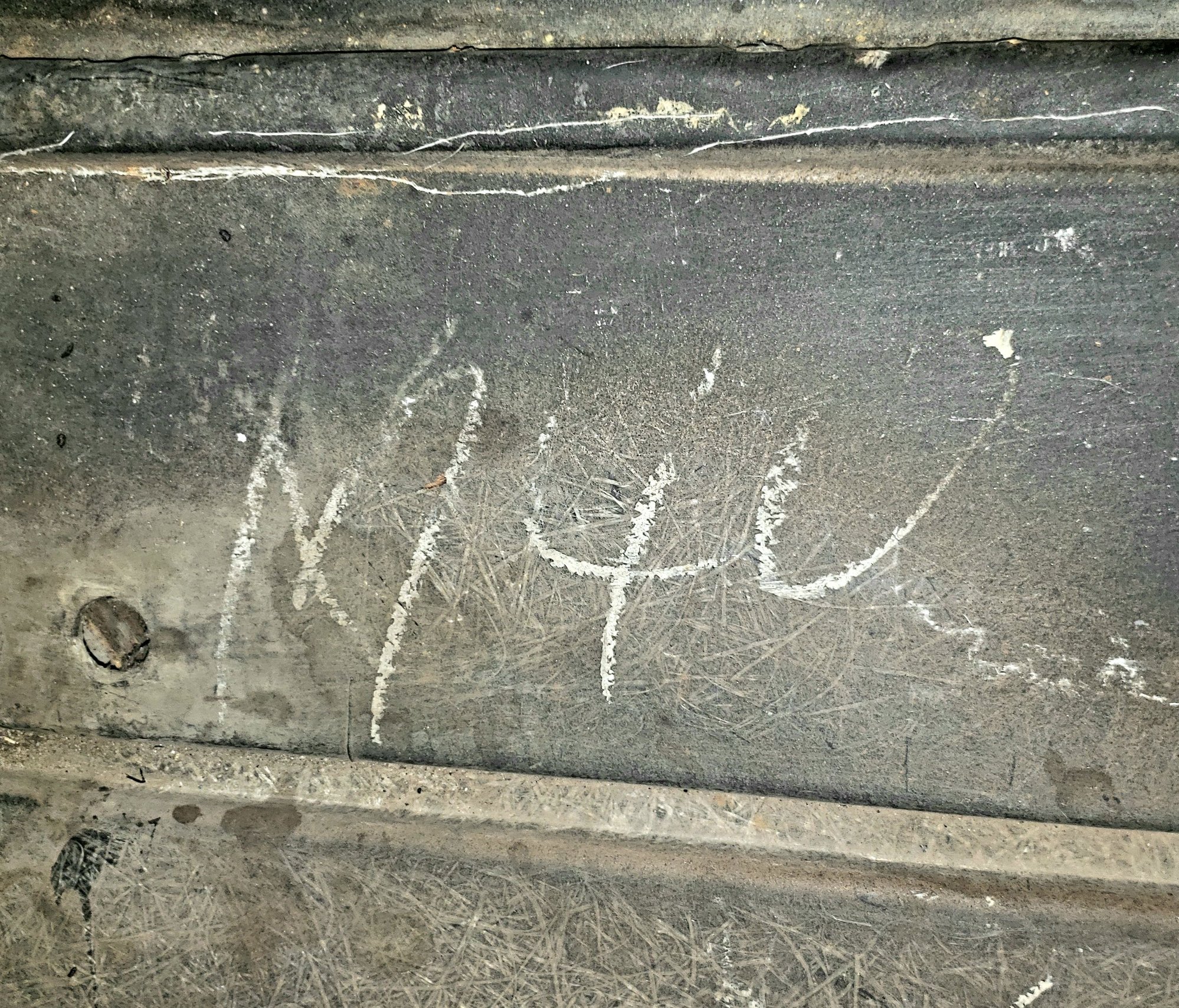

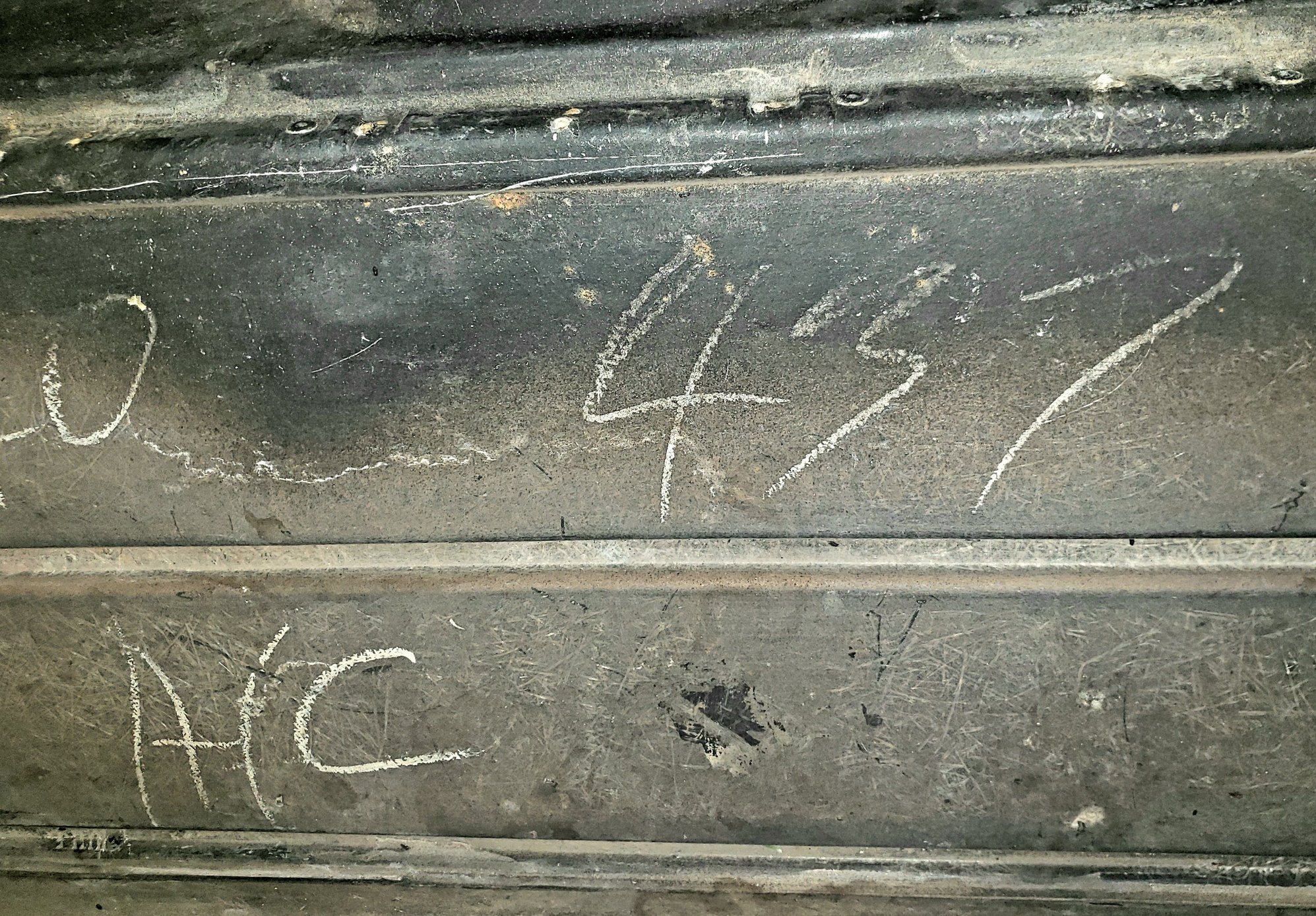

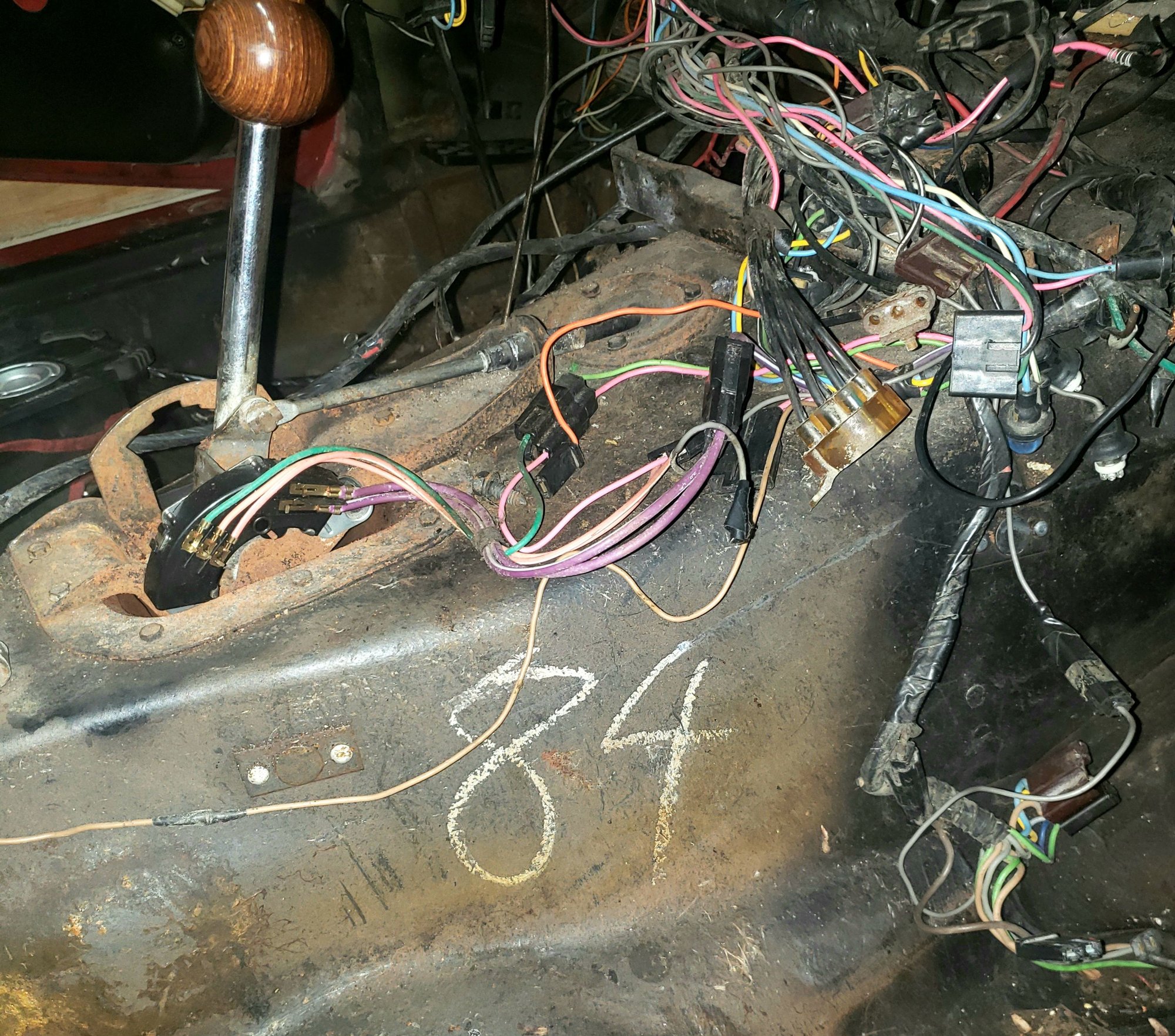

Howdy! This is my 1st post in about 8 years. I finally gathered up the courage to rewire my '72 from headlights to tail lights, as my car turns 50 August 16 of this year (Day 1 production / VIN 500075) and the wiring is all but falling apart.
In pulling out what appears to have been the original carpet, I see several numbers written in the floor pan, back deck bottom and underneath the rear window. I have nearly all of my interior out now and no signs of a build sheet (no data plate either).
Any clue what these hieroglyphics mean?!?

M40
4​​​37
A/C
84AC (under rear window)
84 (on transmission tunnel)
M40 is TH transmission
437 is for Coupe
A/C is air conditioning
84AC ????
84 ????

84 = sequence number . as the "cars" started down the line the number was chalked on the pieces so the workers knew exactly which body it was ,so the options would go on that particular body .
A/C =air conditioning . so the assemblers knew to put the appropriate venting system on the back deck and under dash etc.
the sequence number went up to 500 ,then restarted at 1 .
sometimes the sequence number was hand written on the build sheet (which might be on your fuel tank ? )

437 designated the panel for a coupe.
Thanks for that info, that helps a lot!
