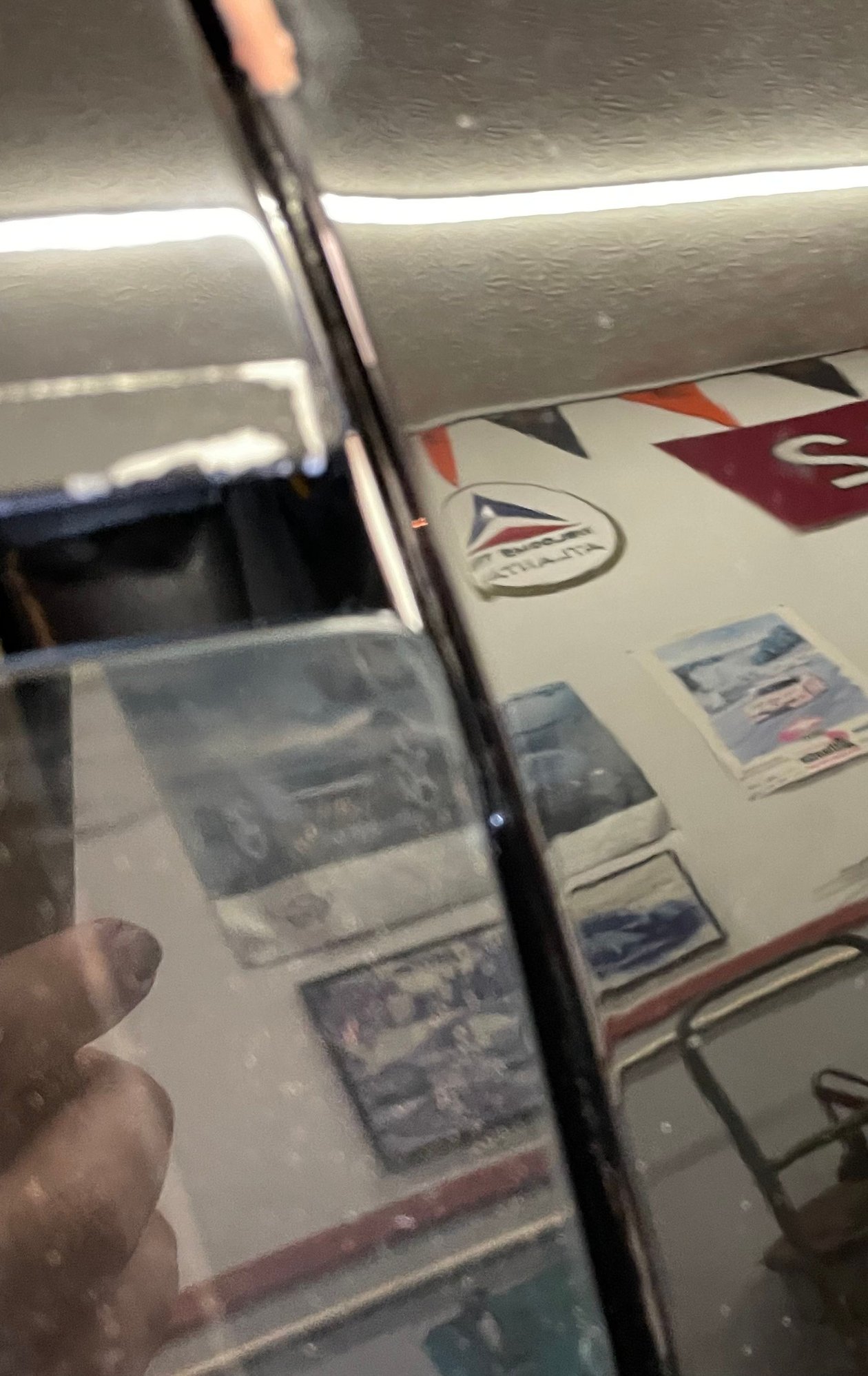

I’ve been having issues with my drivers side power window and in an effort to fix it, I replaced my motor and regulator along with all rollers. I’ve got the glass back in but I can’t get it adjusted right. Currently I think I’ve got the height and tilt right but my window is too close to the T-Top mount B pillar and I can’t open or close the door with the window up.
I tried adjusting it closer to the A pillar but to no avail even with the front vertical track
maxxed to the forward position. I can mess with the tilt and get the rear of the window to barely clear as open and close the door, but then the front edge sits too low and doesn’t seal. Any advice on what to do, it’s driving me crazy?

So I was able to work on it again today and I got it to a place I was ok with (not perfect but it was mostly sealed at the top) but even with everything tightened it seems like the window is still moving. I’ll have it clearing the B pillar when I open and close it, but if I roll it up and down a couple times the window goes back to hitting the side. Im still having trouble with it getting stuck on the weatherstrips going up and stopping short, but I lubed it and it helped. I also tried rolling it up and down with the door open and still saw it eventually move to a hitting the side position.
(It’s barely moving though, it’s going from just clearing by a couple millimeters if that to barely hitting it).
I’m just at a loss of what to do, I don’t get how one side can be so messed up when I’ve added a new motor, regulator, rollers, and weatherstrips, meanwhile my passenger side is absolutely perfect.

So I think I gained some ground today. I got it to a place I liked and it was staying put and while giving me just enough clearance when opening the door. It was however, binding on the A pillar weatherstrip going up, so I took it off and it was then going up all the way. After I did this I unlatched the T-Top but left it on and forgot about it, and the next time I rolled it up it sat great and had plenty of room in the back. I honestly don’t know what happened but it started setting great with the door closed and T-Top latched down, but not so great with the door open. I figured out the forward height stop was a little high so when the door was open it was going a touch higher in the front and tilting. After I lowered and set it, I was seeing that same position in the rear every time and it sits great against the T-Top weatherstrip. So now I lubed the A pillar weatherstrip with silicone lubricant and am gonna set it in tomorrow so that it won’t grab on the way up but still seals and hopefully then it’ll be ready to go cuz right now the seal is great.

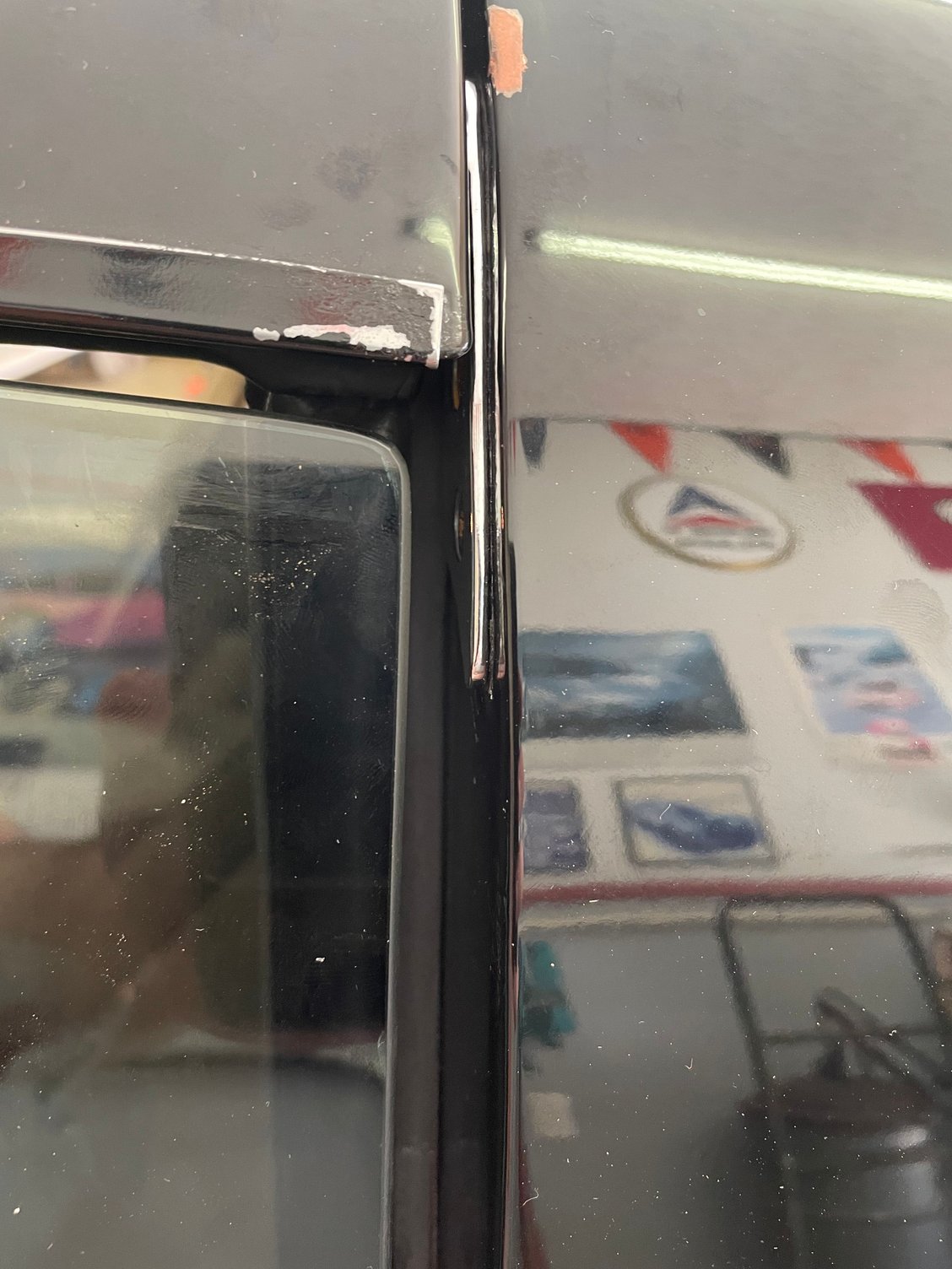

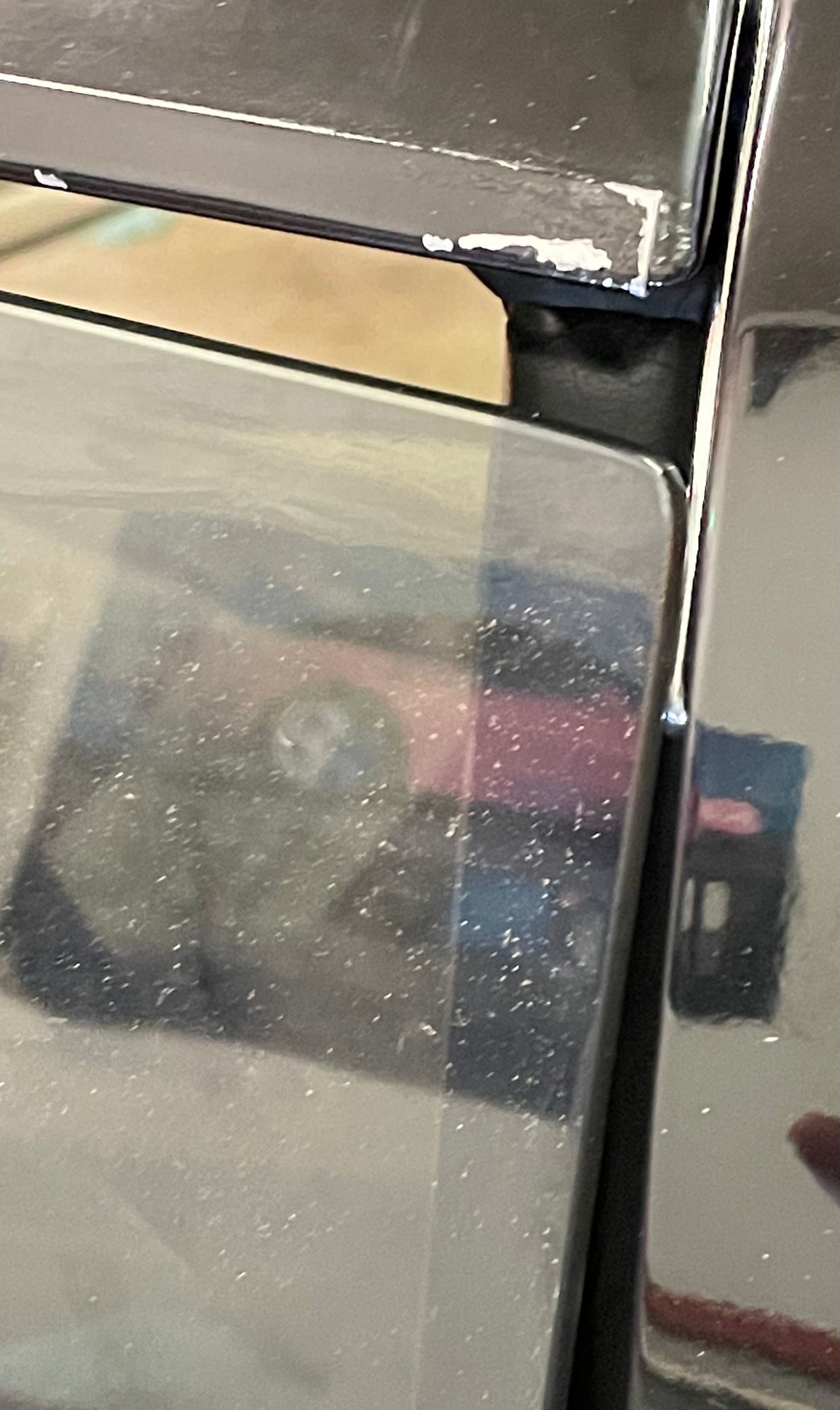

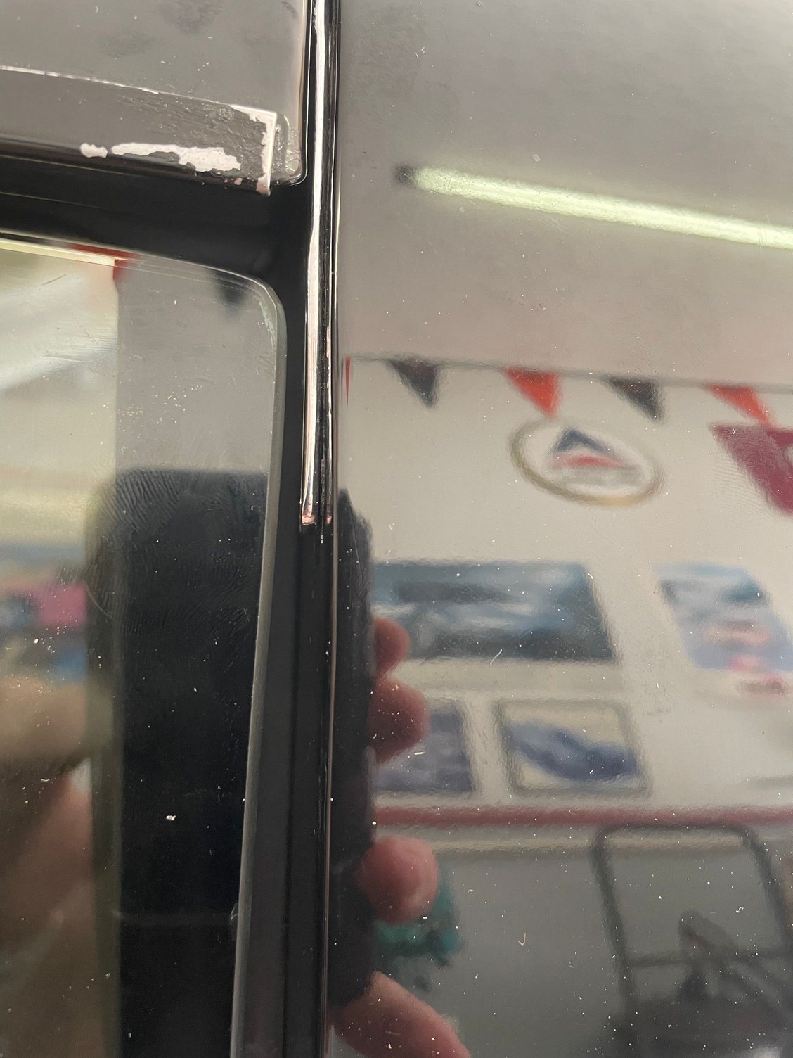

Final height when going up with the door closed
Final height when going up with the door open
Rear clearance when rolled up with the door open
Rear clearance when rolled up with the door closed
