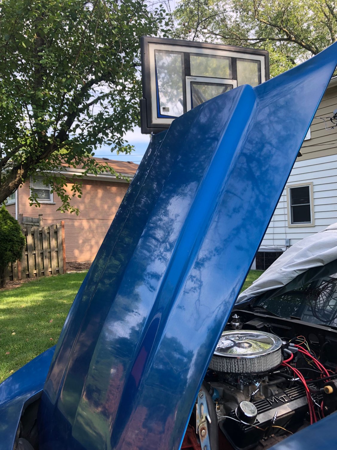

I have a 1973 corvette 350 and all the hoods I’ve seen have a vent/grill near the window and firewall like my brothers 76 has one and other 73s I’ve seen have those vent grill things but my hood doesn’t have one does that mean it’s not the stock hood? It looks like the stock height and stock hood?

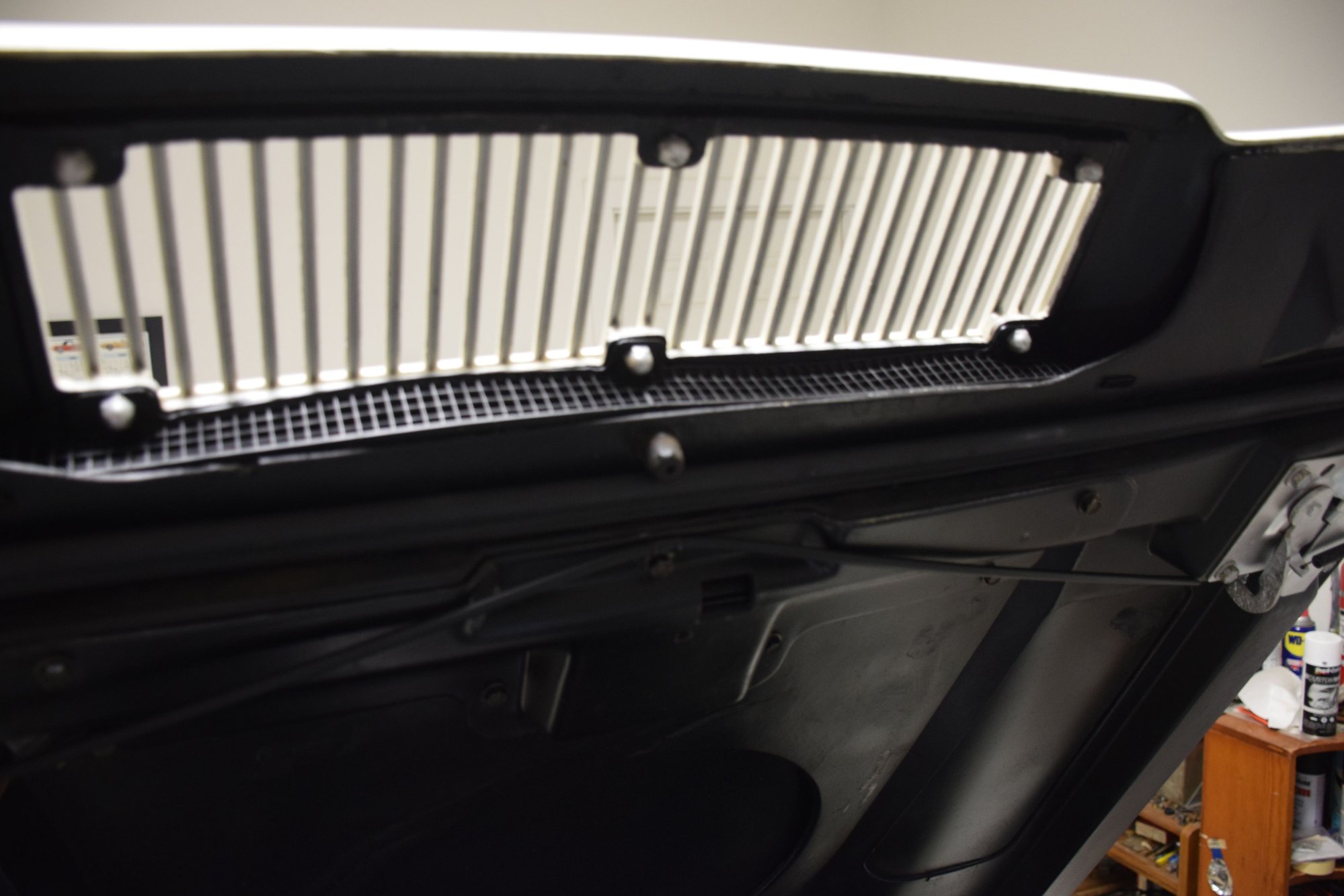

Your 73 hood should look like this:
Donnie

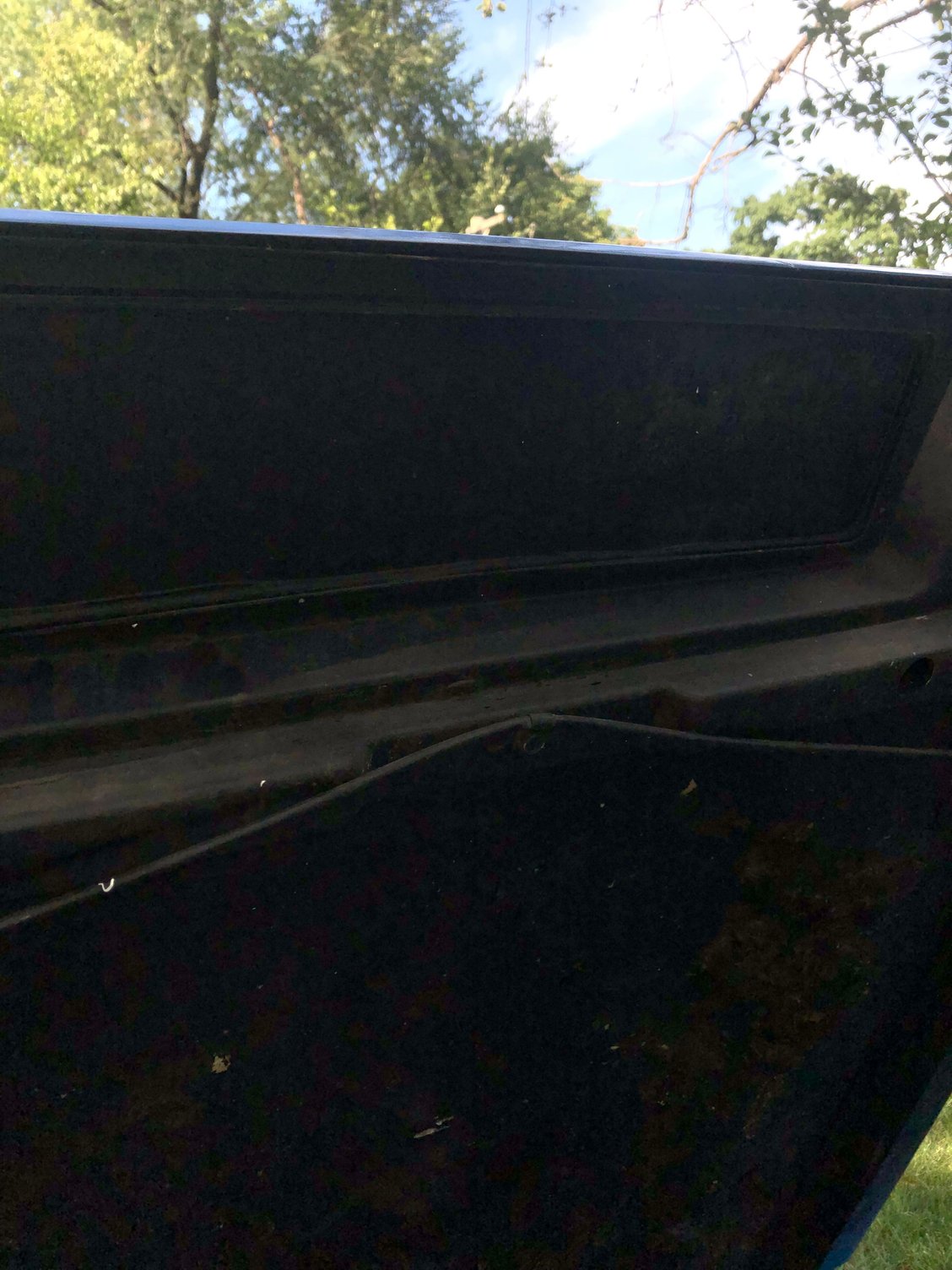

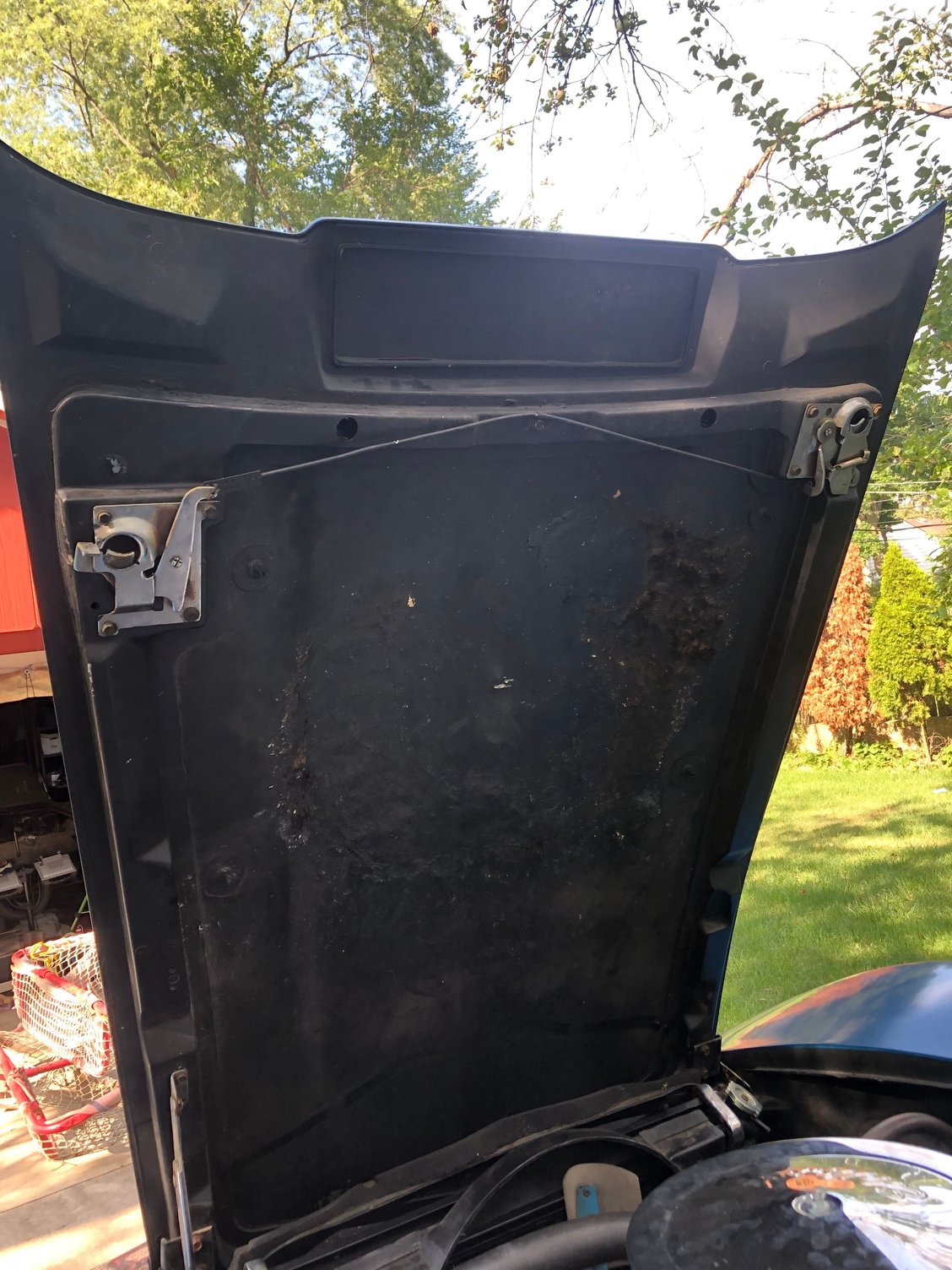

Originally Posted by Mr D.
Or your cowl induction system has been removed, post a picture of that area of your hood.

Looks like you have a '77-'79 hood...

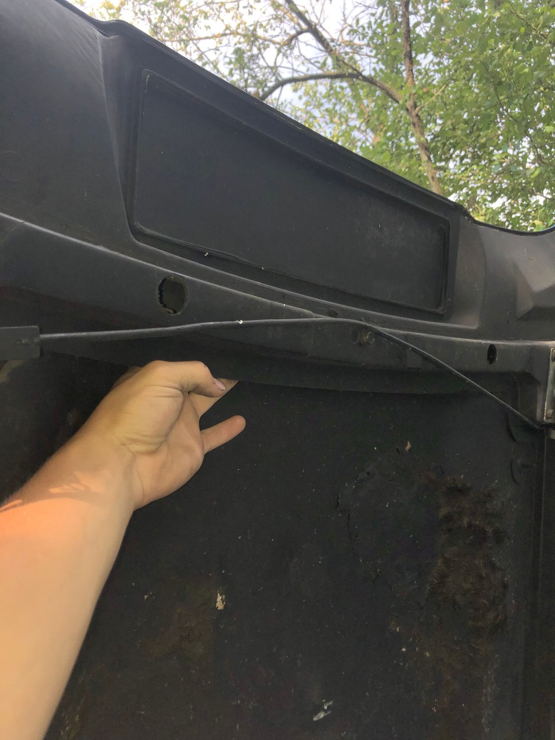

-could I put a 73 vent in that spot that looks like it had a vent

Way less work and cost to just buy the correct hood. They are reasonably priced used.

Any good body shop should be able to match that paint.
It's not just a matter of cutting a simple hole in the hood to install the vent screen. Your hood will be missing the screen indentation (green) and these mounting tabs (yellow), shown in Donnie's pic.
Plus it will be missing all the lower ducting that fits the air cleaner.
It may be easier to just leave it as it is if you're not too concerned with originality.
