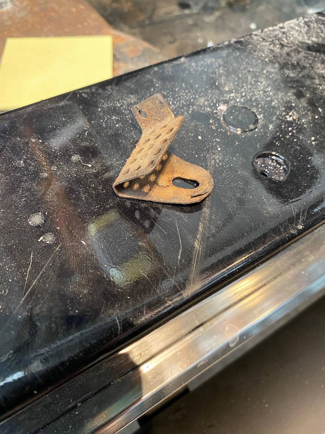

Just got my 1980 C3 back from paint and I have some interior reassembly to do. Found this part in the “stuff” that came back with the car. Any idea where it goes??? Anyone recognize?
I have searched the AIM, but that’s not the easiest route. For all I know it’s perhaps not even from my car.

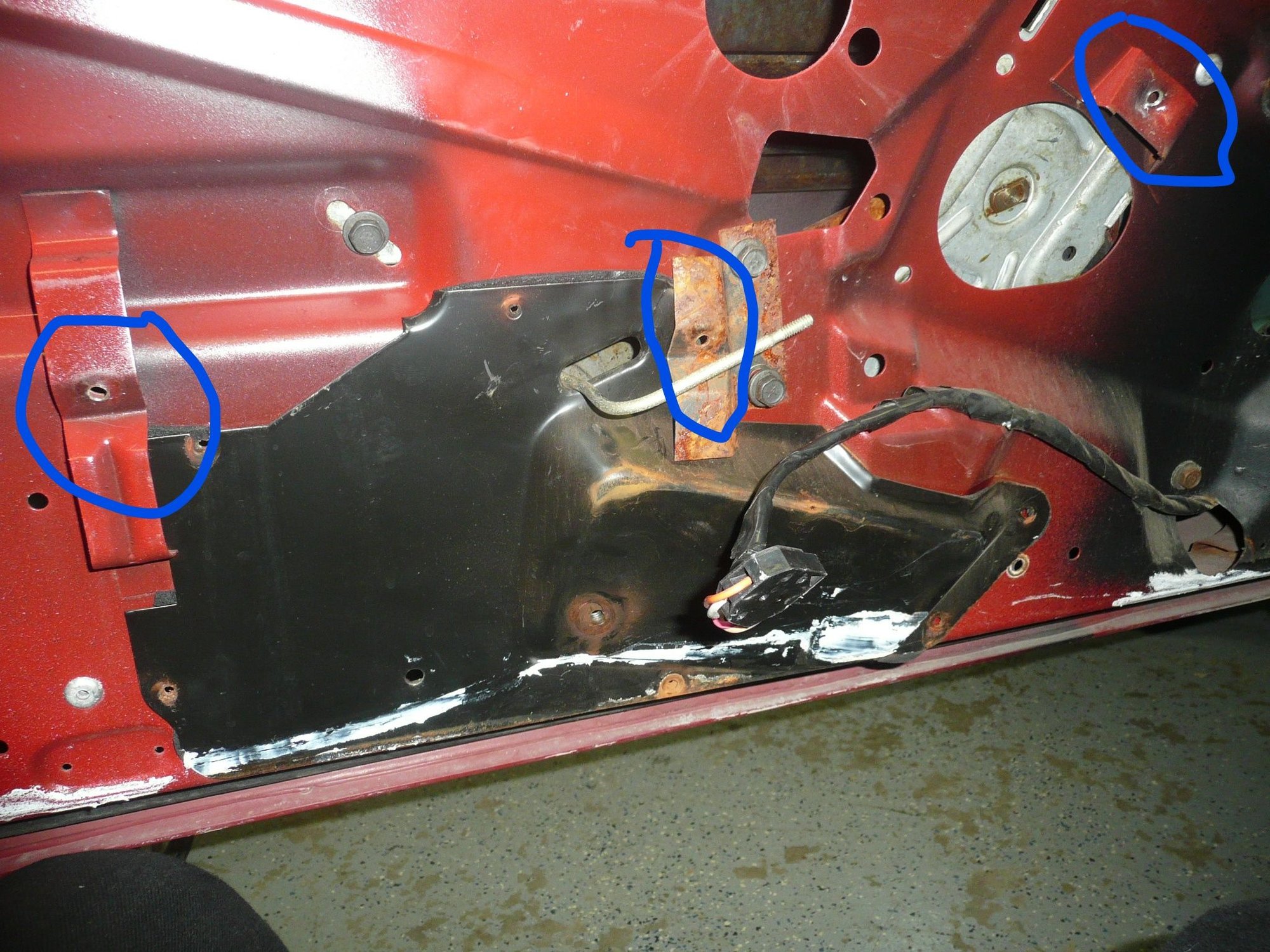

It holds the armrest on. This is the left door. Your part is from the right door.
This shows all 3 screaws.

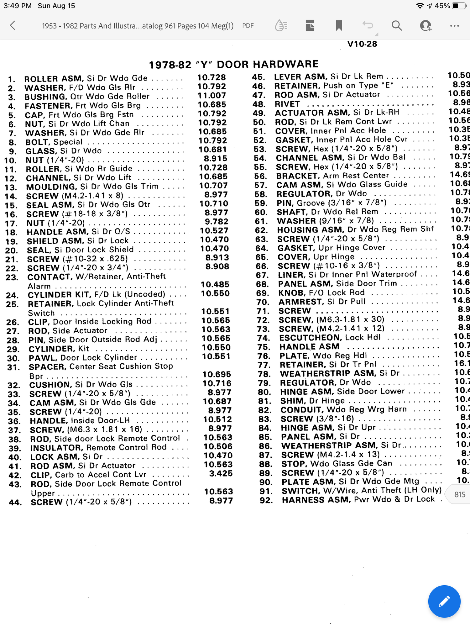

op..add this ..maybe it will help..takes a minute to download pdf
https://www.corvetteforum.com/forums...ette-lonk.html

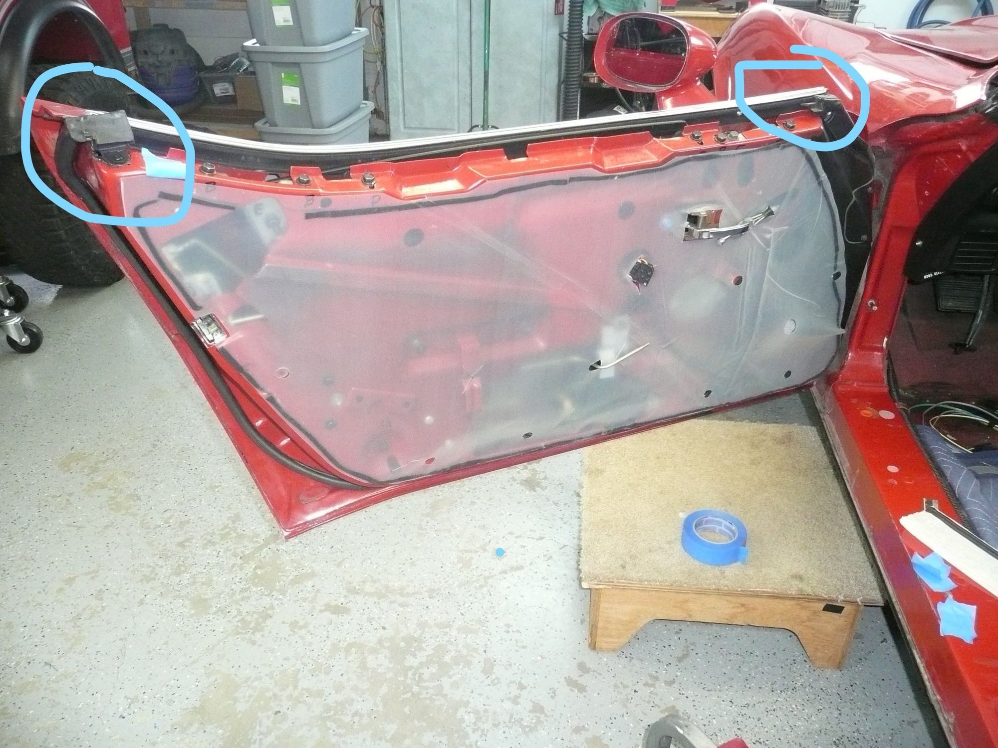

Here’s another. One from each side. Any ideas?
Left over from old windshield post weather stripping?

Either that or one of the ends of the door weather-strip.

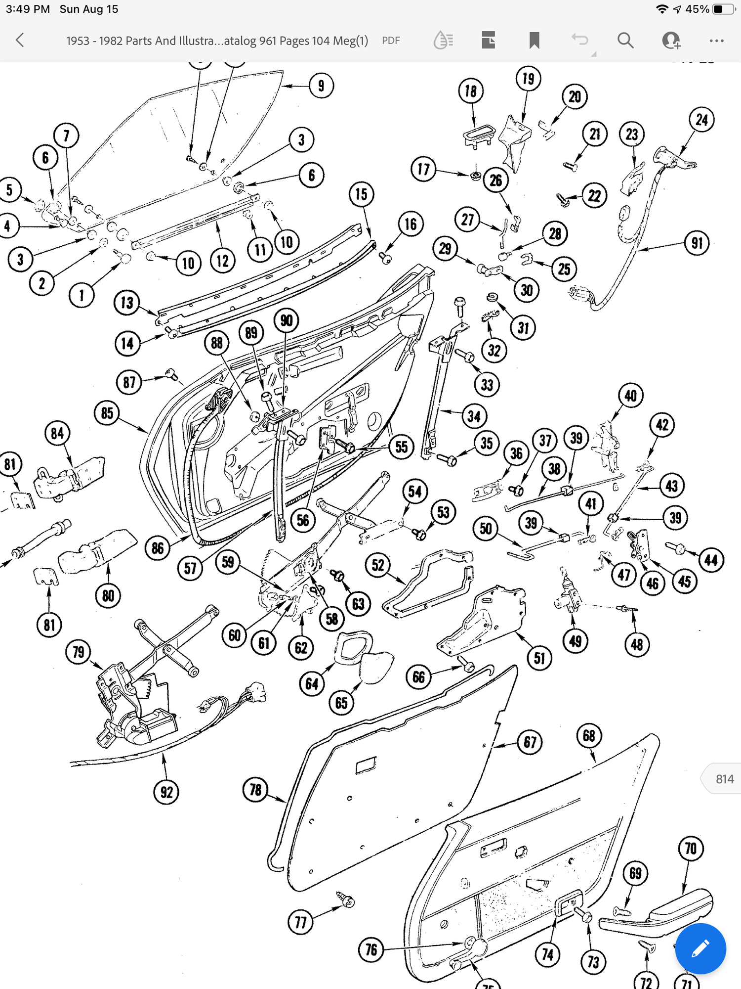

wheres waldo below
Also if you just painted it..no pics?
That would be item #56. What's the prize?
Thanks.
They are just rubbish now , they were in the rubber weatherseal . The new seal will have a similar piece embedded.
