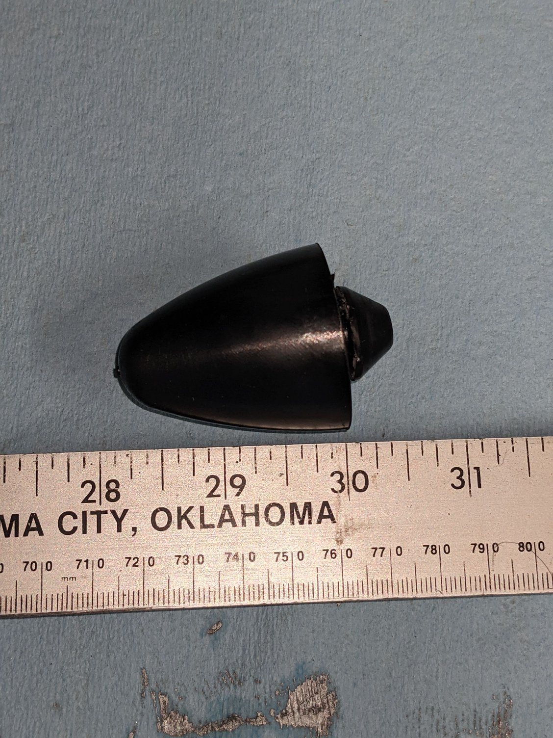

This may seem like a silly question, but how do you get these bushings in?
I have tried pushing, BFH, twisting, grease, Dawn soap, white string etc.
Nothing even seems close to working. !?!?
Plus I just mine today from Paragon (701K) and they seem different from the only clear pic I could find on-line by 4-vettes.(A7199)
Could they have changed? Or are mine just the wrong part? Mine are taller than his. 1.75" vs 1.5"
Could someone measure theirs for me?
My Paragon 701K
4-Vettes A7199

Yep I think that is my problem. This stuff is hard!
And my bum left hand is not helping, I cannot even make a fist.
And most other Corvette Vendors list a different part #
If some of them are softer, I'm Gonna try a new one!
I almost got it once with a screwdriver, but not quite. There has to be an easier way.
So I strongly do not recommend the 701K Paragon part.
I will try the A7199 part from Zip.
It is shorter anyway.

Thanks Mooser. I tried. This thing is so hard it barely flexes at all, even at the lip.

So I did forget to update this for the solution. I ordered the A7199 from Zip (left) and they went right in! No grease needed even. Just one hand and a half twist. The Paragon 701K were just as hard as a rock and would not flex. Tries many times and as many ways, even cut a slot in it.
Another plus...the new ones are only 1-1/2" tall. The old Paragon ones are 1-3/4" tall. Definately not needed. Restricts suspension travel too much.
