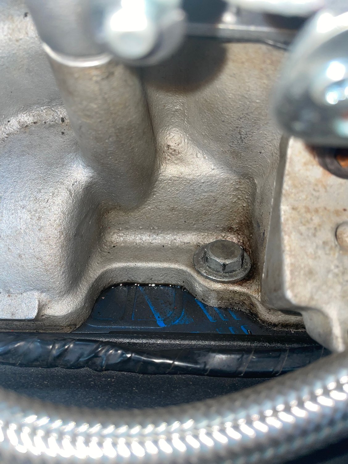

So I put sealer on the bolt threads and it stopped the puddles on my intake but there’s still little bits of oil where the intake bolts to the block just no more puddles on the intake so I don’t get why there’s still a little oil when I sealed all the bolts

Putting sealant ,on the bolts , only sealed the bolts but didn`t seal the intake gasket . It sounds like oil is leaking from the china wall area . If so you will need to R&R intake gasket . A picture will help . I don`t want to give you wrong repair advice

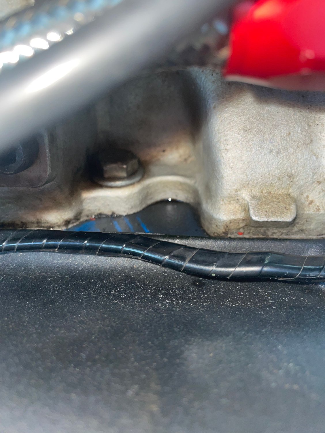

Here’s the picture after the car has been running you can see the puddles are gone because I put sealer on all the bolts but you can still see oil at the block and where the intake meet

H-m-m-m-m-. A little left-over residue from bolts?
But this topic still goes back to:
PCV Valve functioning with great evacuation?
Baffle under the PVC?
PVC grommet?
Now I see wing style V. cover fasteners. You can go ahead and crank those down a little more by hand.
Those poor Intake bolts have rounded corners from abuse.
If everything runs all right, no vacuum loss, then I doubt the Intake gaskets are leaking oil.
