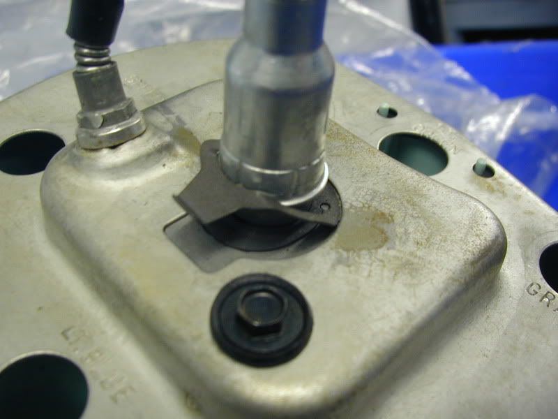

In 1978 you could order cruise but only for an automatic. Not if you were getting a manual transmission that year.
This is what the back of the speedometer looks like if you need to remove the cable. Press on the clip and pull the cable out.. As stated difficult working under there.

I found it easier to loosen the speedo housing from the dash and tip it forward onto the column. Thankfully only had to get in there once, 15 years ago.
Don't mess up that clip, 43 year old clips tend to be brittle.
