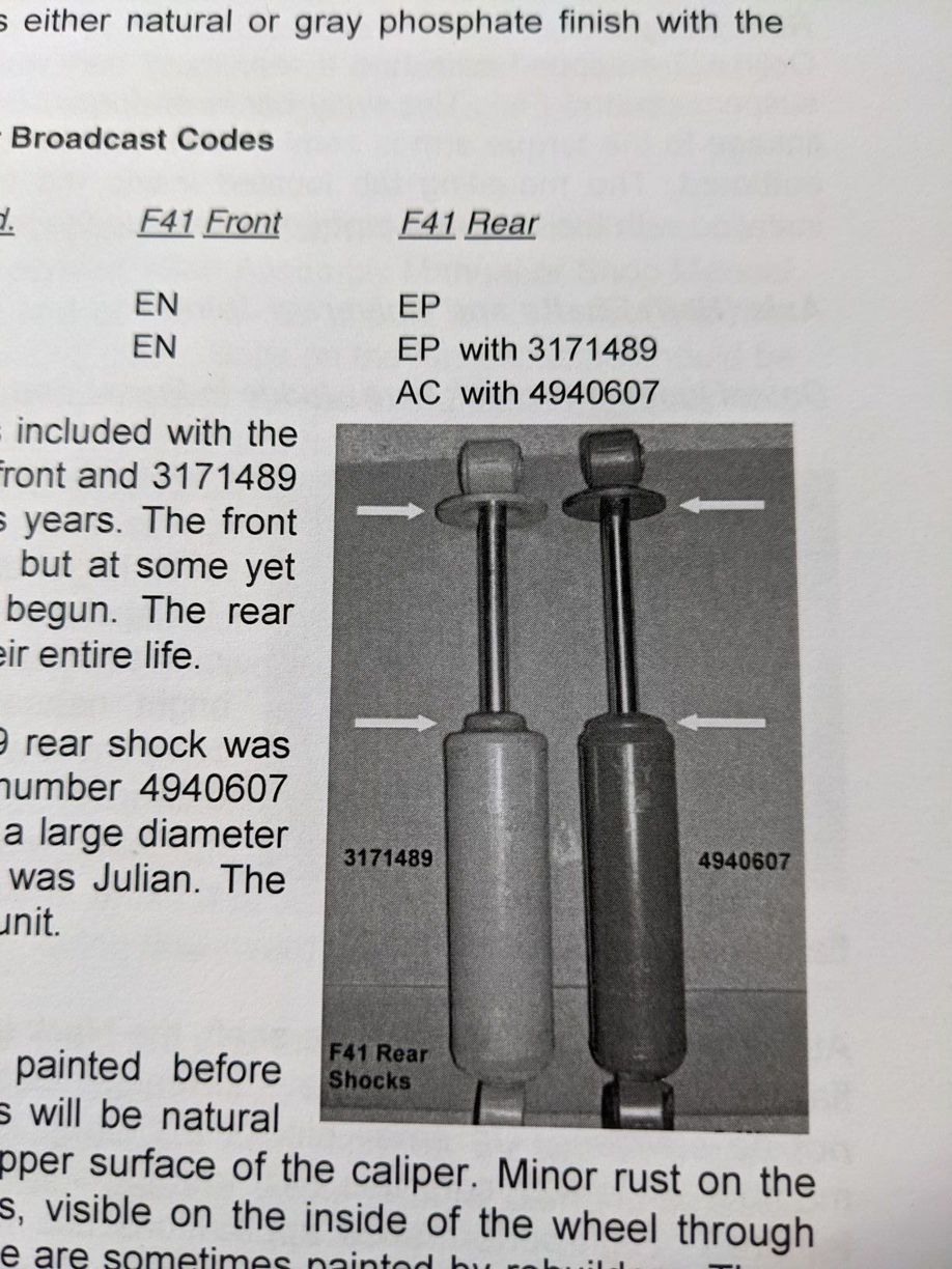

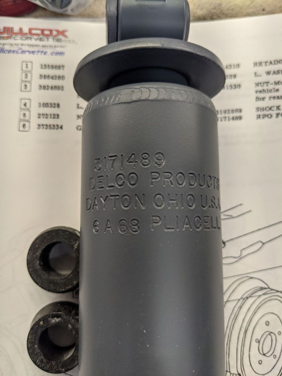

* If the original shocks are still on the car (unlikely, but hey........), the F41 shocks are different than standard shocks - see the pic below for my '68. Also, the front springs are shorter (fewer coils) and more stiff than standard springs. Hope this helps. Best! Paul
'68 F41 shock installed
'68 F41 shock date codes, numbers, etc.

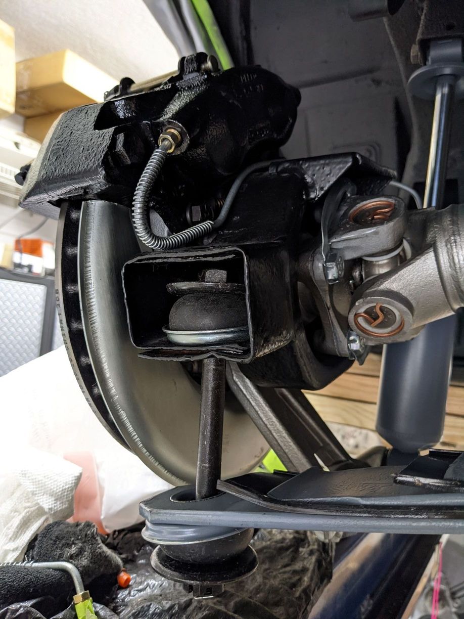

PS: I'm sure you already know about the other hints that the car was originally a 427 car like armor on original rear brake lines (see above pic), caps instead of u-bolts on the half-shaft to diff, your L71 won't have a return fuel line, etc........................
