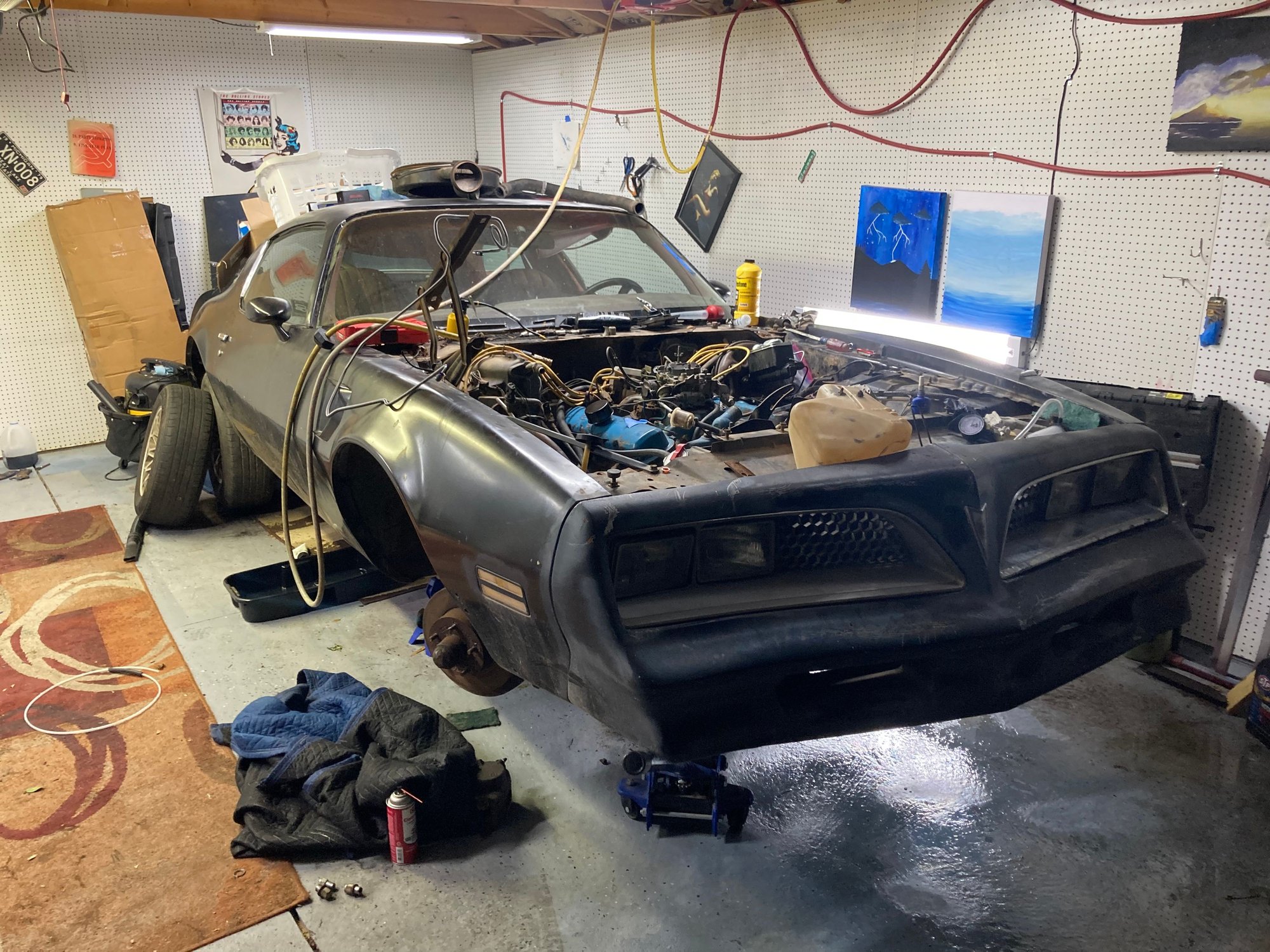

Hello all,
Wonderful forum members who answer many of my questions... I come to you again with a new problem...
I am working on a first time start up of an old 400 engine... (don't ask my why I dare comment about a 400 on a corvette forum, but you guys are wonderful)
Anyhow,
I rented an engine compression tester, put a battery on the thing, changed the oil... took the spark plugs out and got to testing,
Below are my results... in the order I tested them,
4- 95/100
2- 130/135
6- 125/130
8 -110
1 - 100
3 - 95
5 - 65
7 - 150
Welp! not good news right? that is low compression... 100% well, atleast the numbers are all over the place!
anything dumb I should be checking before considering sending her out for a rebuild....
Estimated thoughts on a cost for a "stock" rebuild, I am not crazy about doing anything new / nuts, just want the original engine and to have an original engine running well...
Should I consider starting the thing anyhow? Could me not allowing any warm up.... be hurting me here? I think not, but...?
Best,
Kevin

I like sbc 400s ... have had & do have a few. But that one in pic don't look like chevy ... is it pontiac?
Costs ...Can you disassemble-reassemble DIY?
What's your 400 in?
What's your 400 in?
its a pontiac 400.... I can't say what it's in haha, or I'll be told to go to a pontiac forum ...(Trash)...
What I'll be doing tonight is adding the mystery oil and letting it sit over the weekend. I am waiting on a few parts to start the car anyhow....
Then, well then I guess I'll see if I can get her started and report back with new compression numbers!
Best,
Kevin
