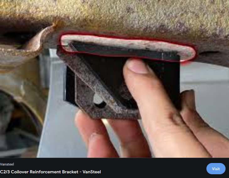

Thanks, for that information. Question is Van Steel require any welding or modification to the frame. Reason is i just got it back from Powder coating.

They recommend welding the top shock bracket to the frame- it is not required though.
