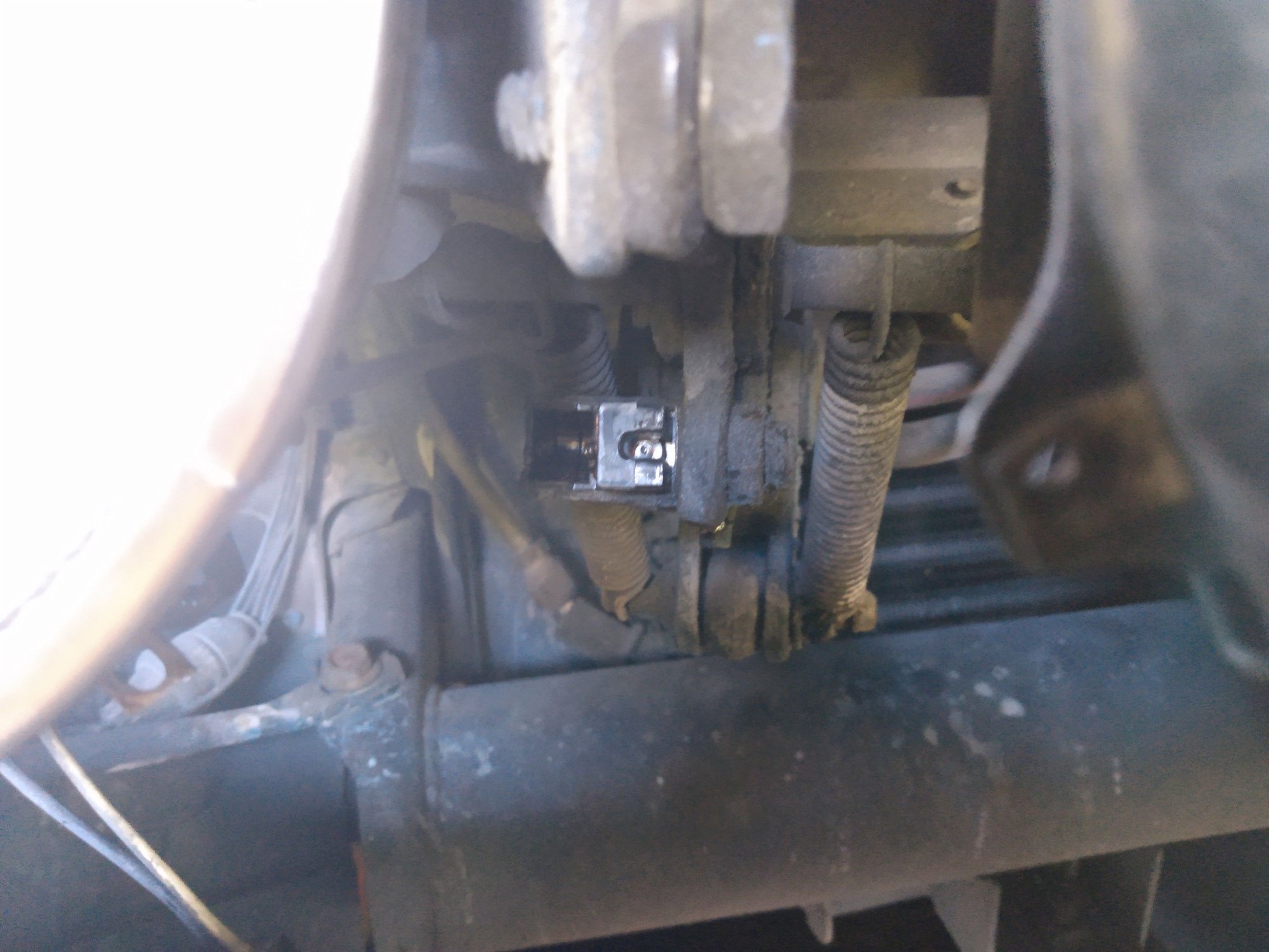

Having an issue with low beam pass headlight not working. Trying to trace out problems, and found a connecter in the wiring harness broken. There are two wires (Black and Green) that come off the outside (high/low beam) plug that the bulb attaches to. They go to what appears to be a switch on the headlight door mechanism (see pictures). That switch appears to be broken, as one of the locking tabs is broke off, and the connection is loose. I am guessing this is a switch to signal the lights are in the up position??

yes the switch tells it when the headlight is down, only to show you a warning light not to make the bulb work (thats how it is on my 69)
so my advice is its usually a 99% ground issue....the other 1% is your bulb is burned out...

Switch / swap the bulbs to the other side to see if its burned out or not...

First wiggle the plug on the bulb.
