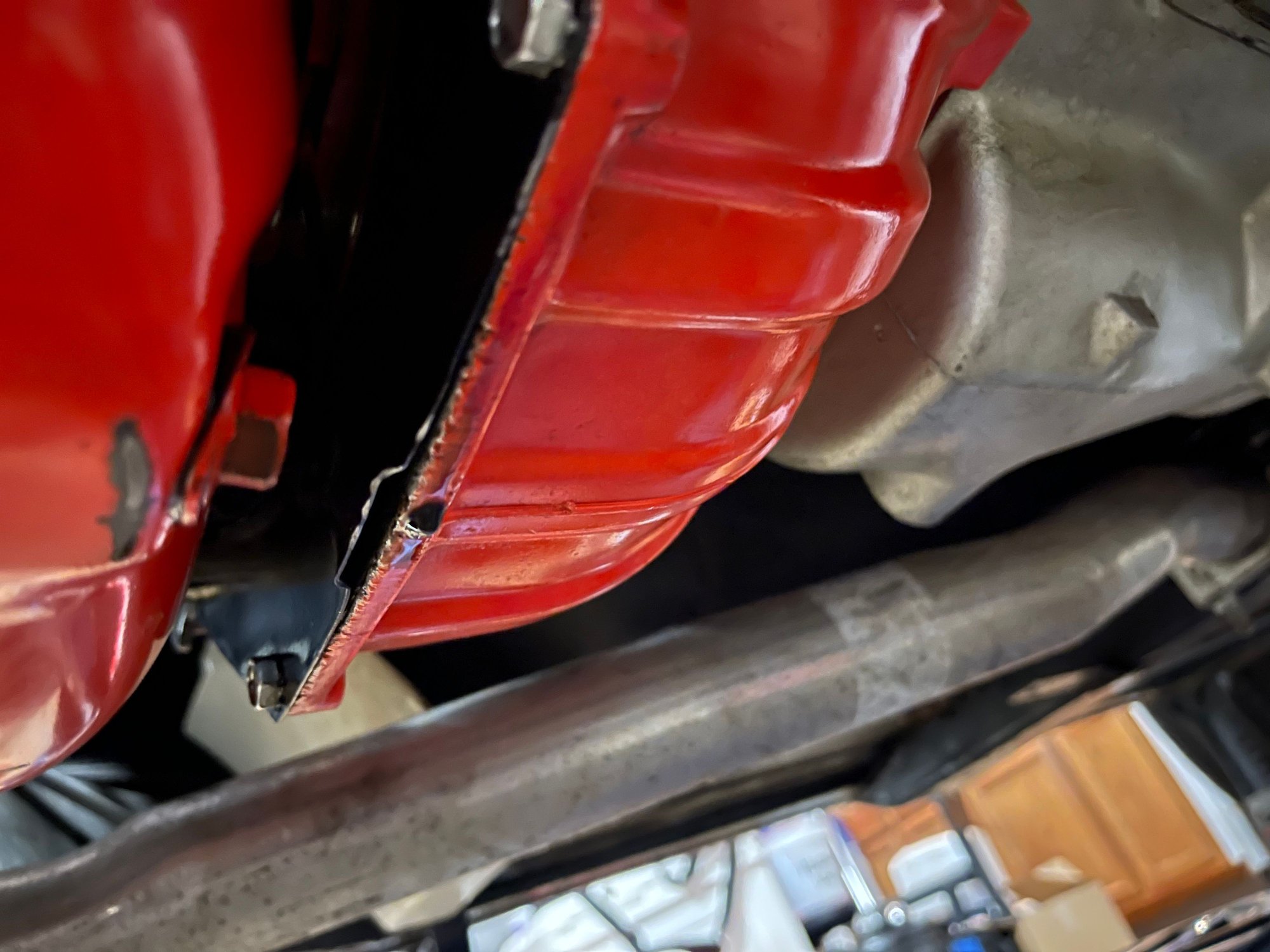

I have been chasing an oil leak and can not figure out where it’s coming from. I find oil coming off the bell housing flex plate but once the flex plate was removed the fly wheel was dry as a bone, no oil on it. There seemed to have been a minute amount of oil sitting inside the starter gear area. I did end up replacing the rear main seal and the oil pan gasket. (Installed correct direction, with a sealer on the cap and torqued correct,
so on and so forth) the leak from prior to doing the rear main seal and oil pan gasket is the exact same as after.
Upon doing the rear main seal and installing the oil pan gasket there is fresh oil in the engine with zinc additive and then small oil spot on the floor is dark oil no consistent with the oil in the engine currently. This whole thing has me scratching my head.
The car is a 4 speed.

Does the dark oil SMELL like oil or does it smell like manual transmission fluid????

I’m thinking it could be trans now that I look as stuff more. It’s as if the oil was sitting inside the bellhousing walls mostly bottom then running out.
im going to pop the fill plug and see how much fluid is in it.

The noise sounds like something in the pan/crank, hard to tell from a video. If the leak is engine oil it sure looks like the rear main but it is also dark so...trans? FWIW, I get a drop of engine oil on the right side of my automatic trans pan every once in awhile...Definately engine oil. Turns out the oil pressure sending unit on the left side of the distributor weeps a little oil that seeps down the left side of the bell housing past the filter, along the lower edge of the bell housing to the left side lip of the trans pan, It then works it's way across the front lip to the right side and then to the back where it drips a drop here and there. My point is sometimes anything is possible with leaks...a good strong light helps and if every thing looks dry spray Arid Extra Dry where you suspect, the white power turns dark real quick with oil...(Old Harley trick)... Hope it's not the seal again but since you probably need to drop the pan check it real good...
Do you have oil pressure? Just asking incase it is a pick up issue...
