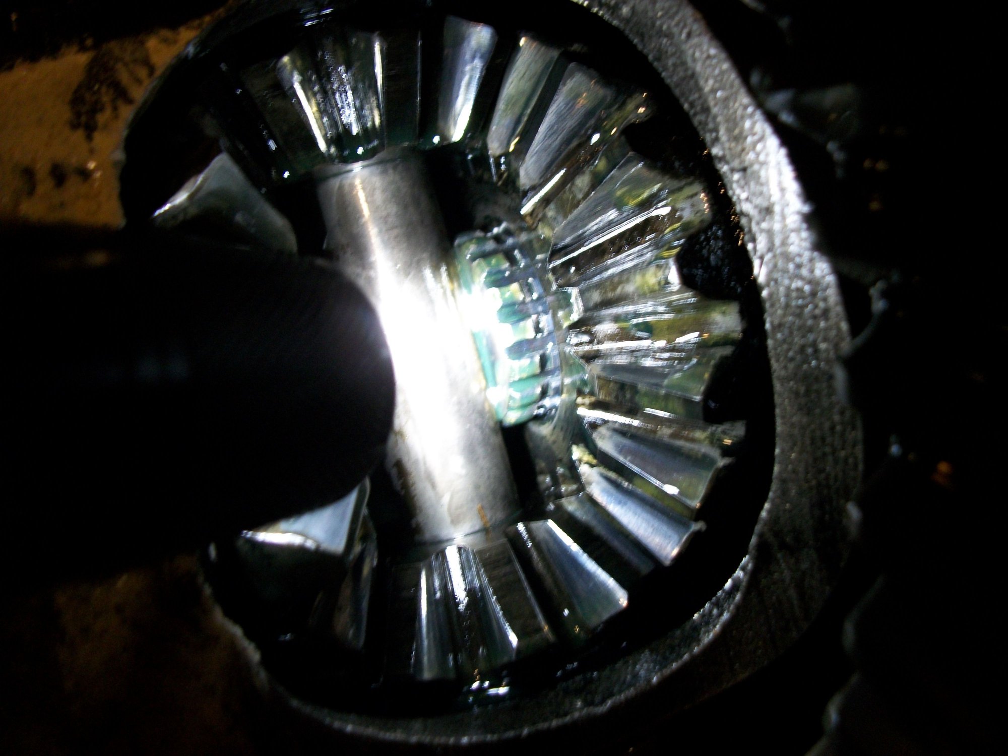

Check these....there are two of them....sometimes they become bent/out-of-round and the fall out of the splined shaft grooves .........
Snap ring is still in place where it should be.....
The other Snap ring has been damaged and has fallen out of it's groove......
I found the damage Snap ring before it could do serious damage to the internal gears.......
The grooves in the splined shafts were not machined deep enough by GM (probably a dull cutting tool) according to the Machinist's Handbook......I did not have access to a metal lathe so I took my time using a diamond dremel wheel to deepen the grooves in both shafts. You can see how the Snap ring barely fits into its groove.......
A Machine Shop could have done the modification in about 15 minutes.
