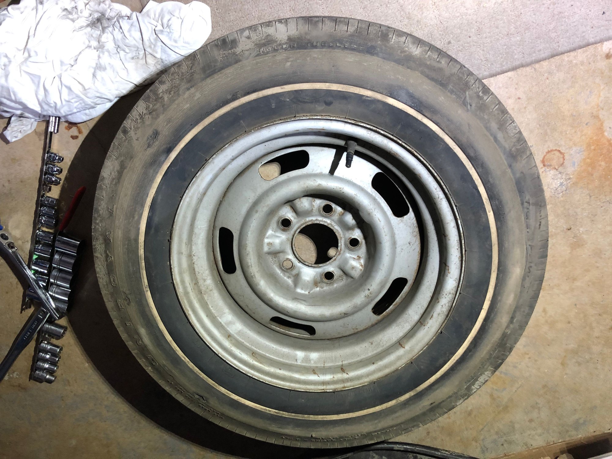

Took possession of my 1968 in January and finally got around to dropping the spare to check it out. It's a Uniroyal F70-15 TigerPaw and appears to match the description above. I'm trying to confirm the date of mfr to see if it's original. I found JM390V...is this the date code (39th week of 1970)? or is there another series of numbers I need to find? I'm not restoring to orig or for NCRS, but I love learning the real history of my cars and this is just one of the puzzle pieces.

That's an original old Tiger Paw i recognize the sidewall, What is the date stamped on the rim by the valve stem

On the rim? The stamped characters on either side of the valve stem are: K18 7 11 AC (stem itself located between the 7 and the 11)
Any idea how to confirm if the tire itself is the car's original?

July 11 1968 rim date
Two letter code is AG 1968 only wheel
