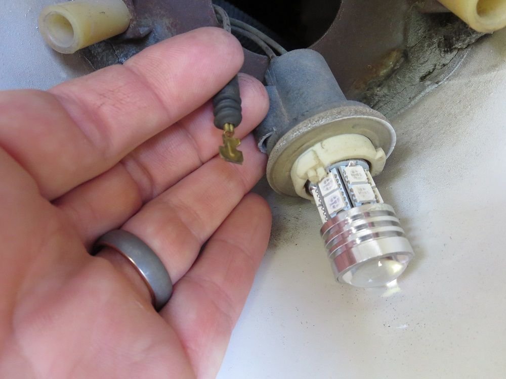

Check the grounds. The right side circuit is grounding through the filaments of the left side bulbs. LEDs are fine in the rear of the car.
I found this inside one of the sockets in my 80. The ground connector had failed inside the socket, and caused issues similar to what you see.
