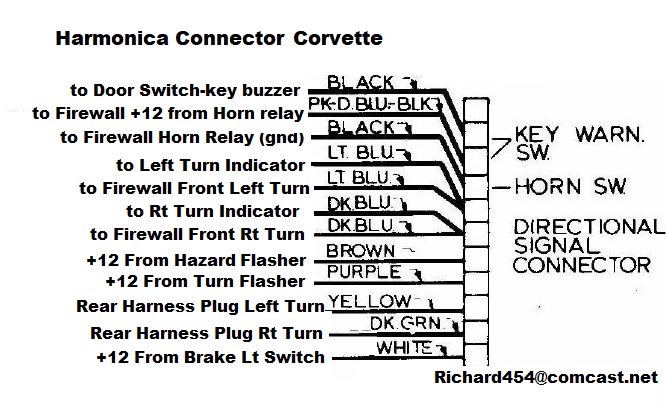

And here's a diagram of the harmonica that might help diagnosing-
To Chasing stop turn kight gremlins.
