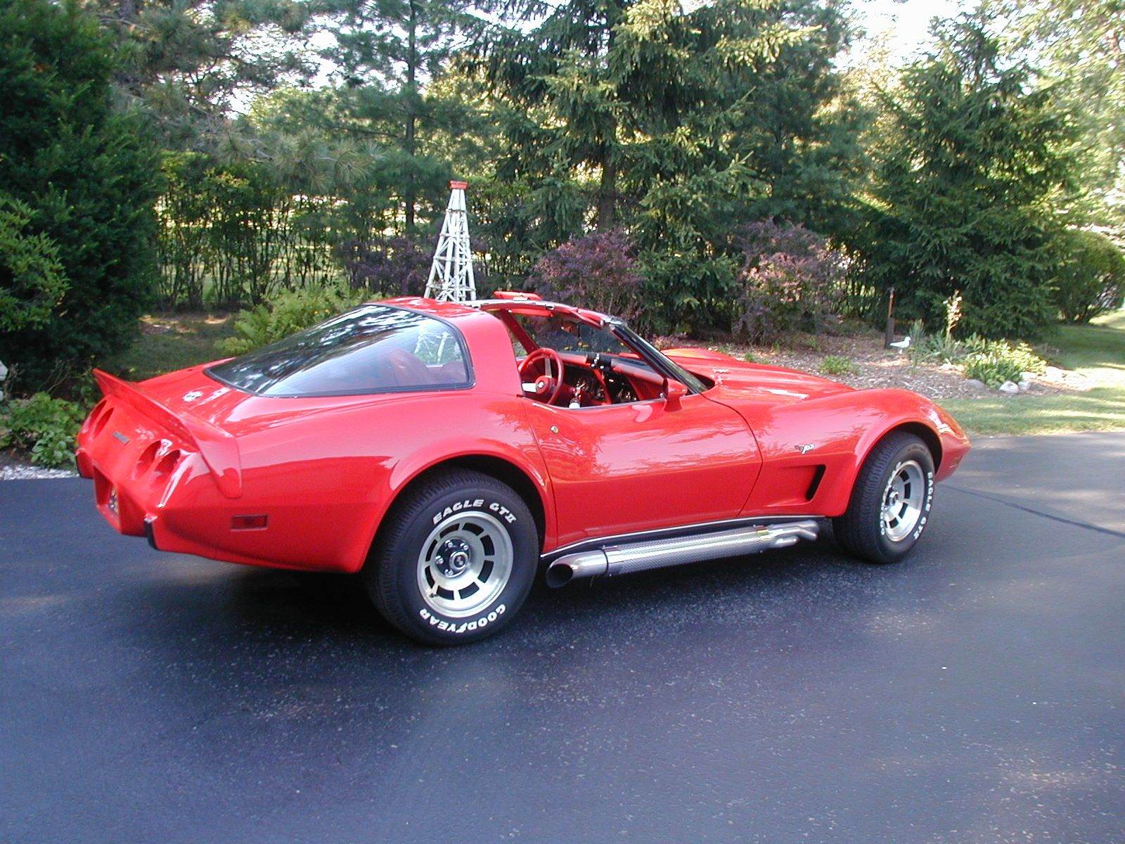

I installed the Hookers on my 78'. I guess I was lucky, everything fit with no mods. I didn't have to cut the rocker panel either. I loved them, had to install heat shields because the wife got "branded" on her leg while exiting once. They get HOT.

Yep, the heat shields would be a must. I actually like the look of them with the STINGRAY embossed in them.

That is really nice looking. The car is not too bad either.
Hey Duke, sorry to revive an older thread but those look great. Did they fit with a Borgeson steering box installed? I have the rams horn with the original side pipes but they are looking rough and want to open up my 355ci. The hookers with side pipes seem to be my best option for fitment and performance. Thanks!
