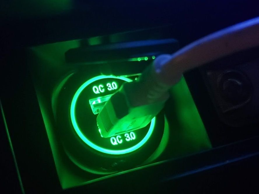

Do you smoke in your C3? I used this charger. The green glow complements the gauges, and it has a capacitive on/off switch. I enlarged the hole in my center console panel (plastic in 80) with a stepped drill bit. I used the stock 12V input and ground wires (and clipped off the ground ring).
Other issues, did you check all of the fuses? You might want to take them out, clean the ends, and stick them back in. Sometimes a bit of corrosion is all they need.

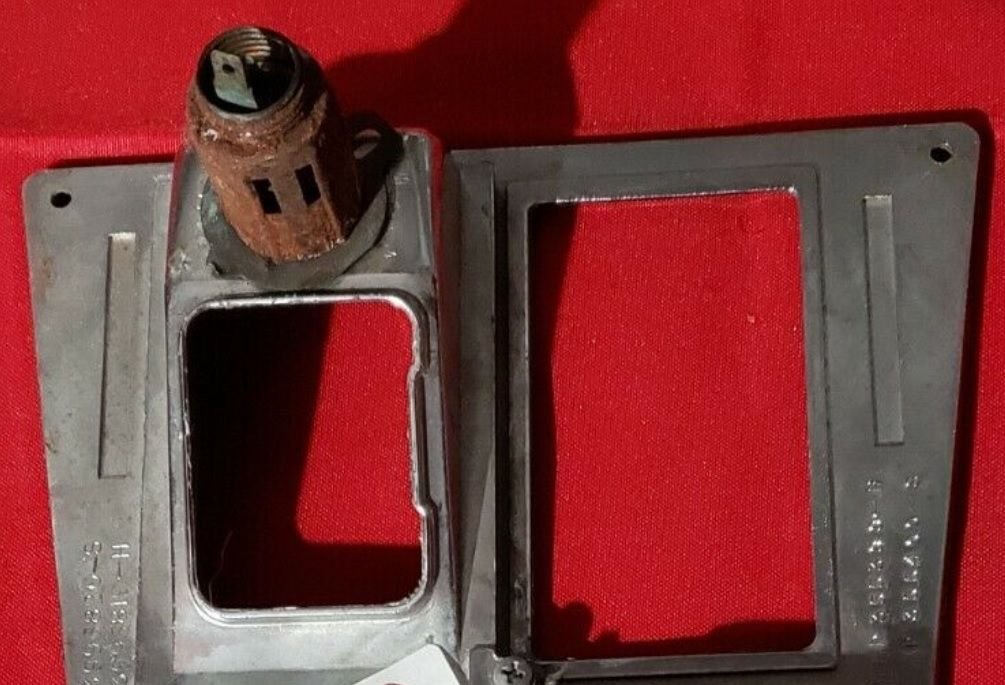

Does it not look like this (found on eBay). Other than having to enlarge a hole in pot metal vs. plastic, it would seem that it should work the same. It's even a reproduced part, so you don't have to cut up your original to experiment.
https://www.zip-corvette.com/68-76-a...y-housing.html
But if it is a ground issue, I'd start by cleaning that ground ring, and checking continuity. It may fix your center console lights, too.
