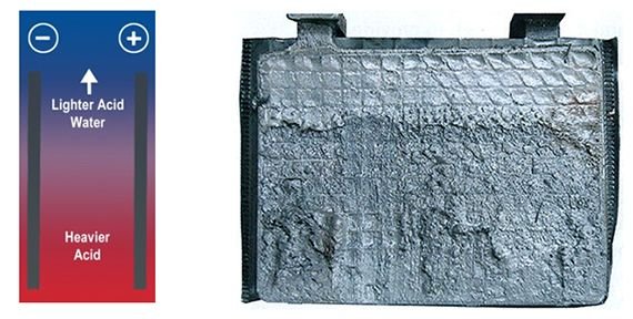

I doubt this is your issue, OP, but a good reminder for all forum members who's cars may sit a period between being driven much : It doesn't hurt to every once in a while rock the battery back and fourth many times (vigorously) to mix the electrolyte, esp before charging, or periodically if it's sitting with a maintainer charger. This will help reduce stratification of the electrolyte and water, and add life to your battery. For this reason I don't bolt down the lead-acid batteries on cars I seldom drive. Makes it easier to rock back/fourth (vigorously). Note: AGM batteries shouldn't stratify like this.
Also a heavily stratified L/A battery can mimic a weak battery. Just a reminder....
