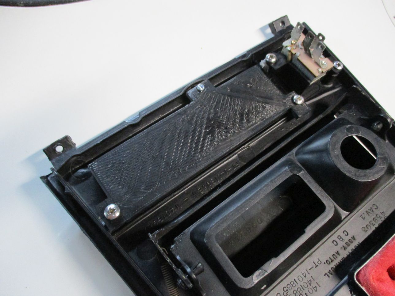

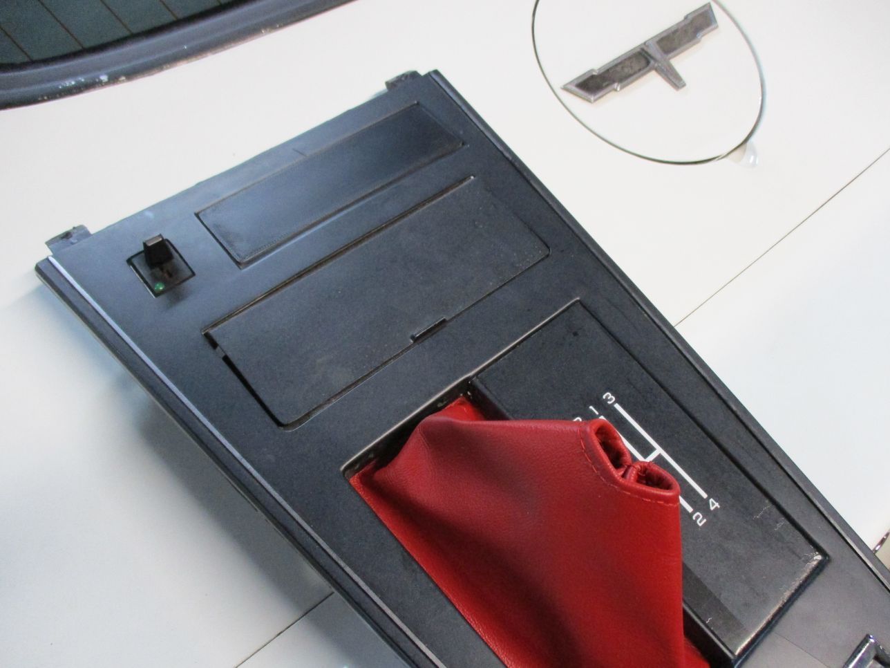

In 78, the center console is a commonly reproduced and replaced part, so easy to modify. I 3D printed a plug for my HVAC controls, intending to have the heat controlled from where the radio is (using an Arduino, so no cables or vacuum hoses required). Other systems, like Vintage Air, also do away with vacuum hoses and cables, their head unit is just a few switches to control their system. Maybe the stock system could be moved, or you could replace vacuum and cable actuated throws with servos. The Vintage Air controller is shown below (which is made to work with their AC replacement system).
Take a look at the depth. You may be able to fit a shallow 2-DIN unit there. I don't know if you will be happy with the viewing angle. To get access to the panels, I remove the seats (4-bolts each), and the side skirts (3 screws each), then it should be pretty clear how to remove it. You'd need to relocate the defroster switch, if you have one. And please do pick up an Assembly Manual and Shop Manual specific to your year, before you dive too deep.
Here's are photos of my modified center console, if it helps.

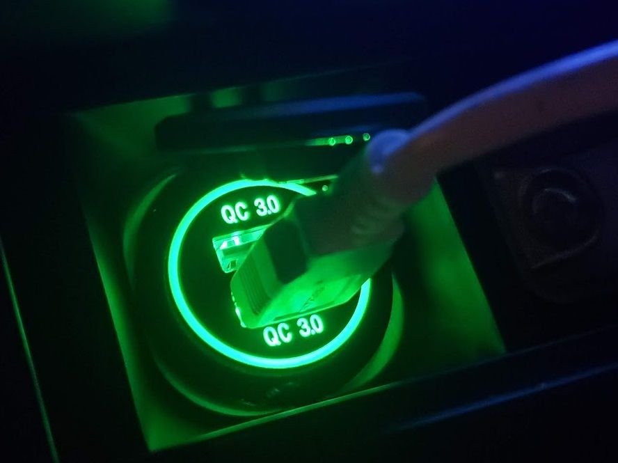

I woudn't want to do away with my charger, though. I enlarged the hole for the cigarette lighter to install this, which fits below the cover when cables are removed.
