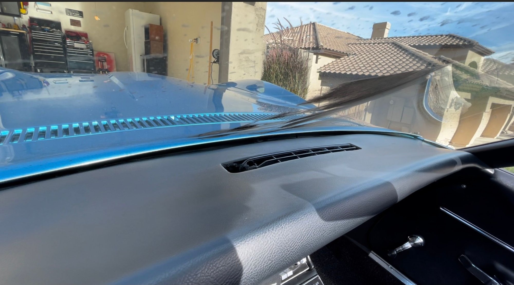

I just decided to take the C3 for a ride and after a couple of minutes had smoke coming from the defroster vents and immediately turned for home. Before getting home there were flames coming from the defroster vents, so I ran for the hose in front of the house and sprayed into the windshield and vents, etc. I believe the flames are all out (no smoke, etc.), but the car is still in the driveway, do not want to pull it into the garage and/or start it.
Does anyone know of a shop in Phoenix,
preferably in the Chandler area, that I could trust to repair the damage? All that can be seen from the outside is the corner of the defroster vent were it melted. Any help would be appreciated. Thanks

Make sure you've disconnected the battery, whatever was causing that issue was electrical (ok, possible the oil-pressure line leaked onto something electrical but still an electrical issue in there somewhere)

I would have to agree with above, the most likely think I can think of is oil leak off the oil pressure gauge ran down onto the ammeter which is spun with very thin magnet wire and it ignited.

In the mean time..remove vent start taking pictures with flash best you can or cheap borescope…
regardless of where you take it..being empowered with root cause will help communicate and or not get ripped off…
also what diy skills?
got AAA? Or a friend who does? Bunch of friends? Remove battery cables for now and push drag pull into garage..

Looks like a 68 to me. I would, at the very least, open the hood a see where the fire started. It could be as simple as a grounded wire to the coil on the shielding. Pictures would be helpful. Good luck. Jerry

I'm going to go with a shorted wiper switch or wiring at that location. An oil fire would be waaay dirtier on the windshield, IMO. Also, I can't see a wiper motor fire crossing into the interior like that. The upper dash needs to come off before pulling other stuff apart to look down in there to see what's crusty.
