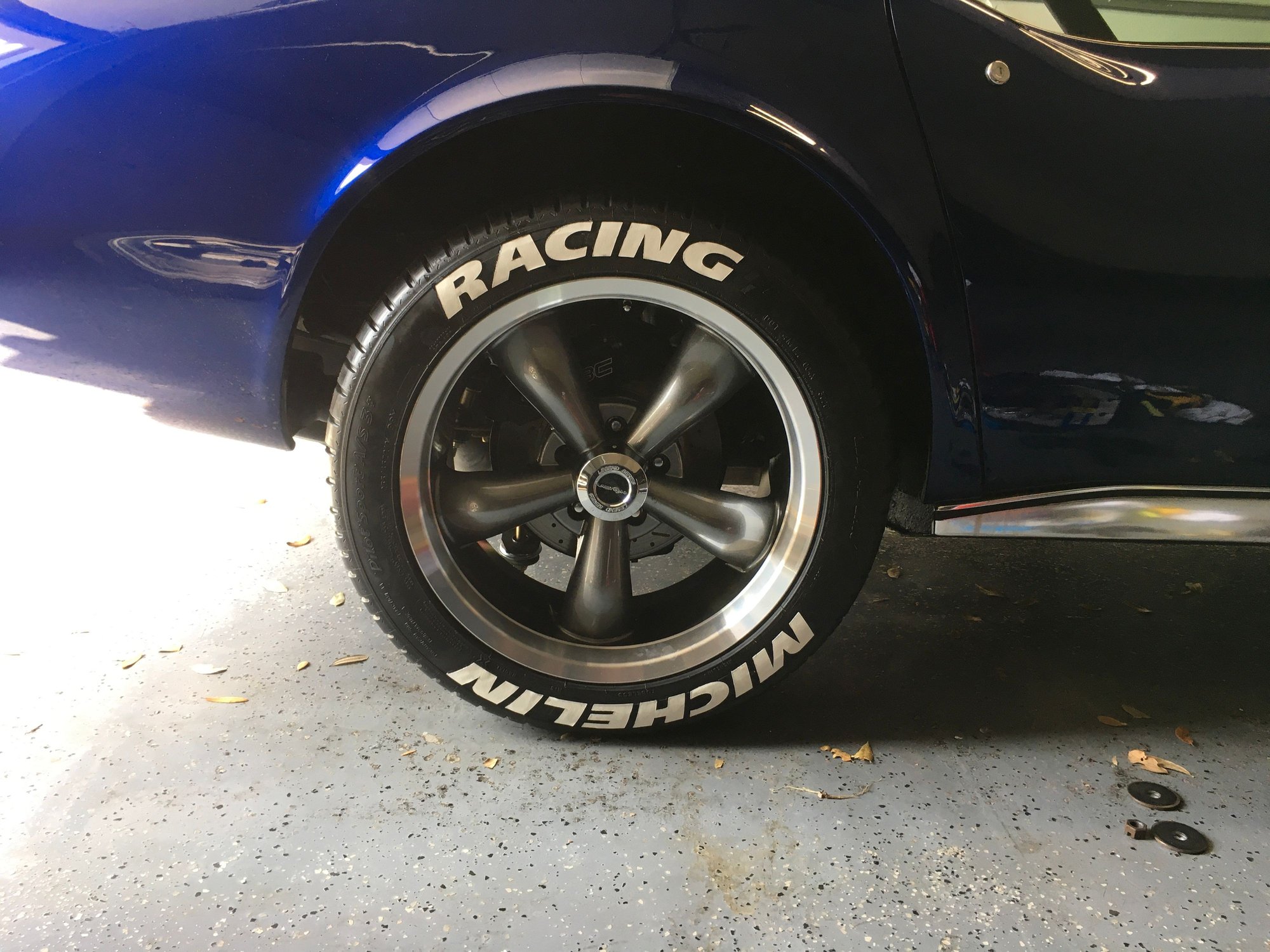

Frankly, once you get this spring installed, I doubt you will be happy with the ride height. My replacement 9 leaf was ridiculously high and never settled over time, giving my car a 4x4 look. I went through several before the Vansteel composite was finally available and I installed it with 8” bolts and it is perfect. Check out the arch on these springs:
From top to bottom: TRW 330#, Hyperco (Ridetech) 300#, Eaton stock replacement 9-leaf.
With stock TA spring bolts the ride height was ridiculous with all three of these springs. I ended up with 8” bolts and the Vansteel 340# rear composite and QA1 coilovers up front to achieve an acceptable ride height.

The arch of the unsprung spring has nothing to do with the end result. The 9 leaf steel spring is progressive. The composite springs, not so much. I do agree the 9 leaf spring can cause the ride height to be to high, longer end bolts solved it for me. When all is said and done the movement of the trailing arm is about 2 inches before they contact the rubber snubbers. You have two inches of travel to change or improve the ride of your C3.
Also be very careful the front two spring hold down bolts are the correct length. To short and they won't have enough threads to hold, to long and you will destroy your rear end.
